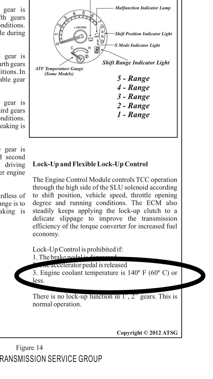

    Well, I guess this truck is not immune to any of the problems that others are facing, and maybe one or two additional problems just to kick me in the nuts.
    Boost barely rises to 5psi and then slowly drops.
    Transmission hangs in 4th before revving into 5th. Sometimes I have to shift out of D into 4 and back for the gears to change.
    And now I have two blown shocks.
    loginfailed and ls1 prerunner like this.

    1. Yessir, researching belts as we speak.
    2. It does this whenever the truck is cold before it warms up to operating temperature. It's more pronounced when the ambient temperature is cold as well, but I have a suspicion that the transmission is low on fluid.
    3. I do I do. Not a planned expense though, so poop.
    Yessir, when it finally shifts. I have no doubt that upgrading the valve body will help, but at the moment I'm going to check the transmission fluid volume before I go that route.
    Then again, if I just upgrade the valve body now, I'll take care of two birds with one stone.

    Torque converter will not lock until coolant temp is (I think) 140F so that is normal operation.

    The trans will do that if it’s not warmed up enough.
