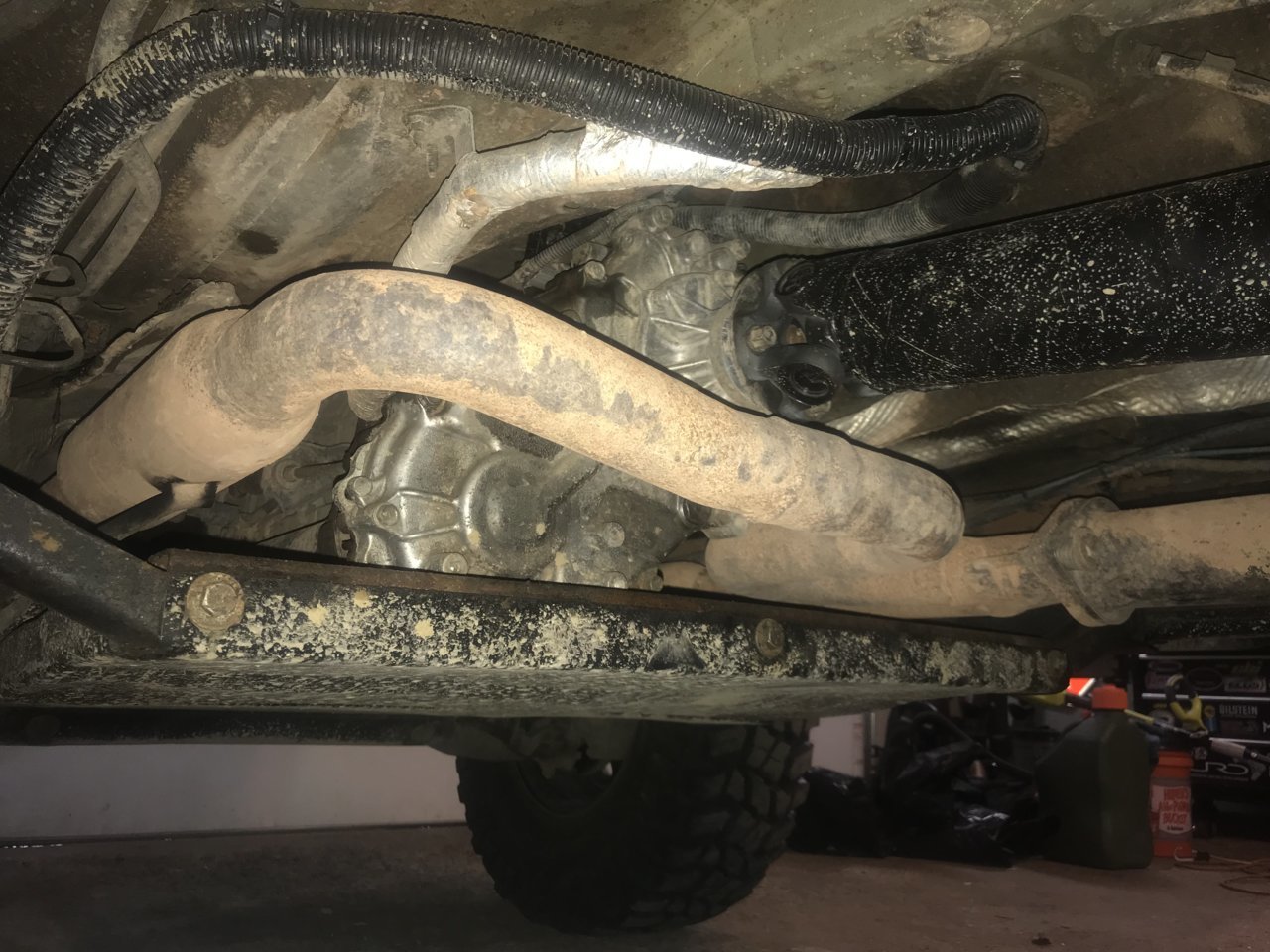

  11. Jun 9, 2019 at 3:06 PM
    HolyHandGrenade
    HolyHandGrenade NOOB
    Mar 25, 2013
    #100579
    11,800
    Tim
    Garage Most Likely
    DCFB (RIP)
    Some Stuff
    I was looking at your Y Pipe again just now. It certainly is a thing of beauty.
    That said, I only have about an inch - inch and a half between the skid and the trans pan. I need a pipe that goes back around the T-case like the DT one. I suppose that pretty much kills the equal length for me.
  12. Jun 9, 2019 at 3:09 PM
    JustDSM
    JustDSM Oderint Dum Metuant
    Jan 16, 2015
    #146525
    3,221
    Justin
    Ogden, UT
    2023 Ford Raptor
    A "Spec-U" layout would net you the layout you're looking for with equal length potential. From chatting with @Roostfactor about it, this would still put you behind the curve as far as keeping the power in the right RPM band as the Y-pipe length used in the Spec-U layout is just too long for the RPM window we need.
    It would be better than an equivalent unequal length setup though.. Food for thought.

  15. Jun 9, 2019 at 3:21 PM
    JustDSM
    Jan 16, 2015
    #146525
    3,221
    Justin
    Ogden, UT
    2023 Ford Raptor
    It's a older URD design that is a Ypipe/exhaust system (must be used complete).
    It's pretty cleverly designed, but the execution in my opinion after running it for a year was lacking. As mentioned in my previous post, the length of the Y in this system is not tuned to the ideal RPM band of our motors like @Roostfactor's Y pipe is. While it is equal length, it still has some low RPM torque loss where as @Roostfactor's Y will not.
    While I like the layout of the Spec U system, I think the execution was lacking as I mentioned. Specifically the "merge" collector, which could be improved in angle and construction. It's my opinion, that if you need a solution that has to route behind the transfer case, this is the layout you want. But I would not recommend this system ($1400) but instead use a layout similar to this with a proper merge collector and adapt that to your exhaust of choice.
  16. Jun 9, 2019 at 3:30 PM
    HolyHandGrenade
    Mar 25, 2013
    #100579
    11,800
    Tim
    Garage Most Likely
    DCFB (RIP)
    Some Stuff
    Ah. Nice. I hadn’t seen that before.
    Honestly, I’m no longer trying to squeeze every last pony out of this engine. The truck is big and heavy now. It’ll never be fast. I had to go back to the stock air box with an AFE drop in and a cowl intake after tubbing for 37s.
    I just need a Y Pipe that works with my skids. Off road is my priority now.

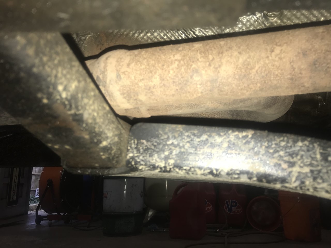

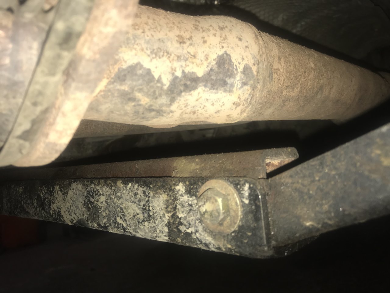

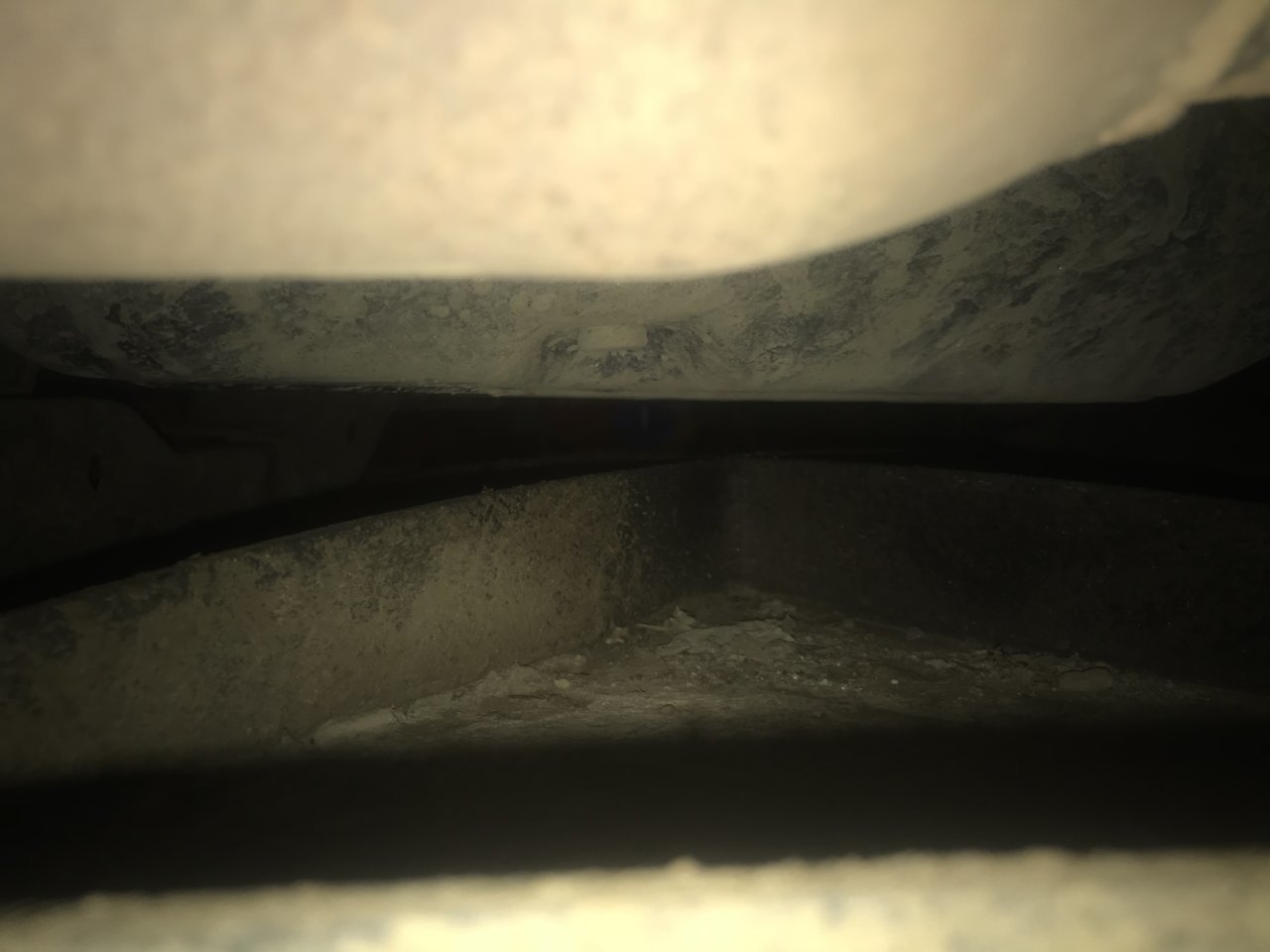

  17. Jun 9, 2019 at 3:49 PM
    HolyHandGrenade
    Mar 25, 2013
    #100579
    11,800
    Tim
    Garage Most Likely
    DCFB (RIP)
    Some Stuff
    Alright, here goes...
    Pan / skid clearance.
    It’s also close to the T-case skid crossmember. So stacked pipes into the collector like AFE wouldn’t work either.
