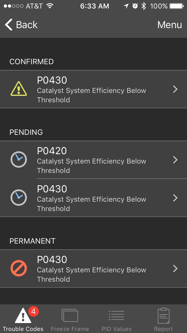

    IMG_2007.jpg Anyone get these codes? I've just been clearing them for a while now and figure I should look into fixing the problem. First showed up last winter and would periodically pop up. More often when it's cold outside, but the last month or so it comes up every few times I run the truck. Any input is appreciated.

    No aftermarket headers?

    Stock with the trd cat back

    Have you ever removed your headers?
    Have you checked to see that all of the hardware for the headers is tight? As in for a suspected exhaust leak.
    Do you have some sort of really bad vacuum leak? This would also cause a lean set of codes though.
    Have you tapped the front cats to listen for any rattles?

    Bad cats then. Or dying secondary O2 sensors. Also do the blowers have a break in period? I just beat on mine immediately lol.

    Never had em off. I checked to make sure everything is tight when the code started popping up more often. I assume there are no vacuum leaks or exhaust leaks since I can't hear anything and there has been no change in performance or runnability at all. But I'll have to tap around on them to see if there are any rattles.
    My guess was after 100k on the trd tune the cats were maybe starting to clog up or foul out an o2 sensor, but I figured if it were the sensor it would give a separate code for that
