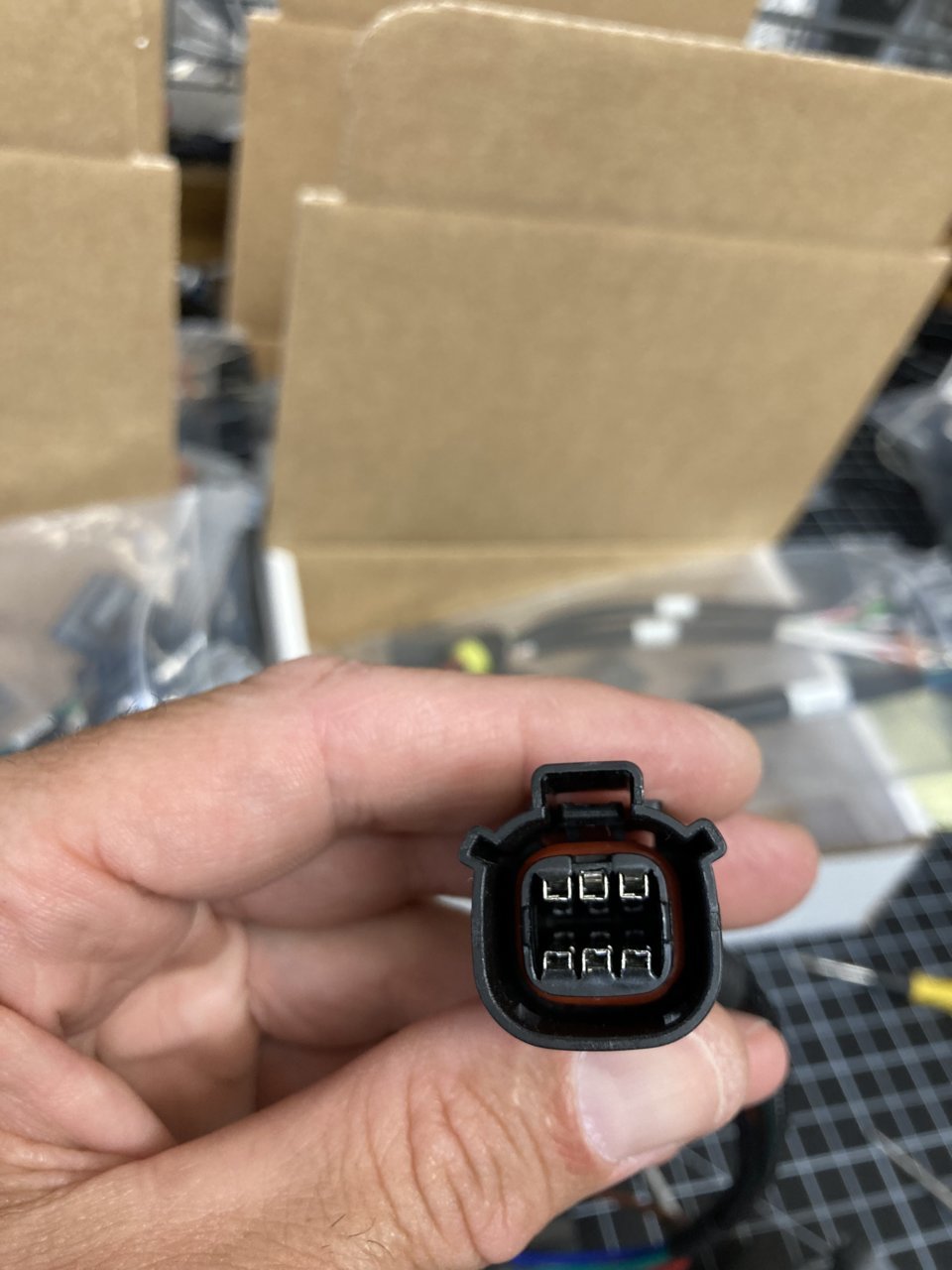

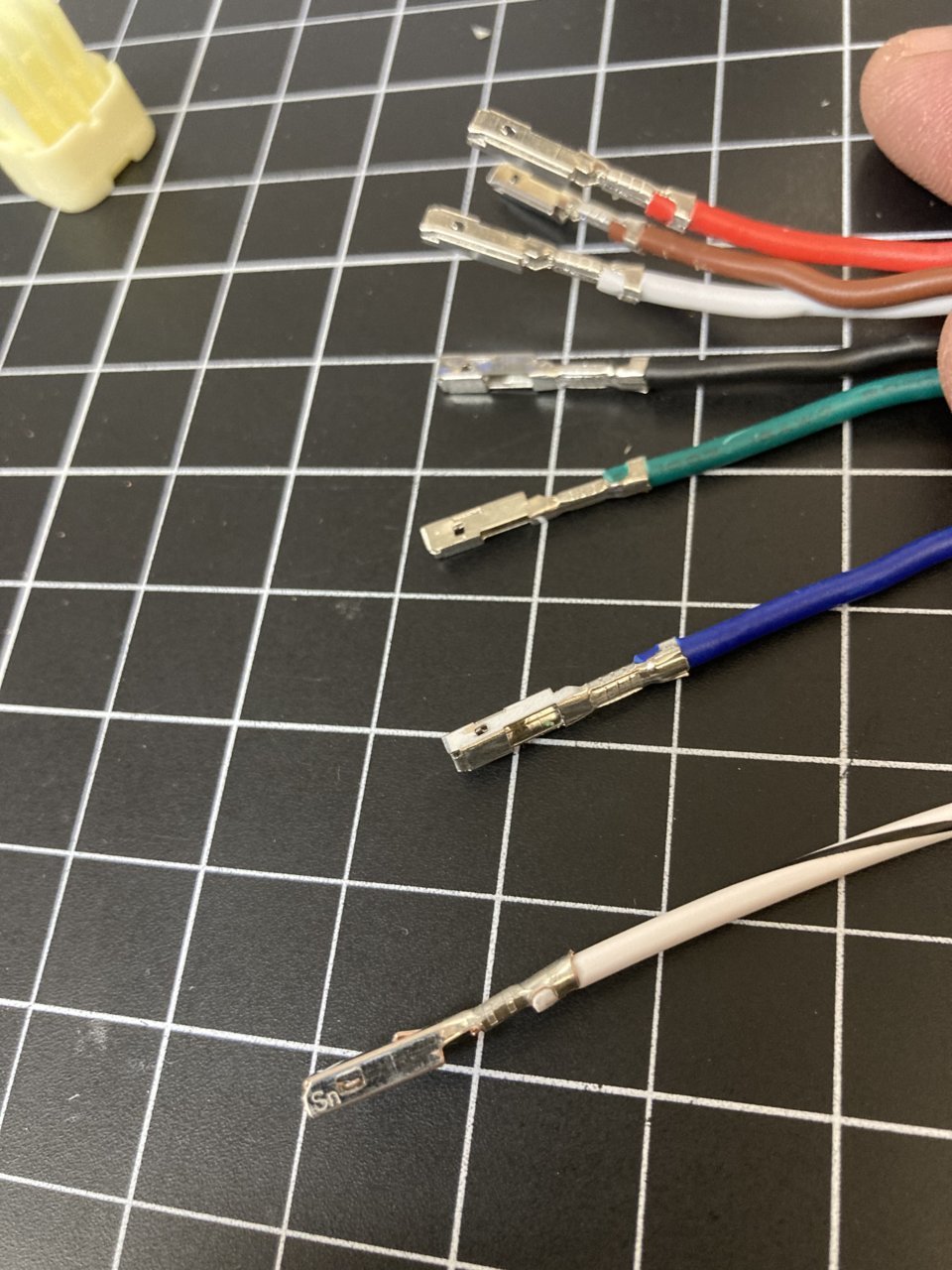

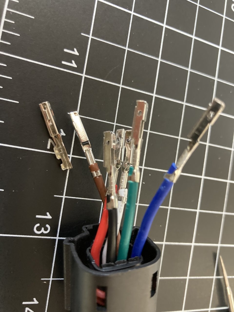

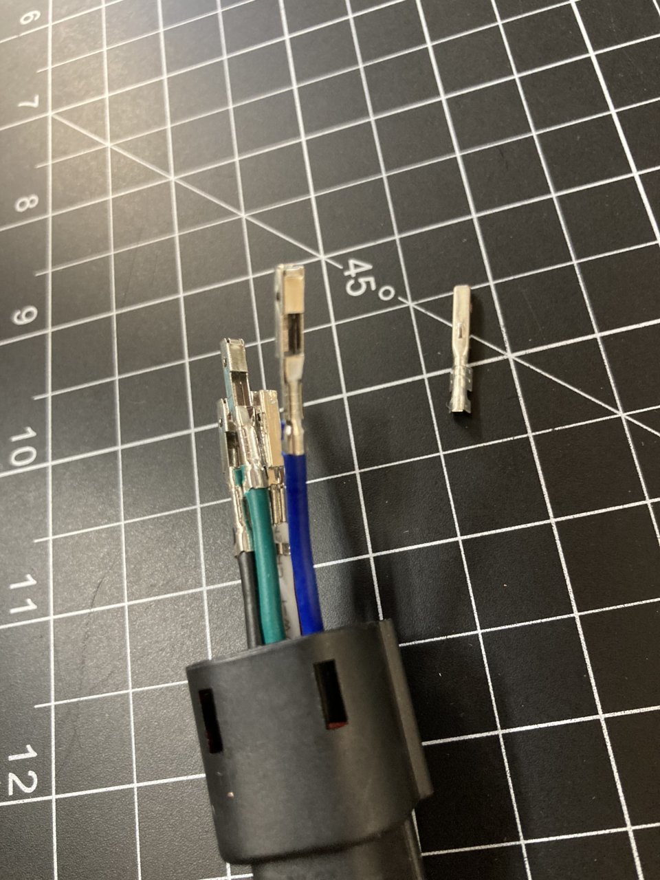

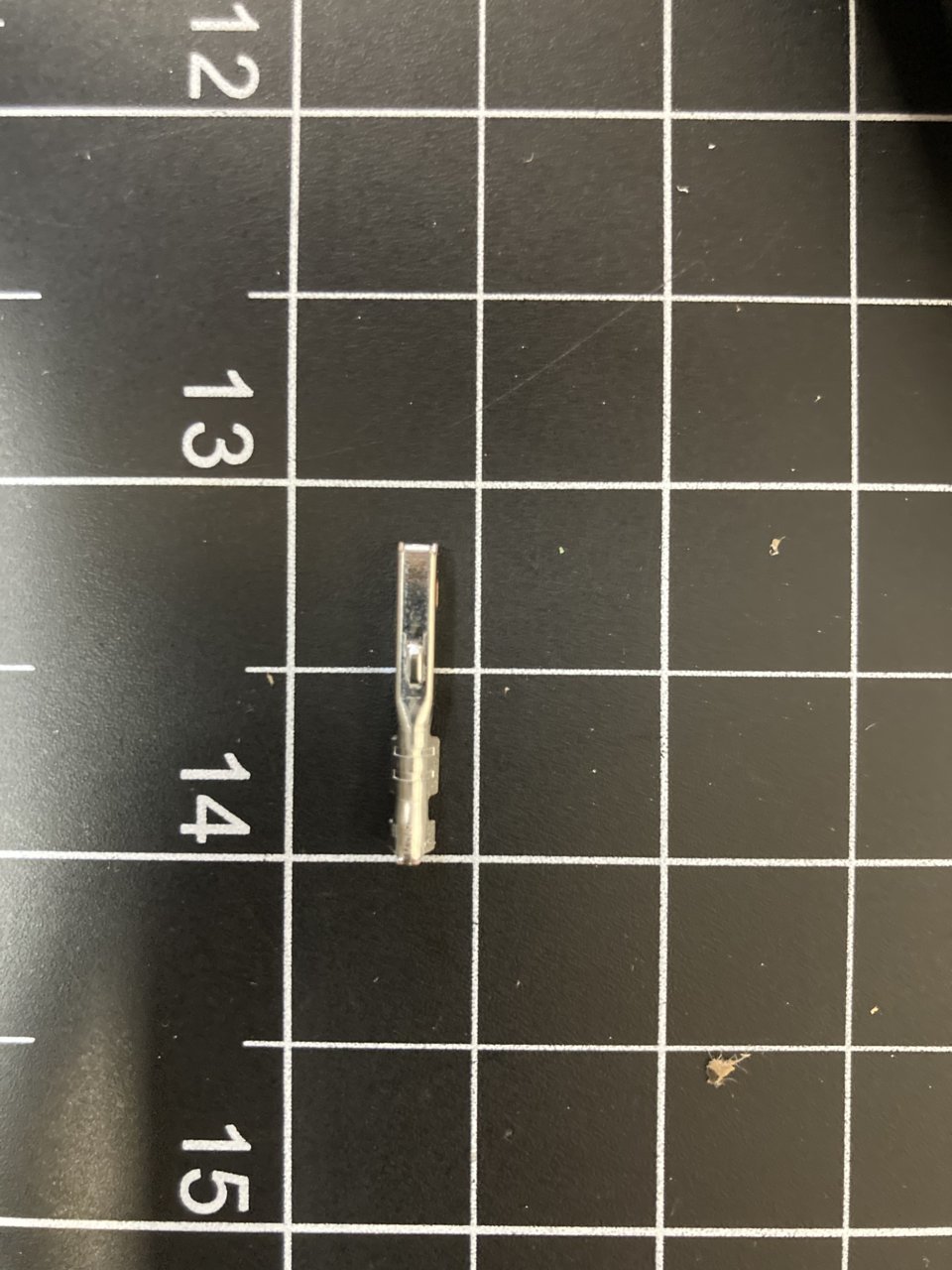

    OK, time to discuss the specific vulnerabilities of the eBay harness I recommend in the first post. It seems the terminals used in the MX-150 connector are different enough to potentially cause trouble.
    I just don't see it though, they look so close in size that I can't see why one would be troublesome and the other not.
    The solo terminal is mine as is the white w black crimped one.
    500A460D-F6BC-4B03-B31B-6117CBA12E97.jpg F0956A08-1C91-4196-880F-18FEE6263A39.jpg 59D45FA3-A715-4753-8FBF-7D409495748A.jpg D49221DD-6FA5-4928-BA5B-89ECA48A9FA5.jpg 03B2CE0C-BED9-45A3-AB78-F5D4E288572A.jpg

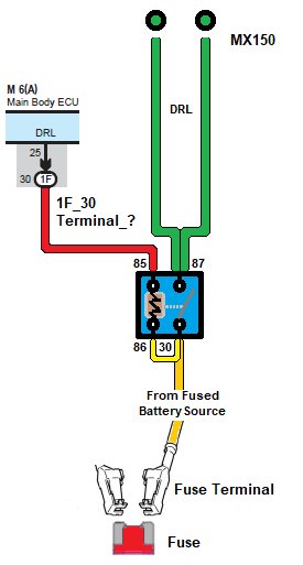

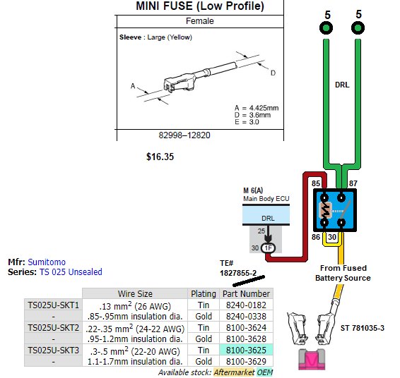

    On another note: The SR has the circuit to the LED DRL ground pin:
    It does not have the terminal in the 1F connector but the Main Body ECU has. Finding what type terminal is required to populate the connector is in the works. Still need to tap the rear turns for proper function since shutting down the DRL on the Head Unit will also shut down the 30_1F.
    C10 T (Rear Turns) would be very helpful for those doing the OEM LED Headlight add.
    Edit corrected:
    Terminal to 1F_30 and 2 options for missing fuse terminal.
    daveeasa[OP] likes this.
