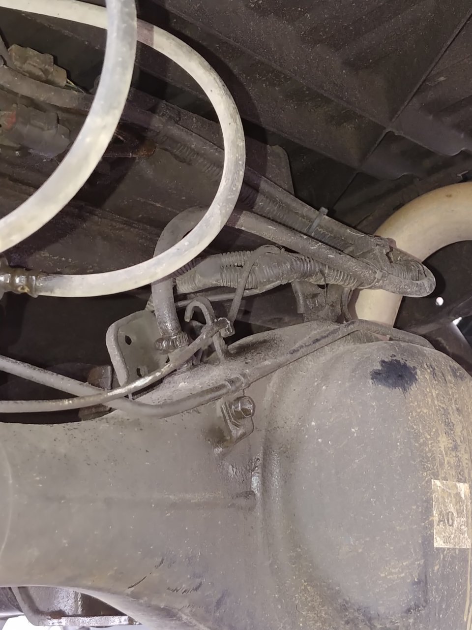

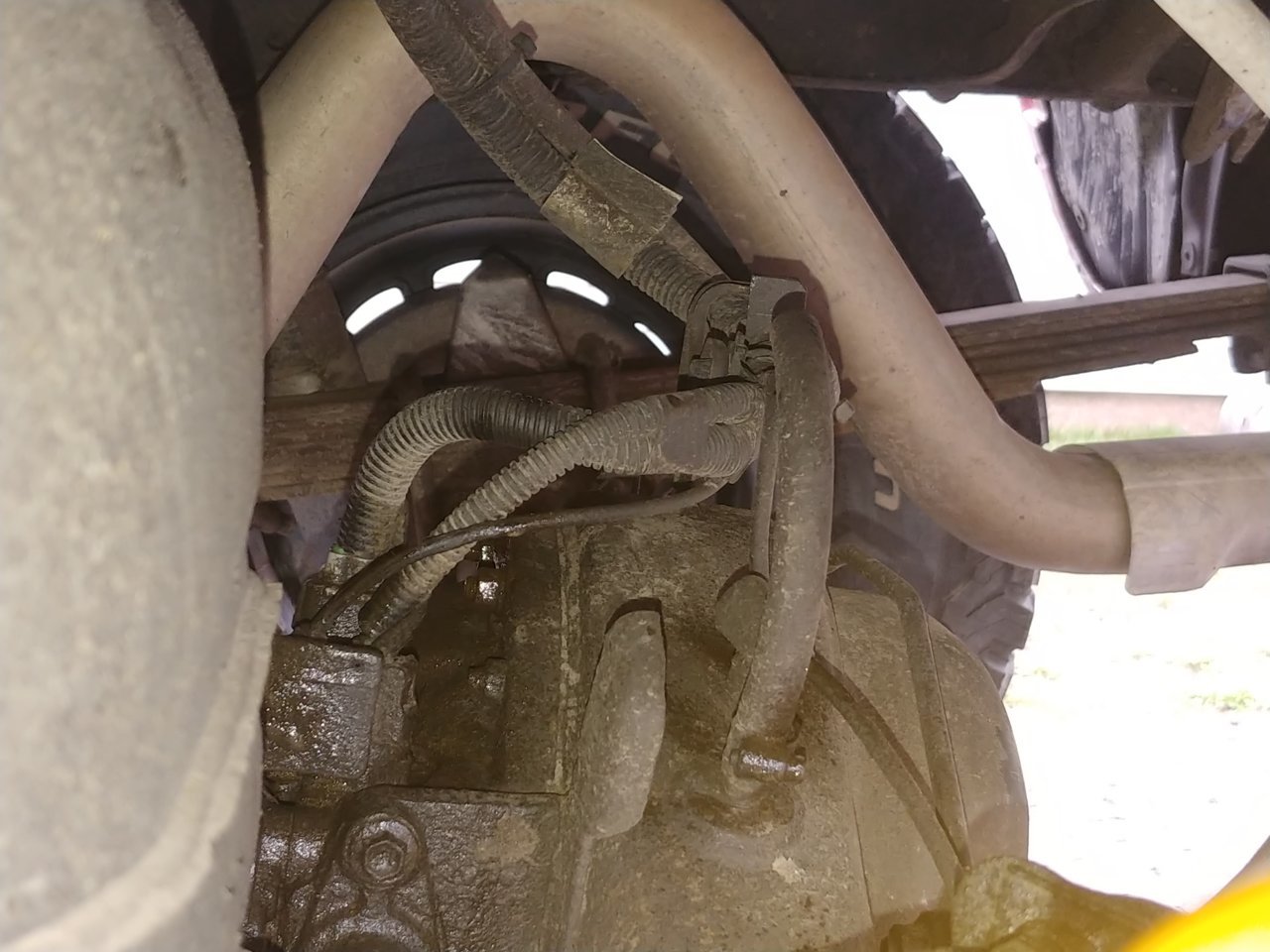

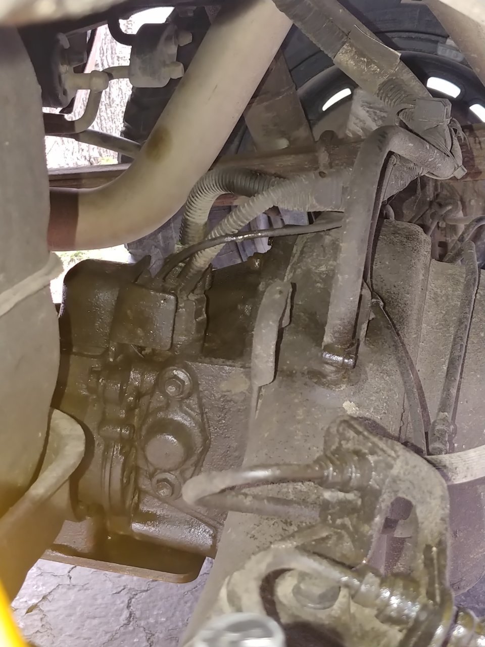

    @JKO1998 Grabbed a few pics for you last night while rebuilding my leaf pack. Two plugs merge into one loom
