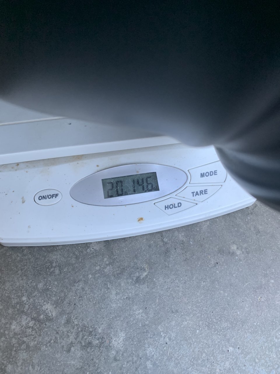

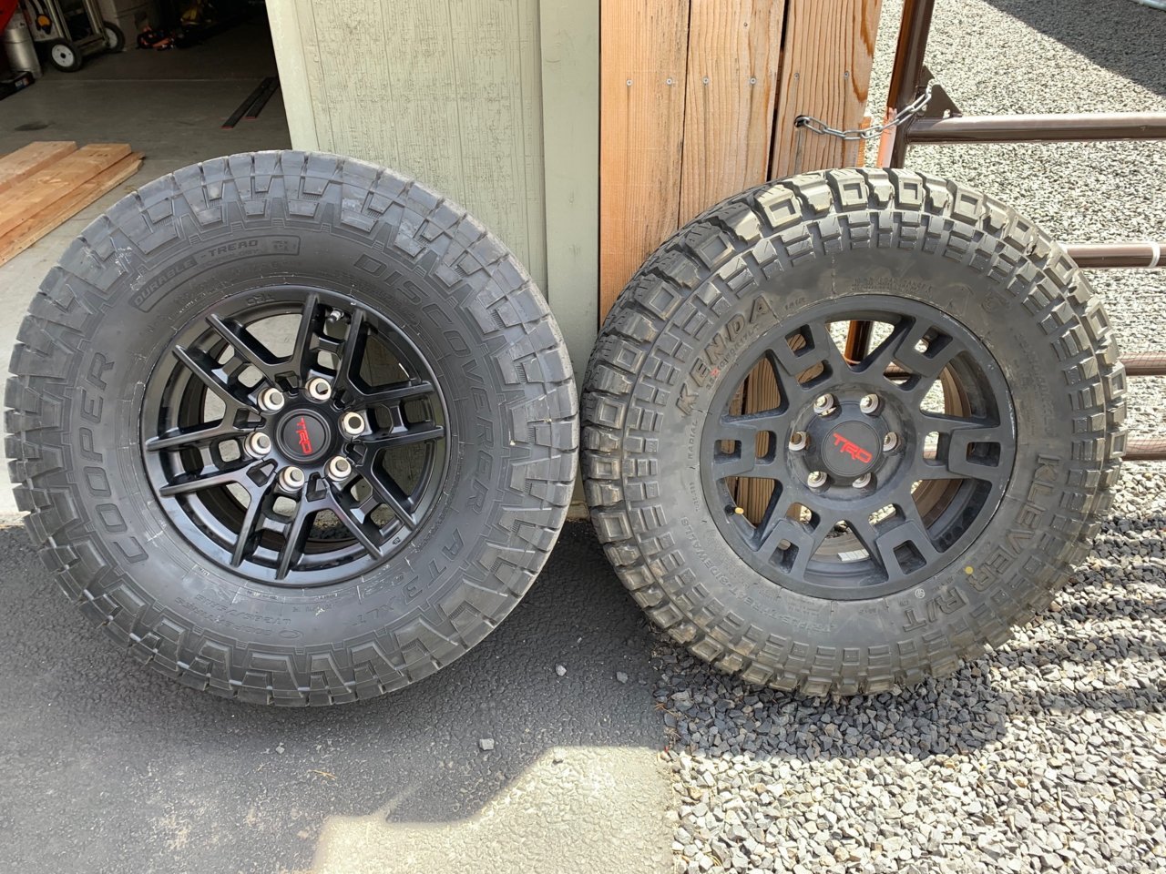

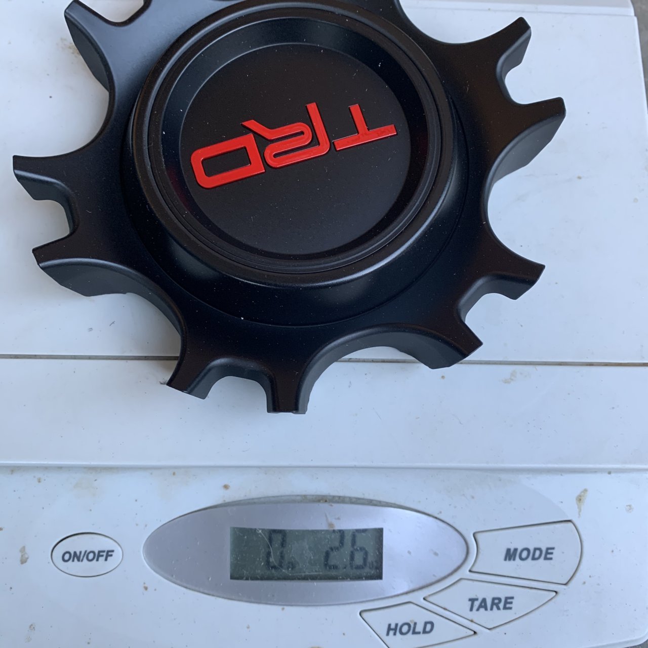

    I can confirm the weight of the wheel is correct as I weighed mine on a postal scale and got basically the same weight (this is without the center cap). The center cap adds about 2.5 ounces.
    I find it funny how people say less unsprung weight doesn’t really make a difference. These same people obviously have never tracked or raced a car. As little as a pound makes a difference on the track and can also be felt. Yes, won’t make a lot of difference on a heavy truck but any unsprung weight you can loose (like these wheels and going with a lighter weight tire) adds up. I dropped right at 10 pounds by switching to these wheels and going with a lighter tire. Easily noticed it while driving as the truck handles better and doesn’t gear hunt as much (even with my 4.88 gears). And I think these wheels also look great!B065D9C9-2103-49E3-9F00-85EF6A9CE9AF.jpg91C89E65-829E-4AD8-A43A-8EF267B42E01.jpg

    When I said I saved 10 pounds, that was 10 pounds per corner. So according to your estimate, that would be like taking 400 pounds off of the chassis. Pretty substantial.

    Cooper AT3 XLT tires. Great tire and one of the lightest 285/75r16 E load tires available.
