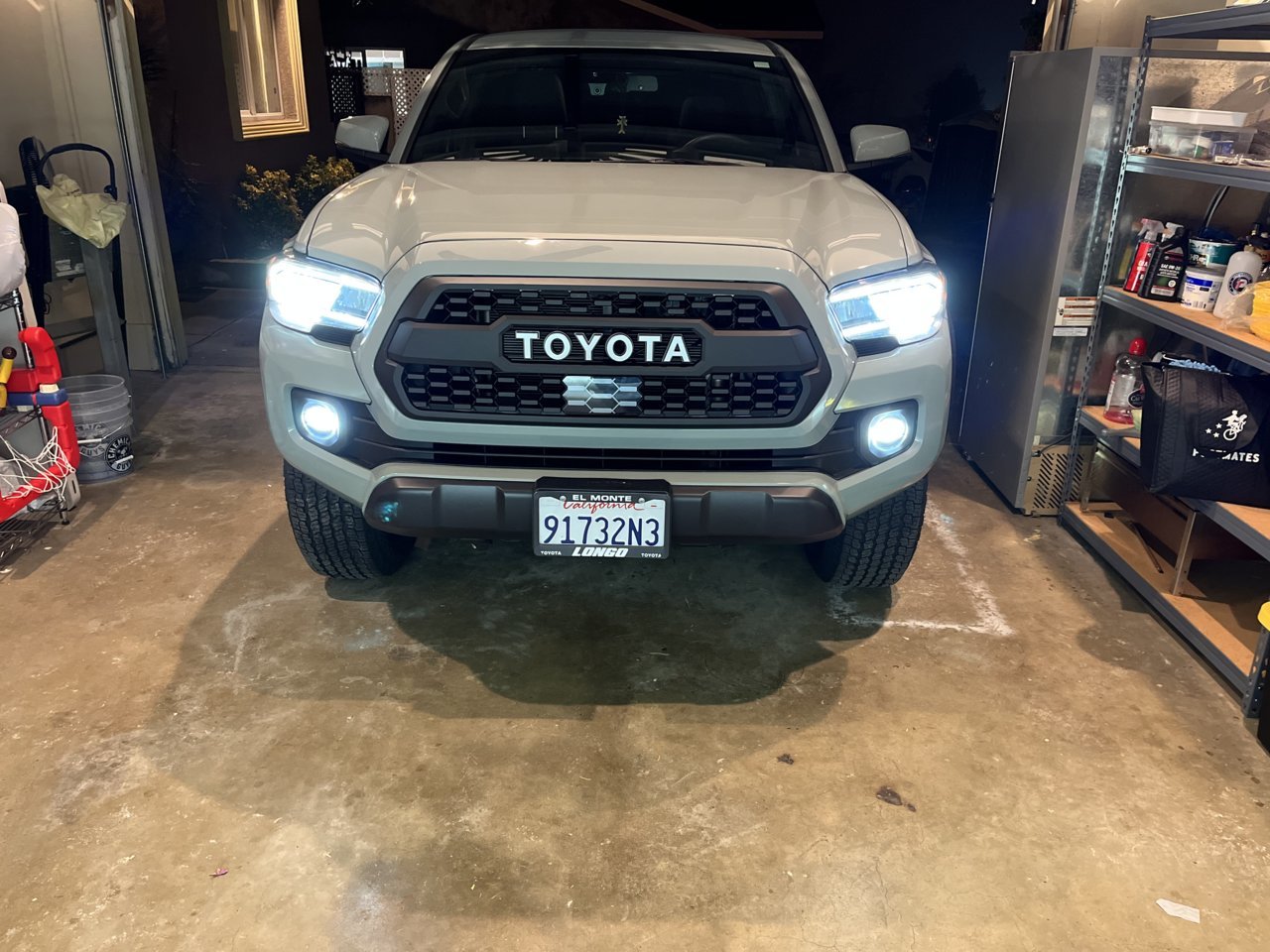

    I changed my grill to trd pro grill. I didn’t get the raptor lights. But I got the product from tacomabeast so it’s not OEM neither the sensor garnish for the TSS. The TSS works I checked. However, I installed the grill less than a week ago.
    You think should not have changed the grill at all?
    TRDRed and RIX TUX[QUOTED] like this.

    grill is ok to replace (everybody and their dog has the heritage grill as a replacement) as long as the tss works.....and the raptor lights are overdone for me
    TRDRed likes this.
