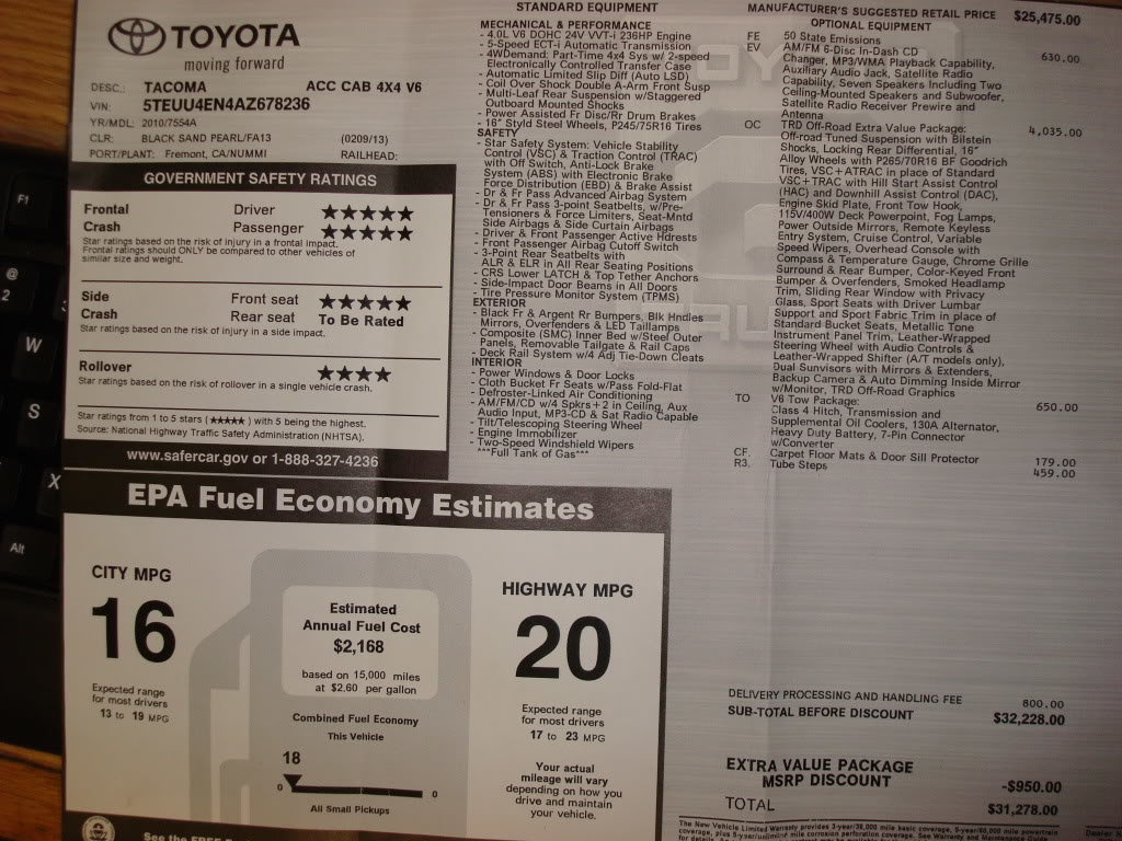

    Look at this Spec sheet for TRD OFF ROAD. It will tell ya what comes with TRD.
