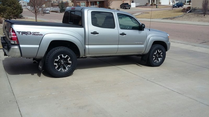

    I have new tires on my 2005 TRD OR wheels. From what I understand these are 16x8.
    I would like to put on 2018 TRD OR wheels and I hear they are 16x7.
    May be a dumb question but can I swap my tires over until I need new ones? I can get the tire size if you need it.

    The 2018 wheels and tires are a direct fit at stock size. The TPMS will need to be remapped.

    Will my tires fit the slightly wider rim?

    265/65R16?

    265/70/16

    Yes they will fit.

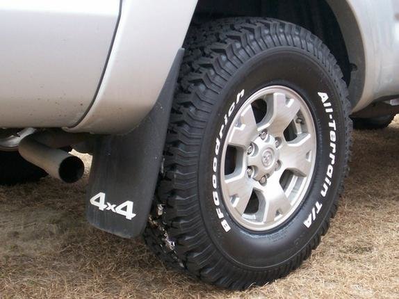

    Do they have the same lugs?

    21 Cement DCSB 4x4 TRD OR
    same lugs?

    same 6 lug pattern has been used by toyota for quite some time. But yes, 2nd and 3rd gen trd OR's use the same setup.

    Same actual lug nuts, yes!!
