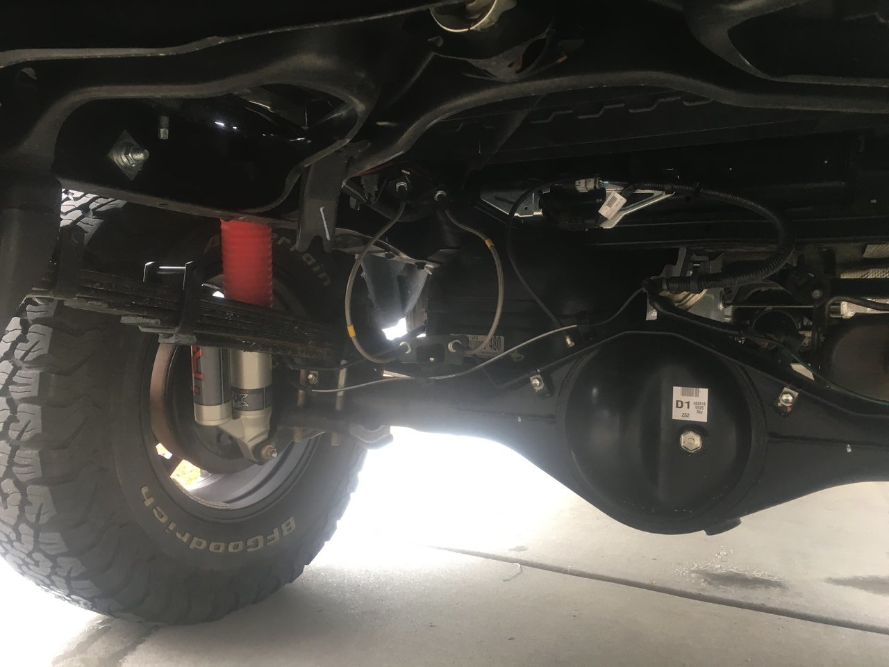

    A lot of stuff, just ask and I'd be happy to tell you. Or we could wheeling/camping
    I ordered a leaf pack from Deaver Suspension Inc. It is anleaf pack they designed so the truck would still function as designed while under weight.

  17. Jan 28, 2018 at 7:38 AM
    #17
    Bray1197
    Bray1197 Well-Known Member
    Mar 10, 2016
    #180827
    617
    Bobby
    Myrtle Beach, SC
    2017 Tacoma Trd Pro
    Here’s a pic of on side
    ls7alex [OP] likes this.
