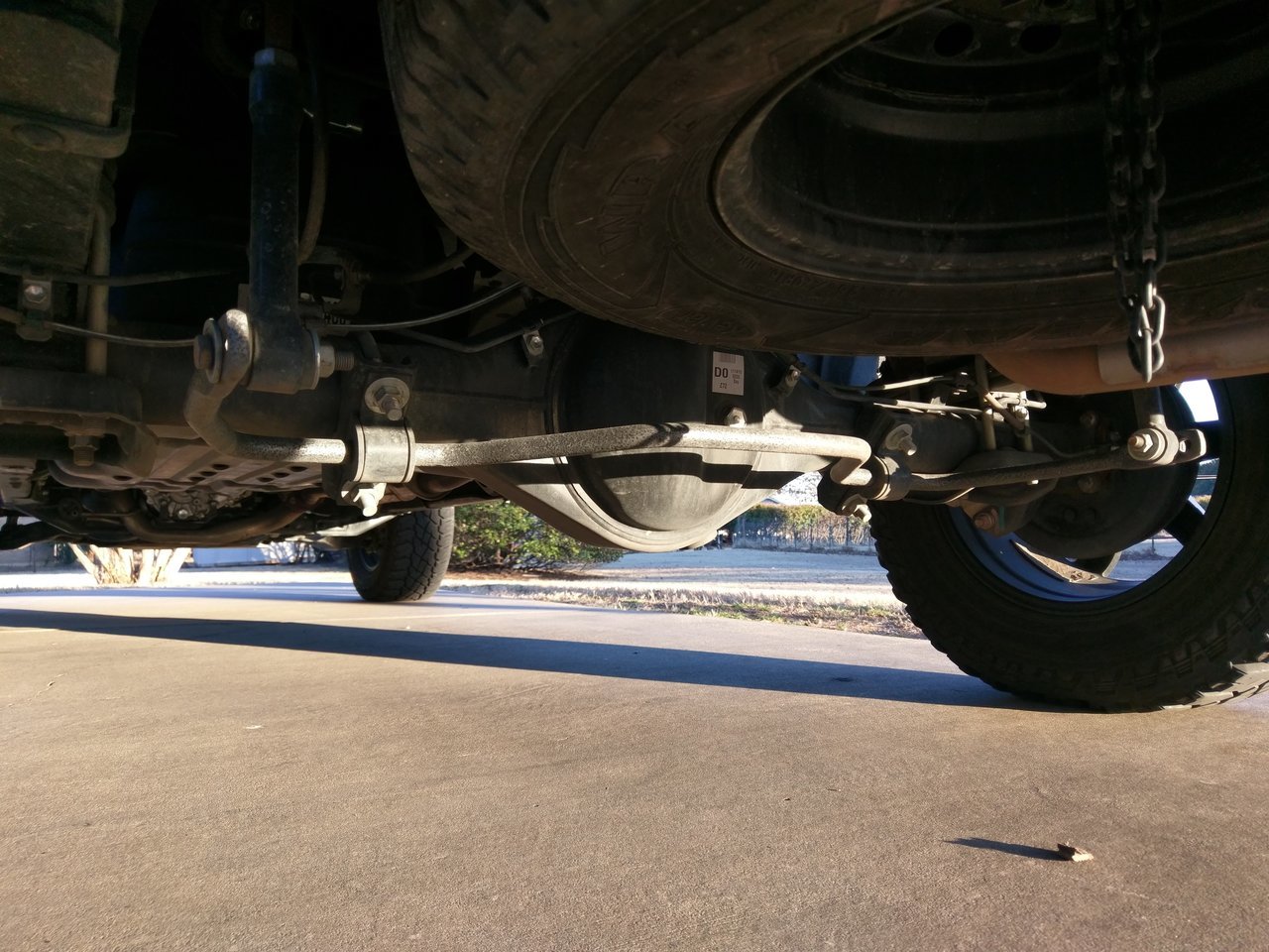

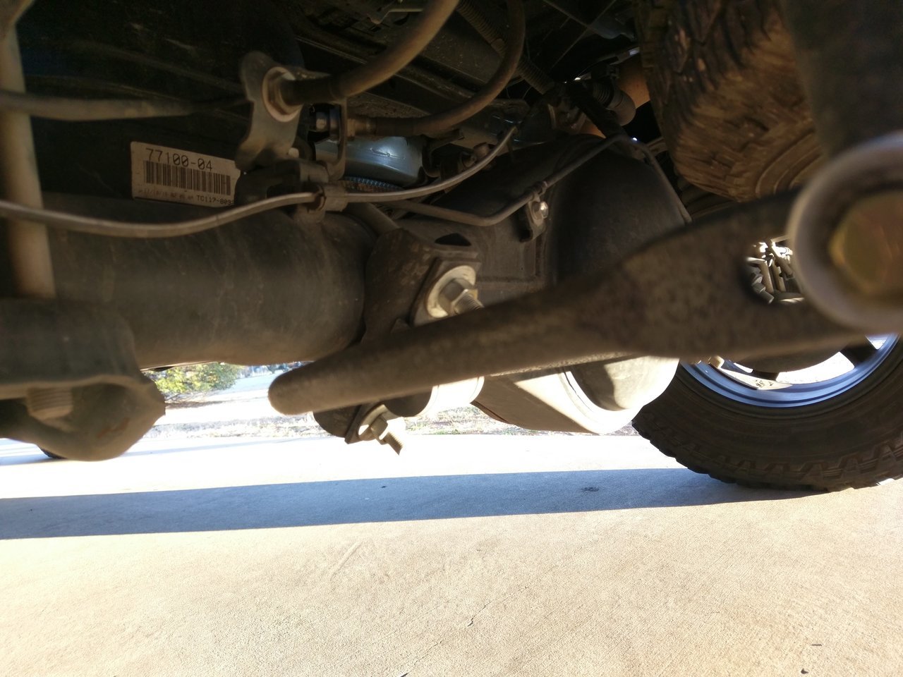

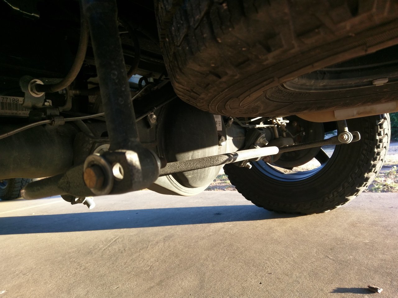

  7. Jan 28, 2018 at 2:54 PM
    #27
    su.b.rat
    su.b.rat broken truck
    Jul 30, 2016
    #193316
    9,869
    Hellwig. i don't know of another option for the 3rd gen. it's great for me, but it won't help with a sag problem.
  8. Jan 28, 2018 at 3:00 PM
    #28
    My Truck
    My Truck Well-Known Member
    Aug 13, 2016
    #194504
    1,866
    Bay Area, CA
    2016 SR DCSB 4x4 Super White`
    Thanks. How was the install, any pics?
    Do you know if the pro leads are different from the standard?
  9. Jan 28, 2018 at 3:28 PM
    #29
    su.b.rat
    Jul 30, 2016
    #193316
    9,869
    i didn't do the install but it wasn't a big deal at all.
    Bridge4 likes this.
