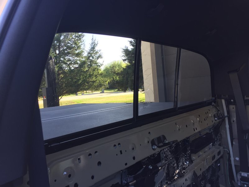

    What was the cost for the sliding window mod? Did you swap the window or...? Just curious if you could share the process. Thanks

    cost is about $1,000.
    I swapped the window for a 2017 version.
    I'll add details on the process once we are completed.

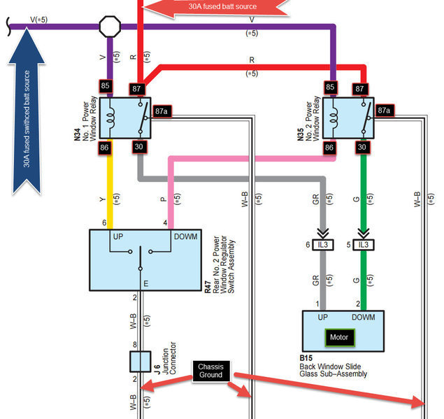

    Installed the cable assembly for the power sliding rear window this weekend. Fits perfectly. There are clips included with the cable assembly that hold the cable against the rear wall of the truck. No modifications needed.
    Also for those interested, I also purchased an additional cable assembly from a Tundra just to see the difference and can confirm they are very similar. Only difference is the length of the cable. In fact most of the Tundra rear power window parts are very similar if not exactly the same as the Tacoma parts.
    Still awaiting 2 more parts from the dealer before we can finish the install.

    IMG_2743.jpg Getting closer.
    Just wired it up.

    IMG_2924.jpg Completed the rear power window install. Had to wait for a part... works perfect!!!!
