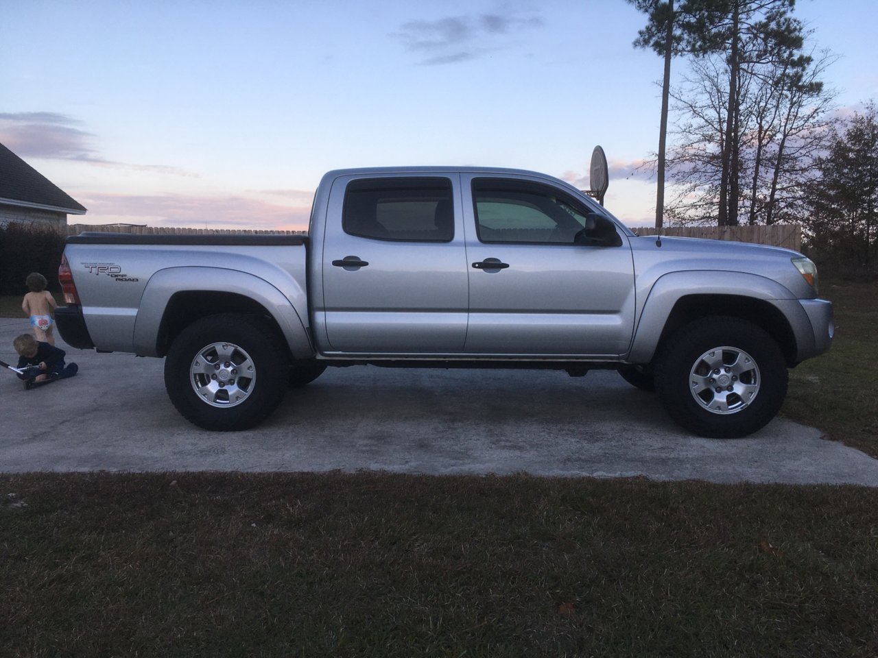

    I installed my icon progressive with the smallest leaf removed. (Also overload removed ) and got exactly 1 inch of lift. And the ride feels greatttt.9AC1A362-C970-4266-8E78-AD3EA93FFB8B.jpg

    If your just looking for one inch and not 1.5 inch...
