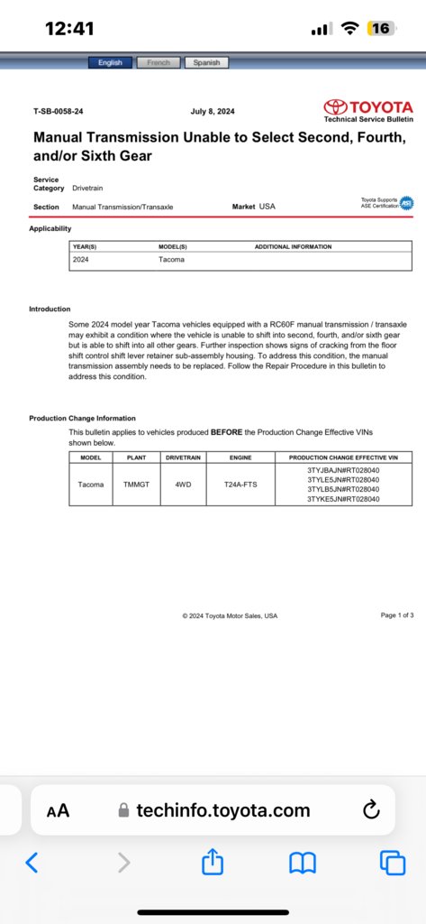

    July build date? That’s pretty late in the game for failing transmissions on this gen. I’m going to go ahead and shop around for platinum coverage.

    No manuals I honestly can't understand how to read it though

    There a whole other tsb for failures of the Manuel transmission
