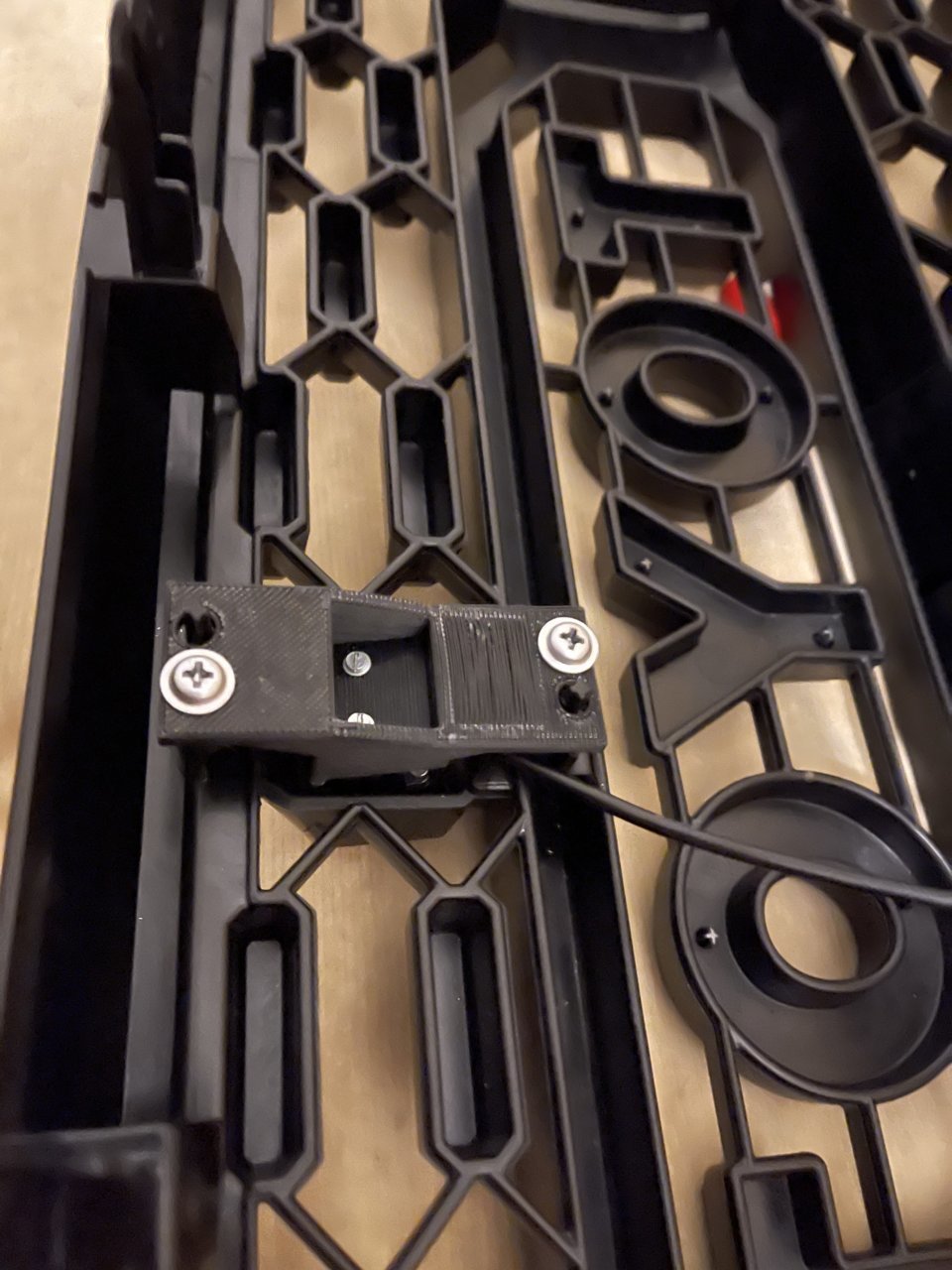

    Got my 2020 pro grille in today, gonna modify this to make use of the nakita camera or another Amazon camera I have to see which I like better in the grille.
    thanks for thingiversing it. Save me a lot of measuring time, I will remix whatever I do to it.

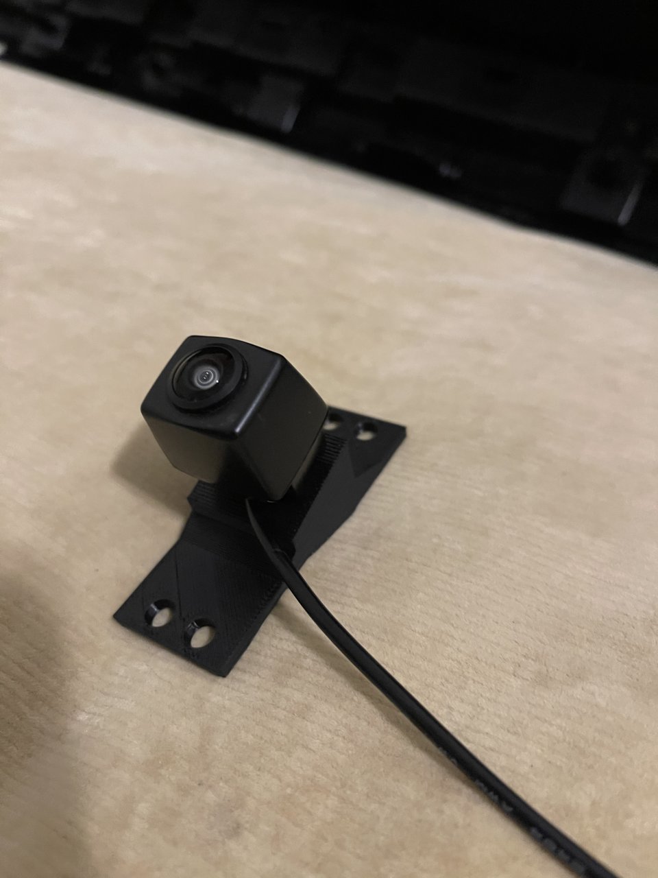

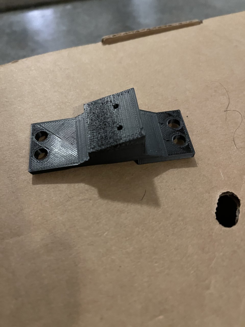

    Almost there, it’s, perfectly flat on the mount points, trying to get the Nakita perfectly lined up. Thought I had it on the 3rd print but it was a mm or two too tall and the camera was pressing against the front part of the grill. Hoping 4th print is perfect. Need to work on my abs settings, starts messing up as it gets higher. PETG should be fine though, but I will probably vapor smooth ABS for my grill. Gonna make a version for my type of Nakita for the OR/Sport grille as well since I pretty much have the mounts and angles down now.

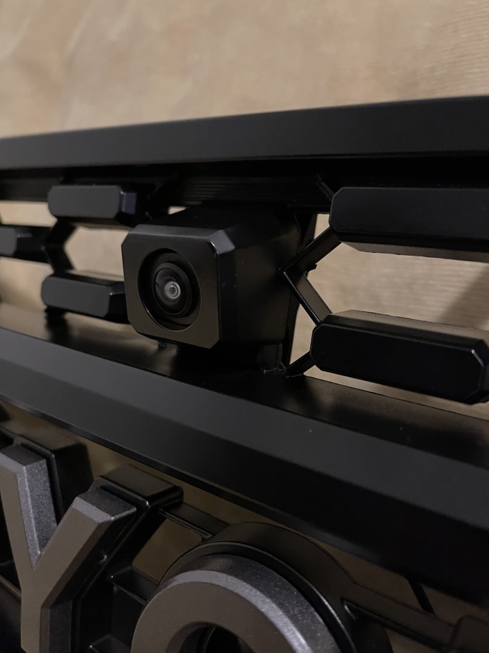

    It’s finished and installed, sensor seems to be working fine so far. Glad I went sparksparts OEM and found that eBay garnish find LOL.
