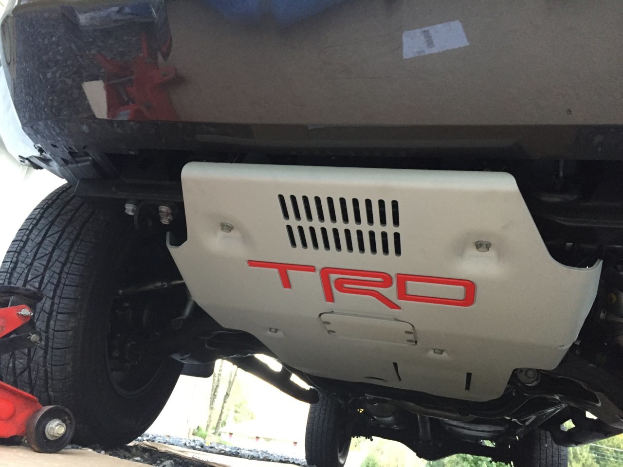

    I’m a little late with a picture , but here it is on my 2018 Sport. All the bolts were captured to the plate with the spacers . Took about 6 minutes to install. The 4 forward mounting bolts doesn’t use the same mounting holes as the factory “ splash guard “ use .
    Even came with the plastic red lettering
    inlay. That’s a chunk of metal hanging there . Glad I put it on .
    Spare Parts likes this.

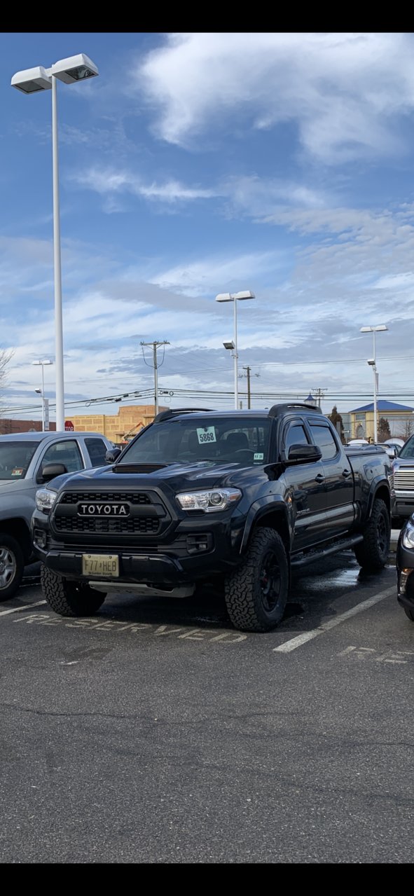

    This isn’t the greatest pic but it’s from afar. I can take more in the am if you want. Let me know. I zoomed in a bit and took a screen shot of my pic.
