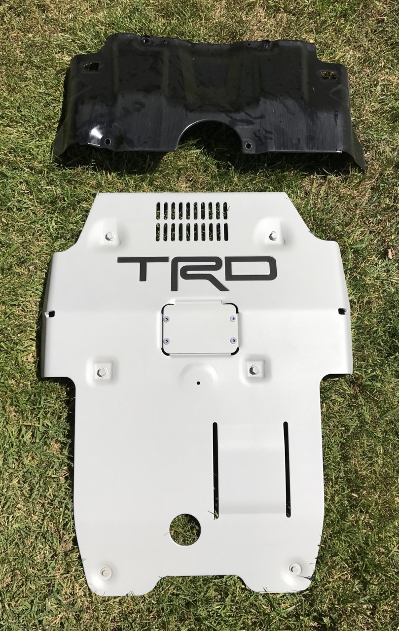

    The difference between the factory OR skid plat and the PRO is huge. The factory is very thin sheet metal. The PRO skid plate is maybe 1/8" solid aluminum and is a vast improvement.

    The Pro skid is 1/4” aluminum.
    Here is it compared to the thin steel one:

    Good picture comparison. Makes me glad I bought one today. Now if the dealership will just deliver it, I’ll be set

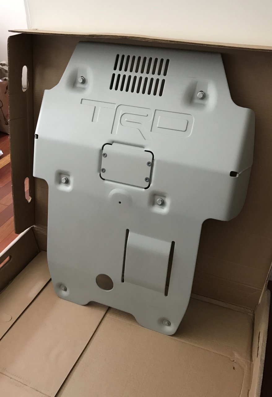

    Normally, it does. This is how I received mine:

    No red letter inlay?

    Think the red lettering comes with the 19's. Different part #
