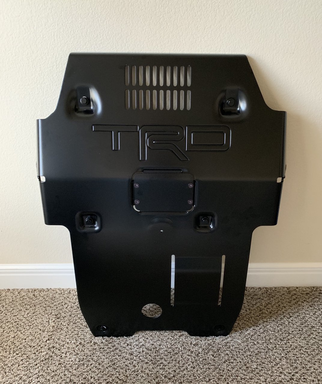

  3. Apr 15, 2019 at 8:58 PM
    #43
    Tehcoma
    Tehcoma [OP] Active Member
    Dec 17, 2017
    #238764
    34
    You don’t remove the subframe. You remove the factory bolts and replace them with the bolts and sleeves included with the TRD Pro skid plate.

  6. Apr 17, 2019 at 3:04 PM
    #46
    Xx_Evilvirus_xX
    Xx_Evilvirus_xX Well-Known Member
    Sep 20, 2018

  7. Apr 17, 2019 at 3:14 PM
    #47
    2016Tacoman
    2016Tacoman Well-Known Member
    Jun 23, 2016
    #190389
    3,484
    J
    2016 Tacoma 4x4 V6 Metallic
    :benchpress:
    Actually with the help of a 2nd person.
  8. Apr 17, 2019 at 5:41 PM
    #48
    Johnny77
    Johnny77 Well-Known Member
    Jan 6, 2019
    #278404
    815
    Dustin
    San Diego, CA
    2019 Silver Sky Tacoma TRD O/R
    Yup! Ended up getting a buddy to help me out. It was super easy took about 20mins.

  11. Apr 21, 2019 at 4:31 PM
    #51
    TacoMan408
    TacoMan408 Well-Known Member
    Jan 30, 2016
    #176551
    344
    CA
    2016 TRD Sport Manual
    OVTune (04B13+1.05 87 FOB), Morimoto XB Headlights, Toyota LED Fog Lights, Toyota TRD Lift Struts, Wheelers Progressive AAL, TRD Pro Tail Lights, 17" TRD Pro SEMA wheels, BFG 285/70R17, TRD Skid Plate, Bakflip MX4, OEM Audio +, Anytime Front Camera, G-Tek Fab Door Sill Protectors, WeatherTech Floormats Suntek Carbon 35% Tint
    Anyone know the actual thread sizes of these bolts?
    Never mind...found the info I needed.
    17mm hex socket front bolts. Threads: M12 x 1.25 x 67mm
    17mm hex socket middle bolts. Threads: M12 x 1.25 x 90mm
    12mm hex socket rear bolts. Threads: M8 x 1.25 x 35mm
  12. Apr 27, 2019 at 2:57 PM
    #52
    Kamille.bidan
    Kamille.bidan Well-Known Member
    May 9, 2017
    #218629
    1,845
    2017 Blue TRD OR MT
    just wrapped-up the install.
    I almost took off the spacers and retainers off until I realized they were necessary parts. If you’re skid plate comes with the spacers and bolts pre-installed, don’t take them off. I actually took the two retainers off the 12mm bolts and one off the 17mm bolts. This was because the picture in the online instructions didn’t have the bolts pre-installed as skid was being attach to the frame. I was able to put everything back together.
    I torqued the 17mm 25ftlbs. Are you guys sure it shouldn’t be 33ftlbs? How many people had their weld nuts break at 33lbs?
  13. Apr 27, 2019 at 3:53 PM
    #53
    LTG4087
    LTG4087 Well-Known Member
    Jul 3, 2012
    #81852
    1,358
    LT
    DFW
    2019 TRD Off Road
    Was going to do it myself but wanted it on asap (you know how that goes) so I had a local off-road shop do it for $20. Easy peasy with the truck up on a lift. Took all of 15 minutes. Subsequently I traded the truck in on a 2019 and the dealer swapped it out for me.
  14. Apr 27, 2019 at 9:06 PM
    #54
    shakerhood
    shakerhood Well-Known Member
    Aug 9, 2015
    #161370
    37,146
    Southern Ohio
    2017 MGM DCSB Off Road, 6 Speed MT, P&T
    I am pretty sure the instruction card said 33 Ft Lbs.
  15. Apr 28, 2019 at 9:07 AM
    #55
    Kamille.bidan
    May 9, 2017
    #218629
    1,845
    2017 Blue TRD OR MT
    I know but so many people have broken their weld nuts using 33 lbs apparently.
    shakerhood[QUOTED] likes this.
  16. Apr 28, 2019 at 10:08 AM
    #56
    shakerhood
    Aug 9, 2015
    #161370
    37,146
    Southern Ohio
    Oh wow I hadn't heard that, thankfully had no issues when I did mine.
