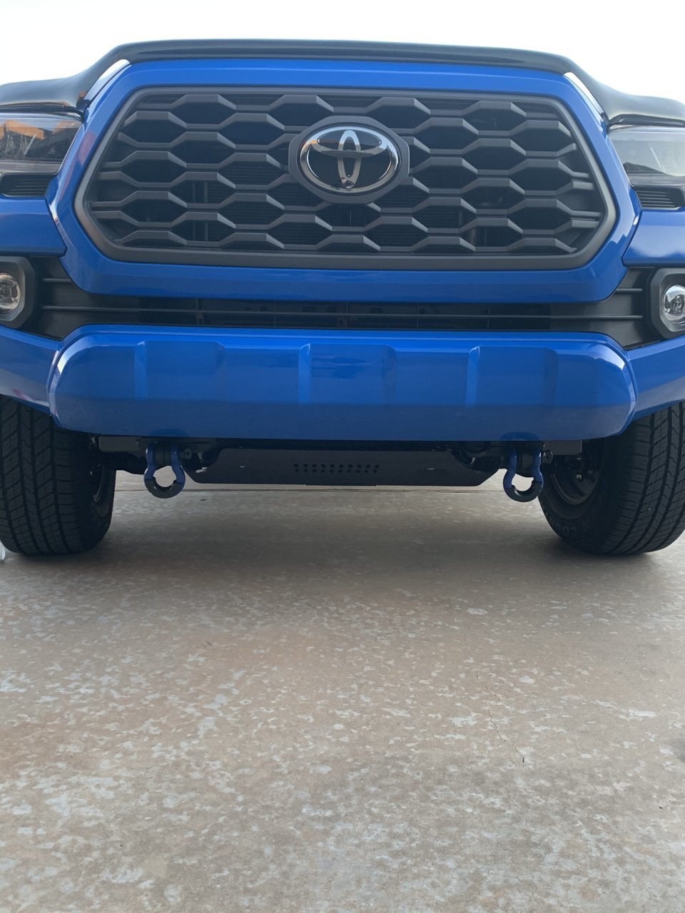

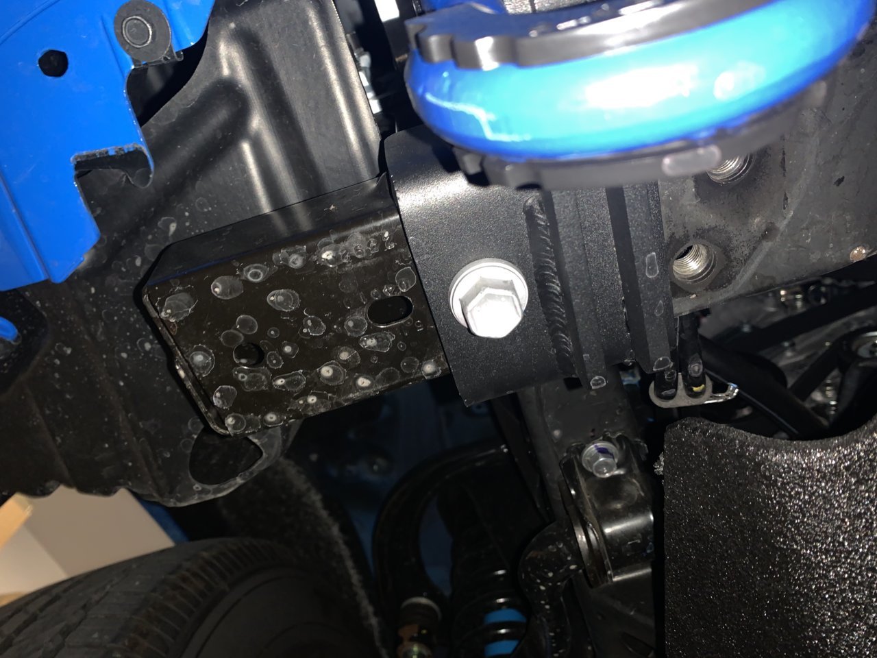

    A TREMENDOUS thank you to all who posted information here. Following everyone’s advice (and mistakes at times), I put anti-seize on the bolts and had it installed alone in about an hour. I like it!
    Note: this is the TRD knockoff skid plate from Amazon. I had it sprayed with bed liner.

    Dig the bed liner on your knockoff plate. I’m curious about your front shackles? Are they mounted diy or is there a part you need to order? Thanks
    gbailey814[QUOTED] likes this.
  18. Dec 13, 2020 at 11:14 AM
    #78
    gbailey814
    gbailey814 Member
    Oct 22, 2020
    #344620
    20
    2021 Tacoma TRD Sport Double Cab (3.5L V6)
    Thanks! For the shackles, I bought these mounts. https://www.amazon.com/gp/aw/d/B07PGLK9CD?psc=1&ref=ppx_pop_mob_b_asin_title You just need to remove the bolts and plate holding the factory tie down. I also bought the autobot shackles from Amazon here https://www.amazon.com/gp/aw/d/B08DXYBDXR?psc=1&ref=ppx_pop_mob_b_asin_title
    It’s only one bolt that attaches to the frame, but it is sturdy. I wouldn’t try to pull a vehicle with them, but for pulling logs out around the farm it’s perfect.
