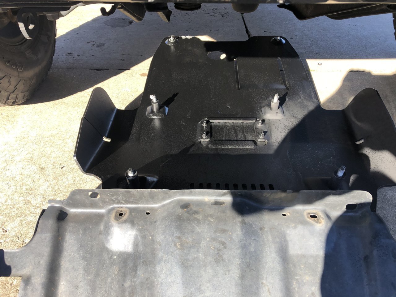

    Is there a different mount point for Sports? I just removed my old plate, and the front bolts don't line up on the new skid plate. Directions say it fits a Sport but I have to remove the air dam which I did years ago. Anyone know what I'm not seeing here? Thanks for all the tips!
    Edit: By front bolts I mean the front of the truck. middle and back (toward the rear of the truck) appear to line up perfectly.

    So I went ahead and lightly threaded the middle and back bolts:
    1. the front bolts are now nowhere close to the holes where the old front bolts went.
    2. The middle (and front) bolts on the new plate are way too thick. Which sounds like this has been answered above in buying new bolts/spacers.
    I have no problem buying new hardware. Just starting to think I got the wrong plate for a 17 Sport 4x4 with those fronts being so far off. As you can see in the pic they’re slightly wider but so far off when mounted

    Dang, just looking at your picture, I think they made it wrong. The bolts in mine were all evenly spaced apart. It’s the front right screw in your picture that is the one that’s off.

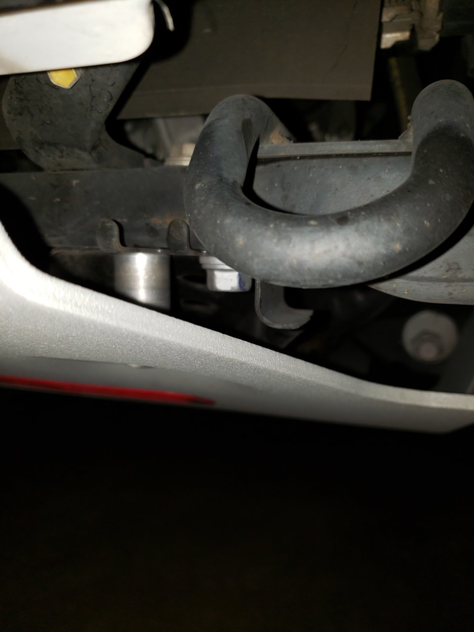

    Which frame holes are you aligning with?
    Here is a pic for a reference.
    Your skid looks fine. My pic is the driver’s sides. Locate the towing shackle. Go to the left and remove 2nd bold from the frame. Thats is your hole for the front bolt.
    Do the same on the pax side

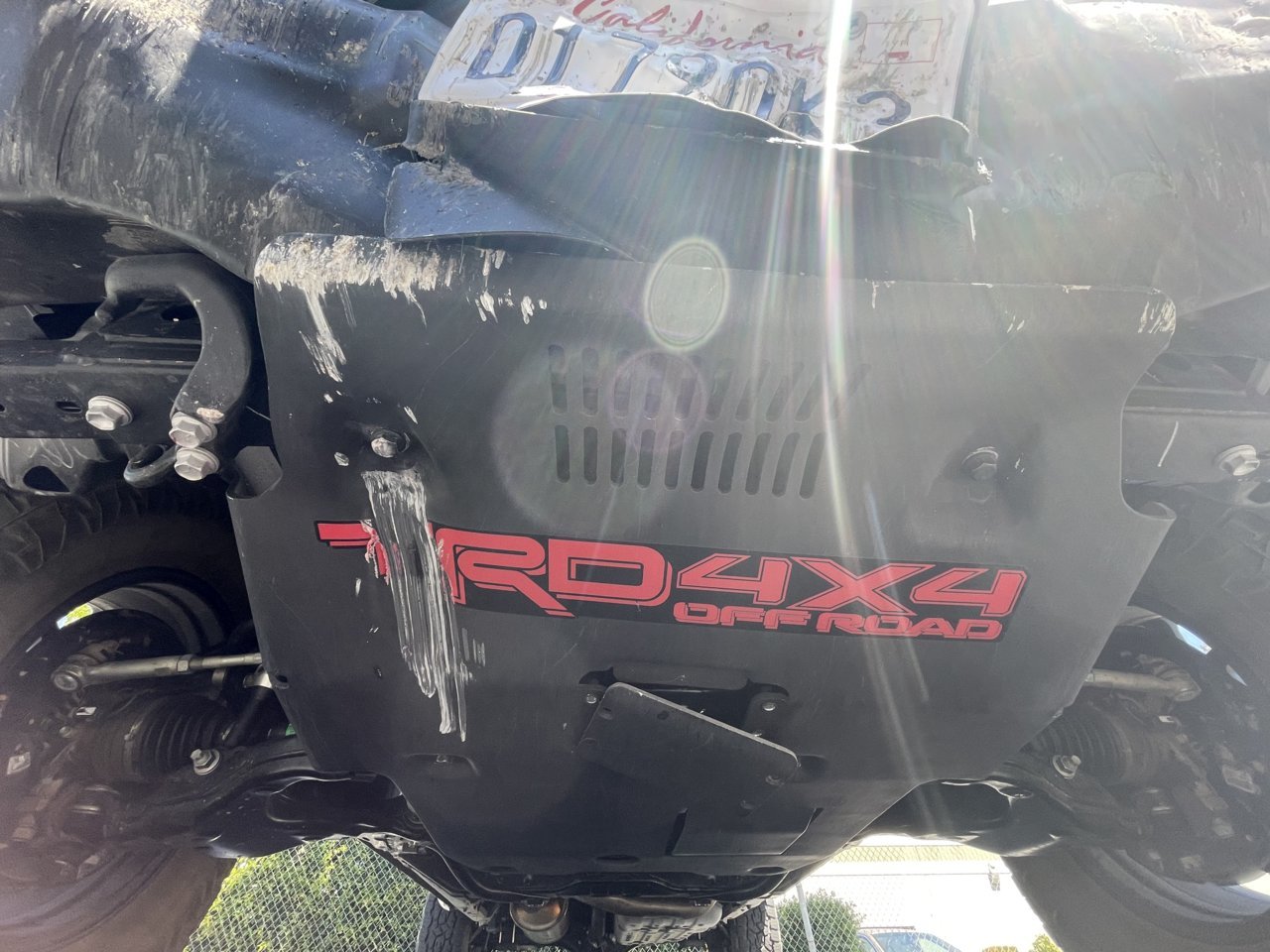

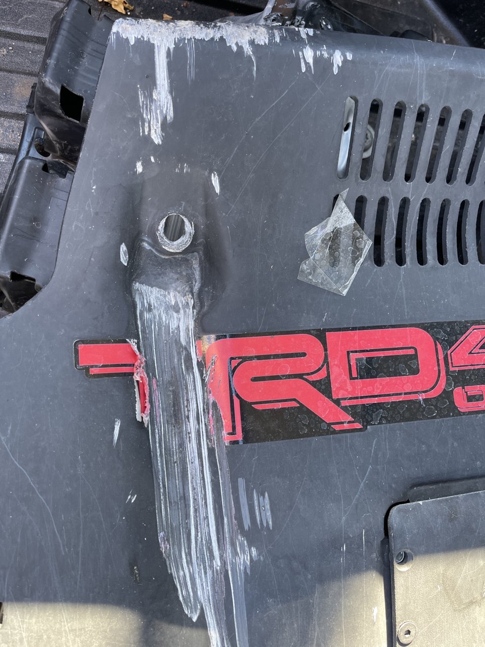

    Does anyone know the exact bolt dimensions for the 17mm bolts including thread size.
    My aftermarket skid plate took a direct hit to one of the front bolts. Luckily I was able to get the bolt out but it fouled the bolt hole up something fierce. I want to try and see if I can re-tap it but can’t find the exact bolt info anywhere.
