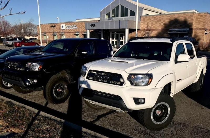

    Found a friend ... I've only ever seen a handful of Pros around town here so I had to stop & get a pic

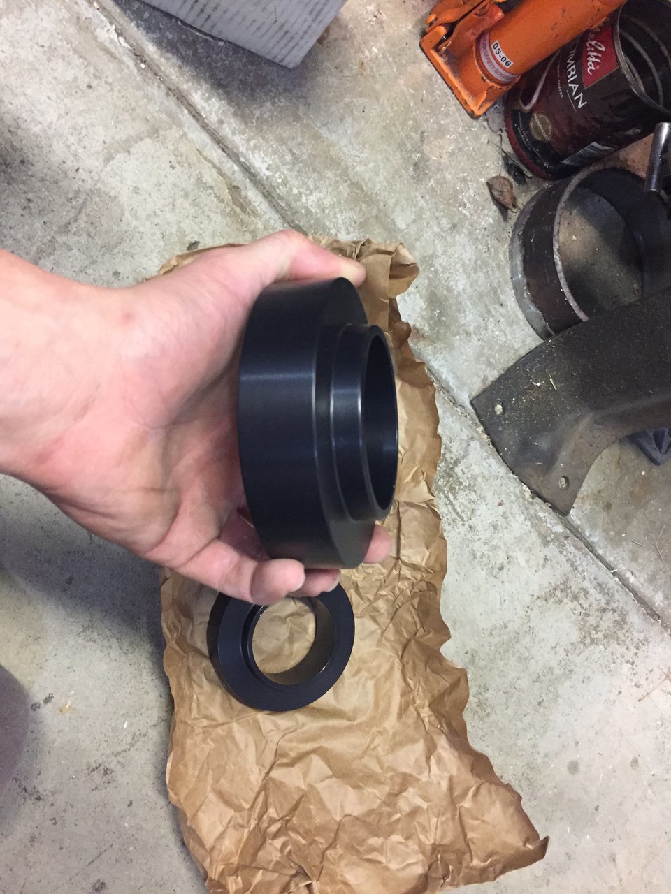

    Yea just make sure you can move the cams on the front control arms before you get too deep, they rust in place a lot.
    And I never use c clamps to do the aal, just jack the axle back up until you can put on the nut on the axle pin.

    I have never had a spacer lift on my truck, but the instructions themselves tell you how to clearly apply the puck whether they were intended for the exact hardware or not. Its good to keep these documents for the future as they are a decent breakdown in step form of how to remove your coilovers. Hopefully you have a tool to compress the springs or a shop to swing by for that.
    As far as removing the sway bar, if you have never removed it before...get some allen wrenches as you have to put an allen wrench on the side closer to the rear to keep the bolt that attaches into the spindle from moving around. Took me an hour to realize this cause I never looked into the bolt before hand.
    Good luck!

    Na you should be good. I had a buddy help with my aal install. Only thing that isn’t in that install write up is you’ll need to cut off the spring clamps on each side of the leafs on the truck. Nothing a angle grinder can’t make short work of. There will be one one each side....but can’t remember if they are on the front end of the spring (towards the front of the truck) or rear. If you hold up the aal next to the spring pack you should see what I mean. But it’s really nothing. The guy that wrote up the anytime dog mod...nds4 something did a write up in his build. I do believe it was him. It all is pretty easy
