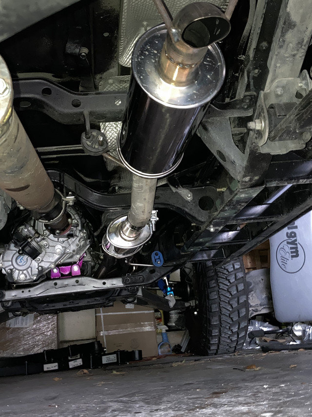

    Is that an aftermarket trans mount you got there?

    Yeah it's a solid off road mount have their motor mounts as well they add a bit of vibration but keep every thing from bouncing around...

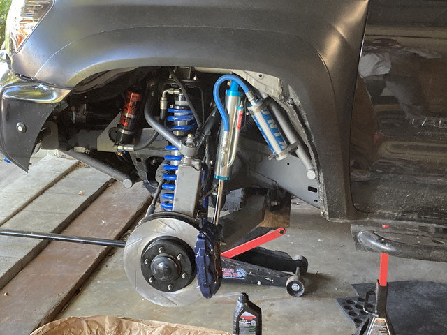

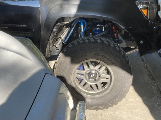

    Installed the Lexus GX 470 brake upgrade today went with Stop Tech rotors and factory Advics OEM pads. After bedding the pads and rotors I was surprised how well these slowed down the truck over the stock brakes. Great little brake upgrade for these trucks if you are running 17" wheels.

    Are these that much bigger than the stock Tacoma brakes?

    The Calipers have the same internals just the Lexus caliper is set further out to accept a 13.3" rotor vs the 12.56" factory rotors.

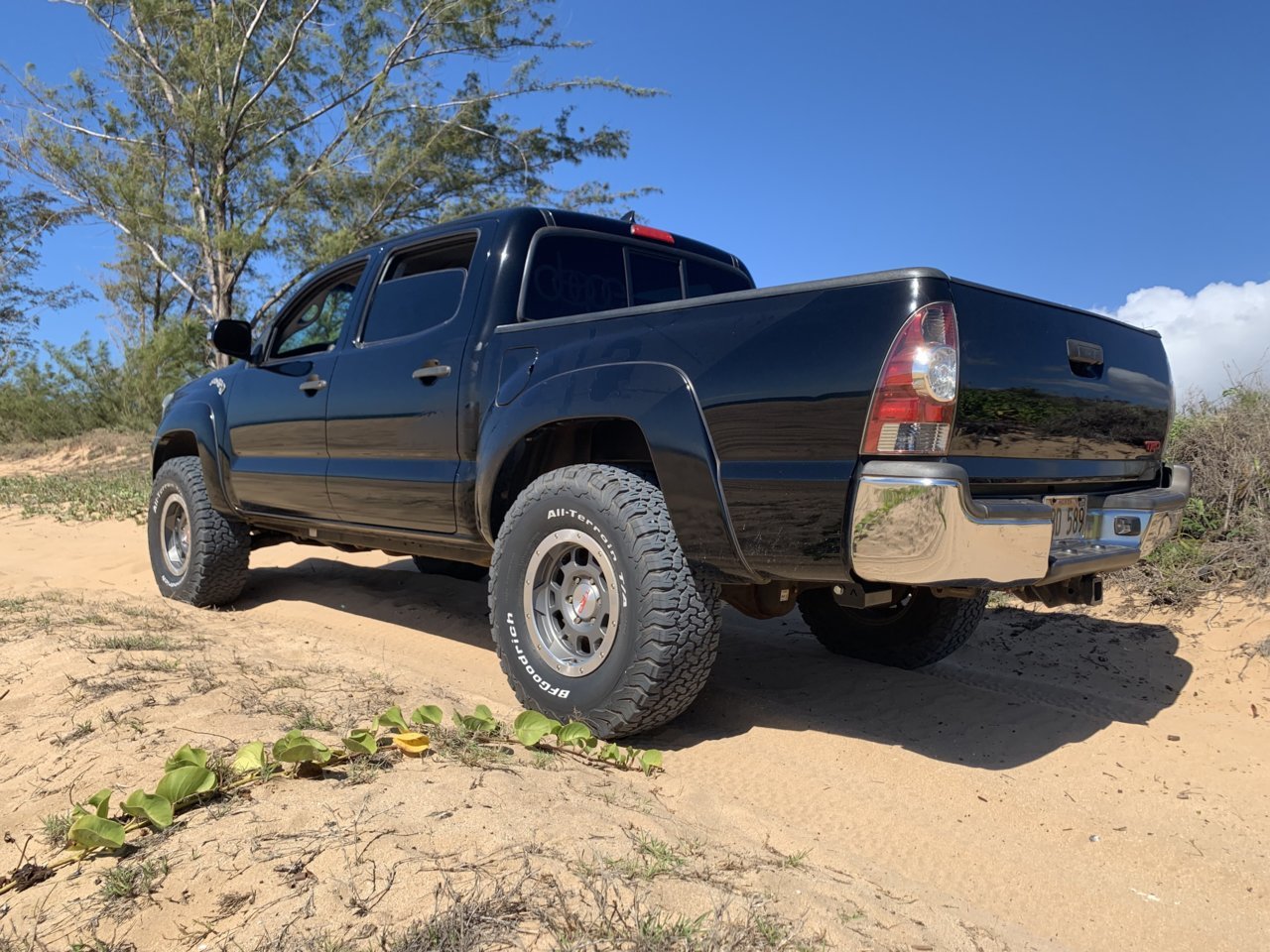

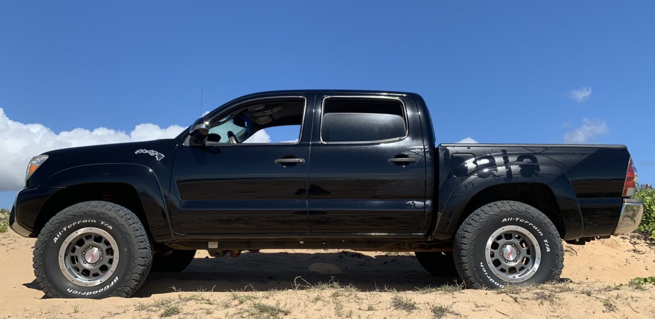

    Finally got to take my truck out for a jog. This is only the 2nd time I’ve taken it on the sand since getting the Archive Garage Hammer Hangers installed. I only noticed a slight difference on road but definitely more compliant for my type of “off-roading.” I contribute the “slight difference on road” to my E-rated tires.
    @04TacoRunner ^ there’s your orb again

    Do y'all ever fish from the surf? As an avid surf fisherman that looks Epic!

    Yup! Lots of people fish off the shore

    Looking great!

    Very nice!

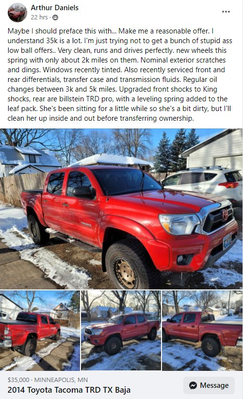

    Supposedly a 2014 Baja with 90k miles for $35k OBO. Very limited pictures though. Think it might be legit, but not sure. upload_2021-12-13_14-55-34.jpg

    Dang, with that thinking, I should be able to get $45k for my 15 TRD "pro" that has a supercharger and more.
    That "Baja" is missing a lot of the appeal of the front suspension and the lightweight faux beadlock wheels…

    With 90k miles on it Id be more concerned if it still had to original coilovers on it..
