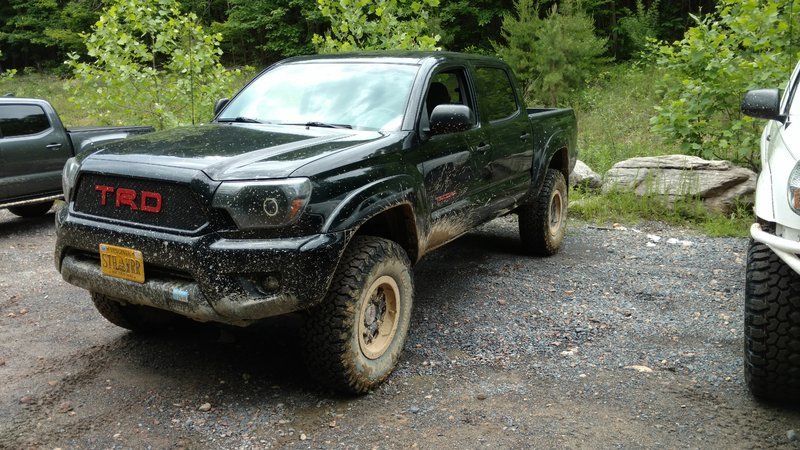

    Hey guys, figured I should introduce myself and join the Baja/Pro club. Just started becoming a somewhat active member of this forum. Went on my first group trail ride yesterday and it was a blast. I've gotten a lot of information about our more unique trucks from this thread and I really appreciate that from everyone.
    My current additions, suspension wise, are the toytec spacer, dakar leafs with extended breaklines and a ubolt flip kit. I have 285/75/16s KO2s and did not encounter any rubbing on my off road trip with having the front mud flaps removed.
    One thing I noticed that I may have slipped up on in my research is I did not get aftermarket UCAs. I had my alignment done at a toyota dealership, after the spacer/leafs were added, and they didn't express any concerns. Also when driving, I don't notice any problems. My question is, with my current setup do you think I should look into getting aftermarket UCAs? Thanks!
    Also, here is a pic of my truck after the trip yesterday.

    Welcome to the pack...
