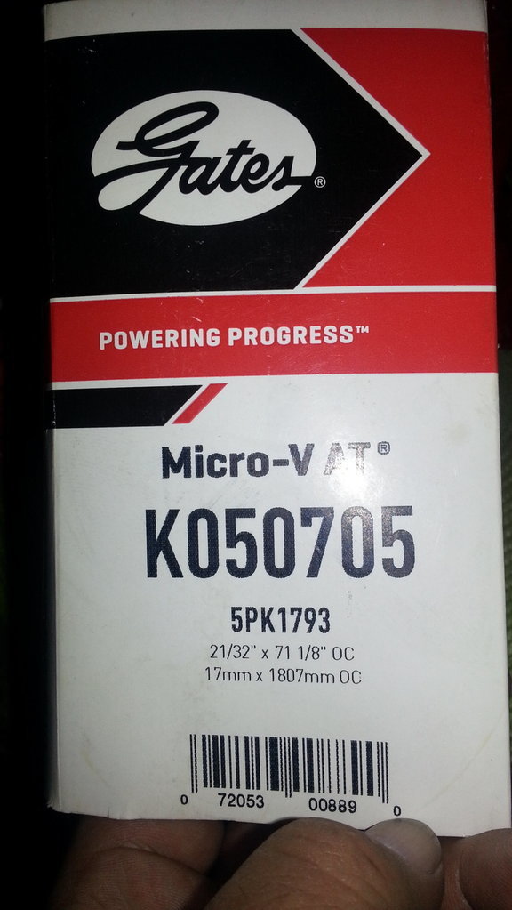

  15. Oct 11, 2015 at 6:19 PM
    #35
    BenMara
    BenMara That Asian RedNeck
    Apr 14, 2011
    #54903
    1,944
    Ben
    Belton, SC
    2011 DC 4x4 SCed
    TRD Blower, Ham Radio, DBA T2 Rotors
    the belt i used when replacing the SCer belt, no more squeaks
    sawjai526 likes this.
