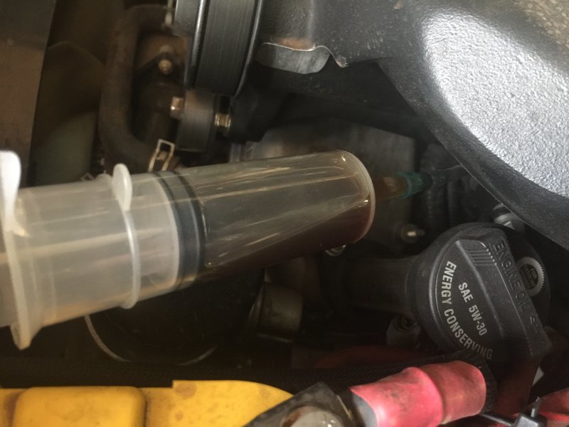

    V6 5sp,RegCab,TVS1320 Supercharger, 56mm pulley, methanol injected Haltech ECU, AC Tvs1320 supercharger,(MUST DO) every 125,000- 150,000 needs rebuild Projector headlights HID 5 speed manual Amsoil for all drive train Smaller 56mm custom pulley, (MUST DO) 2004 DESNO fuel injectors, zero ping ping, 2004 side door mirrors Dick Cepek Rims, Michelin tires LTX, ATM Pathfinders Dynopro ATM ( that last 100,000 miles) Now running Dynopro ATM mud and snow tires KN cold air intake Cat back dual exhaust with ss exhaust tip, Raised exhaust tail pipe to 2" below body line Optima*dry cell battery,red top Alpine sirius radio, 200 watt amp, focal is165 split door pod speakers Focal door speakers Subwoffer behind seat Viper alarm, Electric Locks Dark tinted windows, bucket seats corbeau lg1 Tacoma Rubber floor mats TRD fender extenders, Bilstien shocks, King shocks JBA UCA trailer iv hitch, electric brake control, Drilled slotted brakes, High carbon steel (MUST DO) EBS green stuff 7000 series pads(MUST DO) TRD engine oil cap TRD stick shift, Marlin crawl shift kit. Rear sliding window 2002 4Runner functional hood scoop cut into Tacoma hood, 4Runner dual overhead map light Gentex Auto dim + Compass + Temp, garage,rearview mirror Snow Methonal kit stage 2 Custom 3 core aluminum radiator Linex bed liner Haltech stand alone ECU, Intake supercharger gauge. Stainless steel brake lines, Custom leather wrapped steering wheel, Haltech stand-alone ECU,
    Great info, yup TRD says change oil every 100,000 miles, I changed my after 35,000 from a rebuilt
    and the oil it black as hell with black debris in the nose cone. I'm thinking every 25,000 miles the supercharger should have its oil changed, if the oil is this dirty at 35,000 it's no wonder the bears go out at 100,000,
    BTW you don't have to remove the supercharger from the engine to remove the snout on the grey units of you do an oil change, just take the snout bolts off and get a plastic bag and wrap it around the snout when you open it up.
    You have to remove bolts to the timing belt to do this, all except the one by the streeing pump and just pull back the cover a little to get to the nose bolts.
    I now installed a butt screw on the top of the nose snout so I can change the oil in 5 minutes in 25,000 miles.
    All cleaned up with carb cleaner

    I change the oil in mine every 20k or so as well, and it's pretty raunchy when I do. Can't imagine going 100k.
    The first time I went to change it after getting my truck, it was nearly bone dry :eek: Don't think the previous owner ever went through the trouble, even though it's super easy to do on the black TRD s/c. Got lucky that I caught it when I did

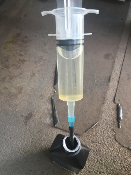

    Yea, maybe 20,000 is a better number, with the new butt screw installed it will only take 5 minutes from now on, do you use synthetic or the GM supercharger oil?

    The GM stuff, it's all I can find out here in CA. For some reason it's illegal to ship supercharger oil to CA, some dumb law prevents it. I did find it available on eBay though so I'll try that next time.
