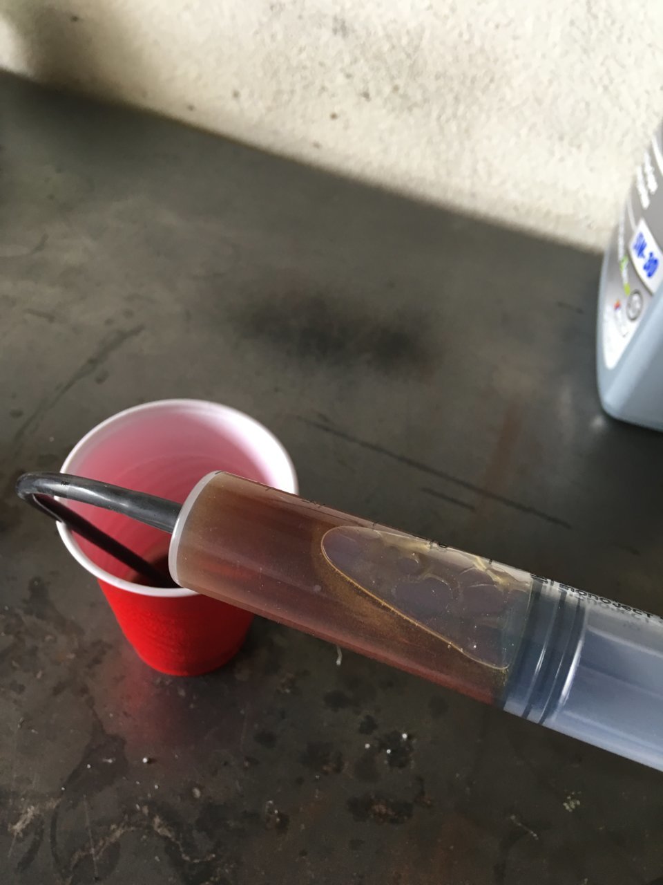

    Does mine look like it has excess oil? I thought it looked decent but I'm no expert.

    First nose drive oil change today. Around 110k miles (dunno cuz been running larger tires for too long)
    Think the oil looked damn good for how long it's been in there. Pulled just under 4oz out and took about 4.5oz before spilling over.
