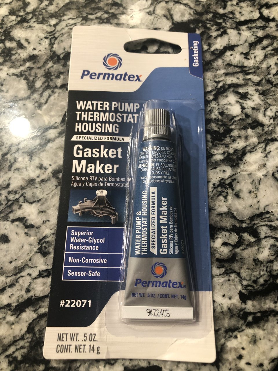

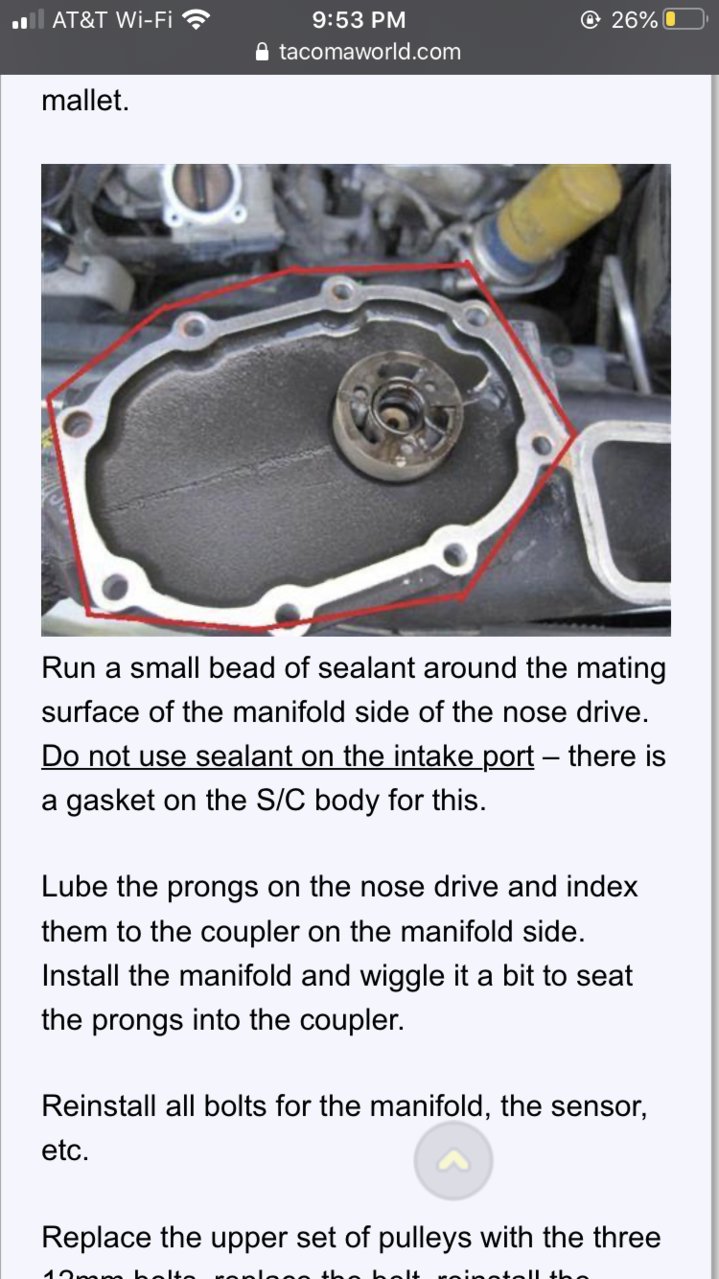

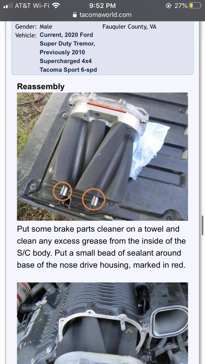

    The Couple Swap Kit comes with RTV Silicone. The directions in the images below is where i get confused. When the directions say “small bead of sealant” is that the RTV Silicone (Gasket Maker)?

    yes, that stuff in the tube

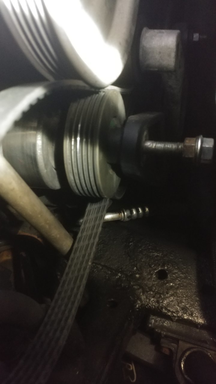

    Anyone have a clue how to get the bolt out of the tensioner bottom that has the 2 pulleys on it ? I got the bolt to back out to where I can see no threads and now it won't go back in or back out. I heard the bolt drop/shift during the backing out and all the stuff is slightly loose but won't come out.1006201935.jpg
