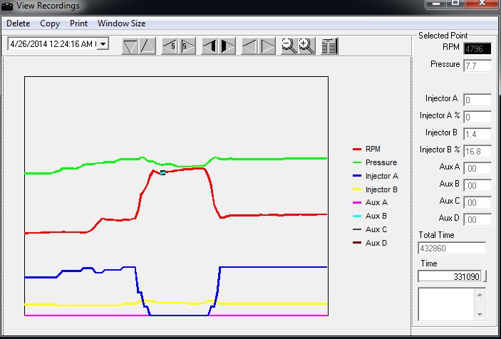

    Figured I'd come back to this since I still haven't quite figured out what was exactly going on. Plus I haven't had much time to tinker with the truck with work.
    One thing I did check was all the connections. I made sure I was getting continuity across the connection so there are no issues there. I also double checked to make sure I was spliced into the right wires. All good there. I also checked the injector to make sure there was resistance there. 12.6 Ohms on the meter. Double checked this inside the cab after the connection and was still getting the same resistance on the wires. So that's good to go.
    I haven't talked to gadget yet, but I'm going to email him in reference to this thread and also email him a spreadsheet with the current program in the ecu. I wanna make sure that the program that's in there is the one I'm suppose to have.
    I can also email it to anyone that would like to see and give me some pointers.
    I will get someone to ride with me in the next couple of days to see if i can't get a better idea of what's going on. May even try to get some video of what's happening.

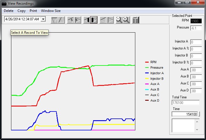

    This doesn't seem right. I had the recording on the R4 software while driving when I was going to be a full throttle pull from a rolling 45-50 mph. The AFR was around 13-14 but according to this the 7th injector quit firing?
    Anybody got any idea on this one.

    That's what I said :rant: The 7th injector is either designed to fire based off of the boost level or engine RPM; not sure - could be something else entirely. Whatever the trigger is, it appears that when your RPMs/boost reach a certain threshold, the 7th injector will SHUT OFF.
    Ill brake this down for you again :D
    -When in boost, your 7th is firing and your AFR is in the 11's. What you don't see is the ECU (if in closed loop) is trimming your primary injectors due to the low AFR readings. Its not noticeable as the 7th makes up for the trimmed primary injectors. Now, as I mentioned before, this shouldn't be happening as the tune (if it has an AFR tuner) should be skewing your AFR sensor input to the ECU during closed loop, making the ECU think you are still running a 14.7 AFR when you are not. I don't know how to fix this.
    -When your trans locks up the clutch, the RPM and boost drops a good deal and apparently this triggers the 7th to stop firing. The ECU is still trimming your primary injectors and doesn't adjust the trim immediately, causing your AFR to jump to 15-17.
    Not to be a dick, but as I said before, you need to bring this up with URD/Gadget. I dont think you will get a whole lot of help here.

    I more so posted the screen shots so that I can have gadget see them and give him an idea of what it's doing.
    As far as the AFR calibrator, I don't have that. The AIC-T doesn't allow tuning in closed loop mode, which i'm assuming is where most of this is happening at. I can't tell because i don't have anything to tell me if the truck is in closed/open loop mode. It might be that I need to get a AFR calibrator to be able to tune in closed loop mode so that the truck thinks it's at 14.7 AFR and doesn't lean out.
    The fuel injector from what I can tell is firing based on RPM AND Boost. But as you said, it seems as though mine is actually cutting off during a hard pull. I'll see if I can't get ahold of gadget tomorrow and see if he has some insight for me.
