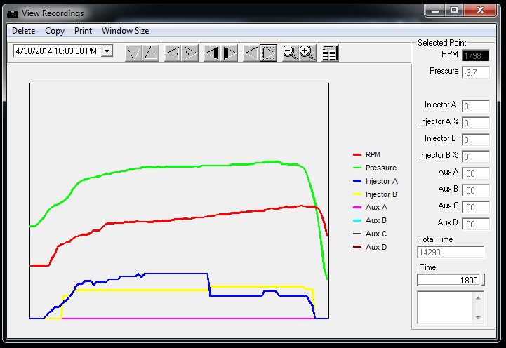

    Also, I pulled this. Notice how the injector fell off. It only did this one during a pull, but as soon as that injector quit firing, AFR skyrocketed. My only thing, I'm not sure what Injector A and what Injector B are and which one is actually the injector. Those 2 lines don't really make any sense.

    You would know if you are getting pinging. Generally the 5VZ will ping at low RPM's/high output (accelerating in 4th gear). If you are getting this, I would try to retard timing at those RPM's. You will lose power, but better than loosing a connecting rod.

    Your primariesare probably being trimmed as I mentioned before. For themost part, your 7th only fires in open look and the AFR readings shouldn't affectthe ECU but as mentioned before, ina higher gear, you can start seeing boost, and subsequently the 7th will startfiring, while in closed loop. I’m still convinced you just need the AFR tunerto fix your issue.
    I am pretty concerned with that drop in fuel pressure on the graph above and not too surewhat would cause that drop. If you haven't done so already, disconnect the negterminal for a few minutes to reset your ECU and it will remove any fuelinjector trims. Run that test again and see if reseting the ECU makes a difference. If the primaries injectors stop dropping off and fire correctly,that would suggest they were being trimmed by the ECU due to the AFR readingsfrom the 7th injector.
