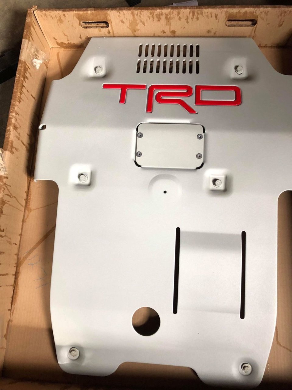

    I took advantage of the TRD 40% off sale last week and thought I'd do a write up.
    Step 1: Pick up skid plate from dealer and drive it home.
    Step 2: Pull skid plate out of the box.

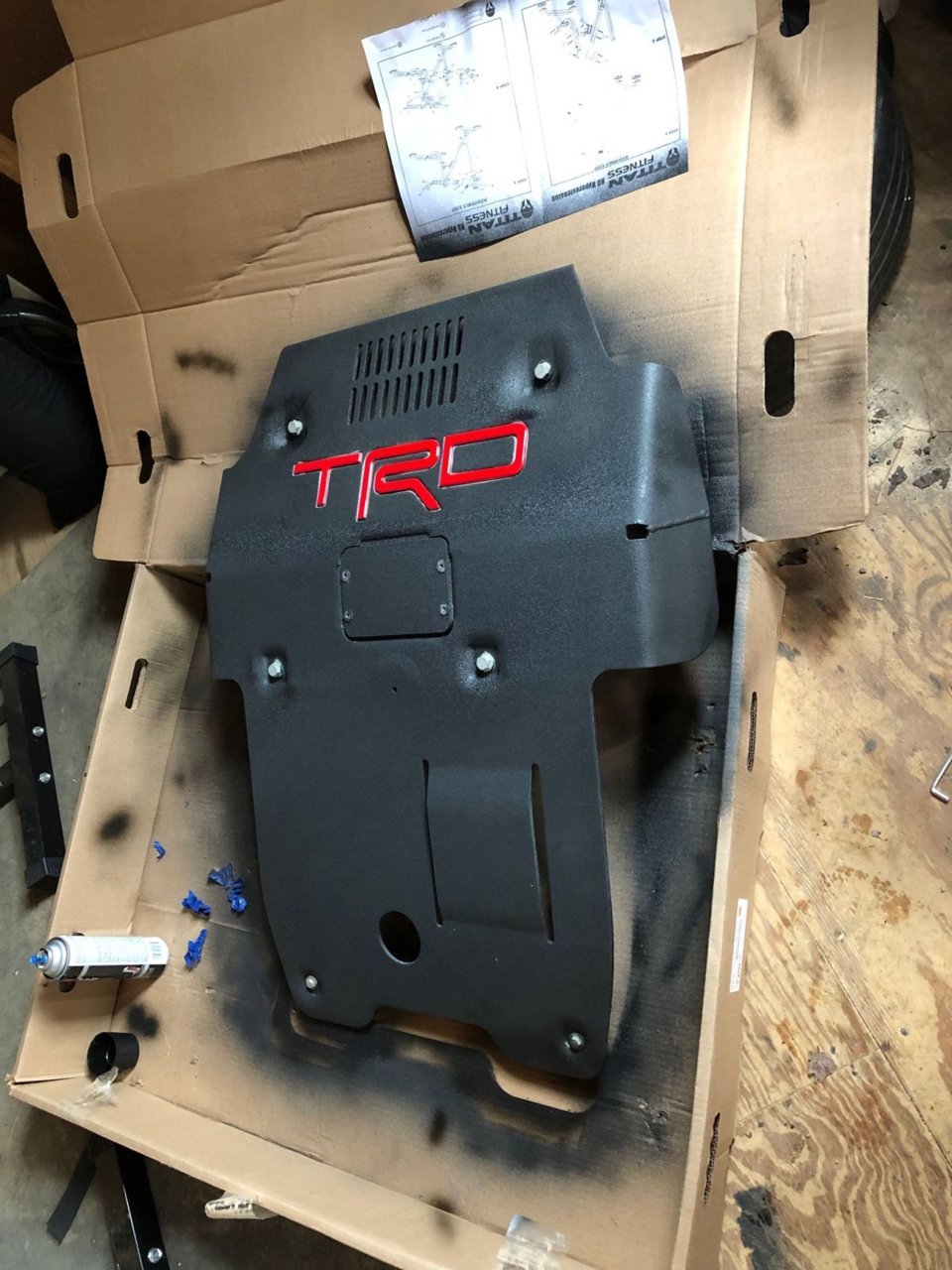

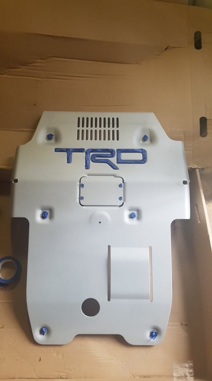

    Step 3: Get 2 cans of Krylon Spray On Bed Liner on clearance at Lowe’s.

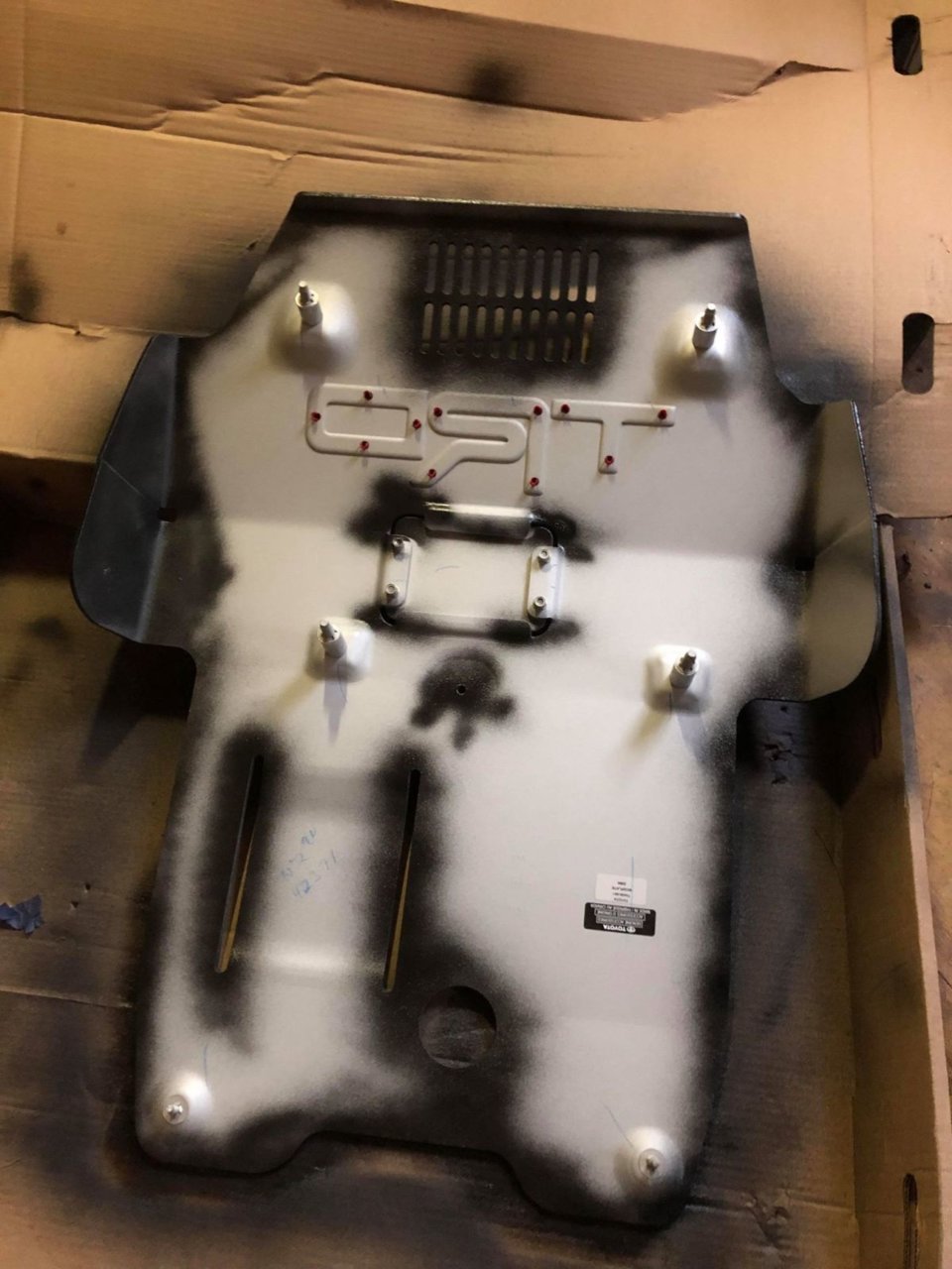

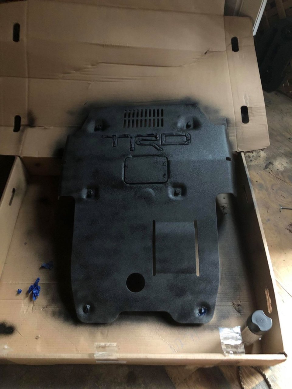

    Step 4: Tape off red “TRD” lettering and hardware. Spray 4-5 light coats, letting each dry 20 or so min in between (or whatever you can recommends). Spray the back if you want – I got the edges and any open holes.
    Step 5: Let dry/cure for at least an hour (or whatever the can recommends). Remove tape.

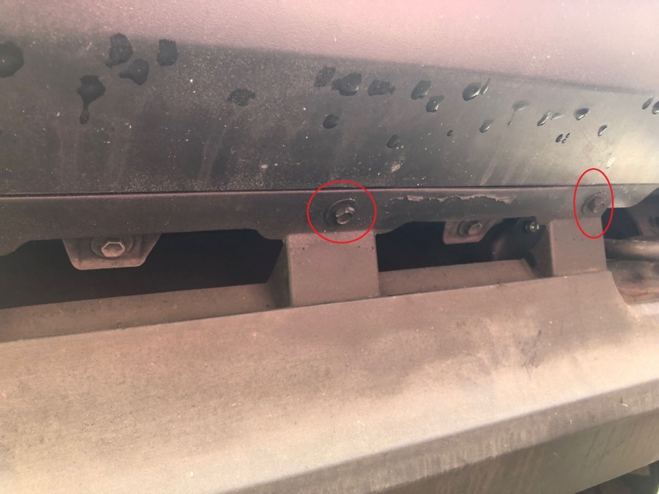

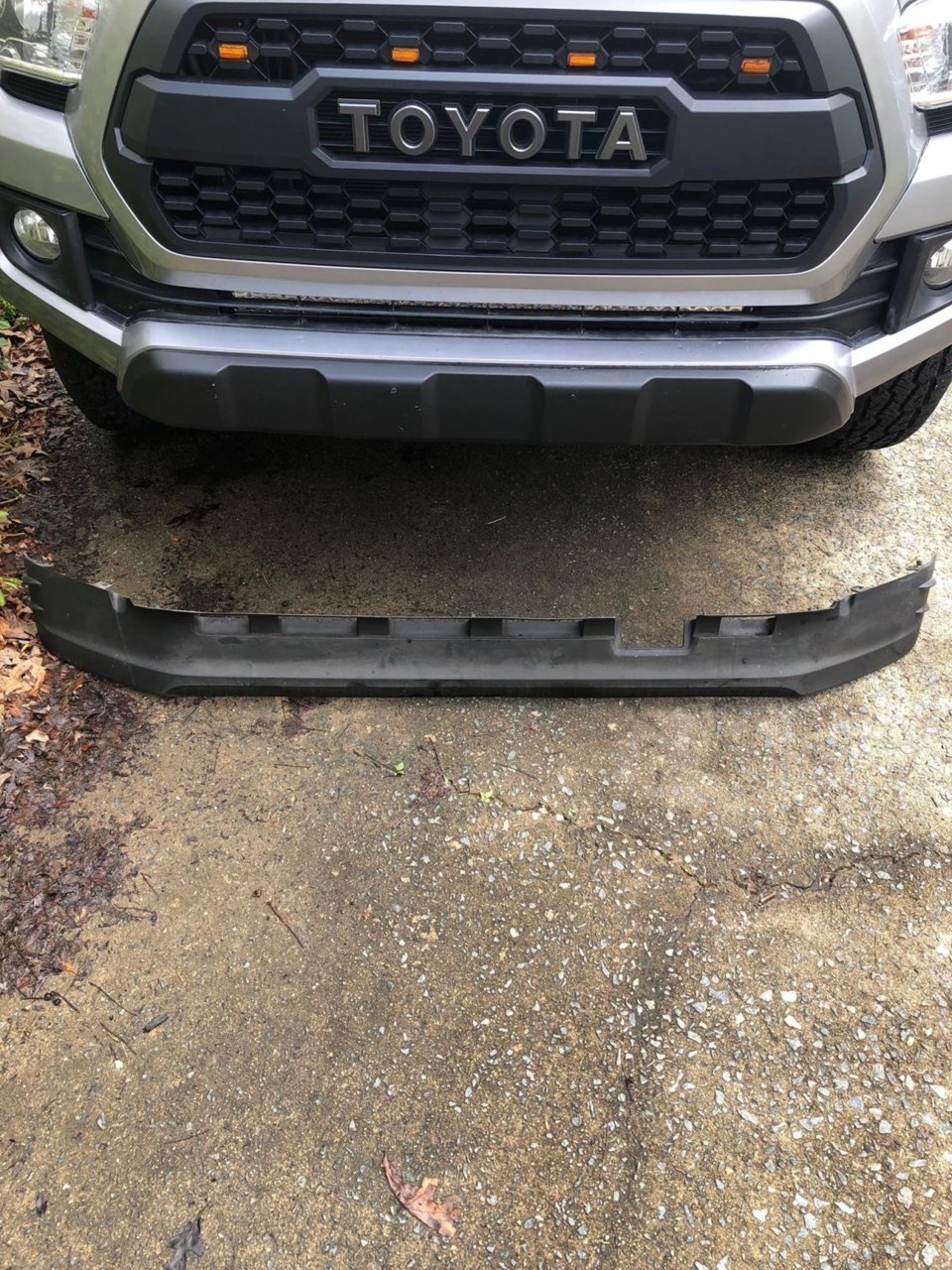

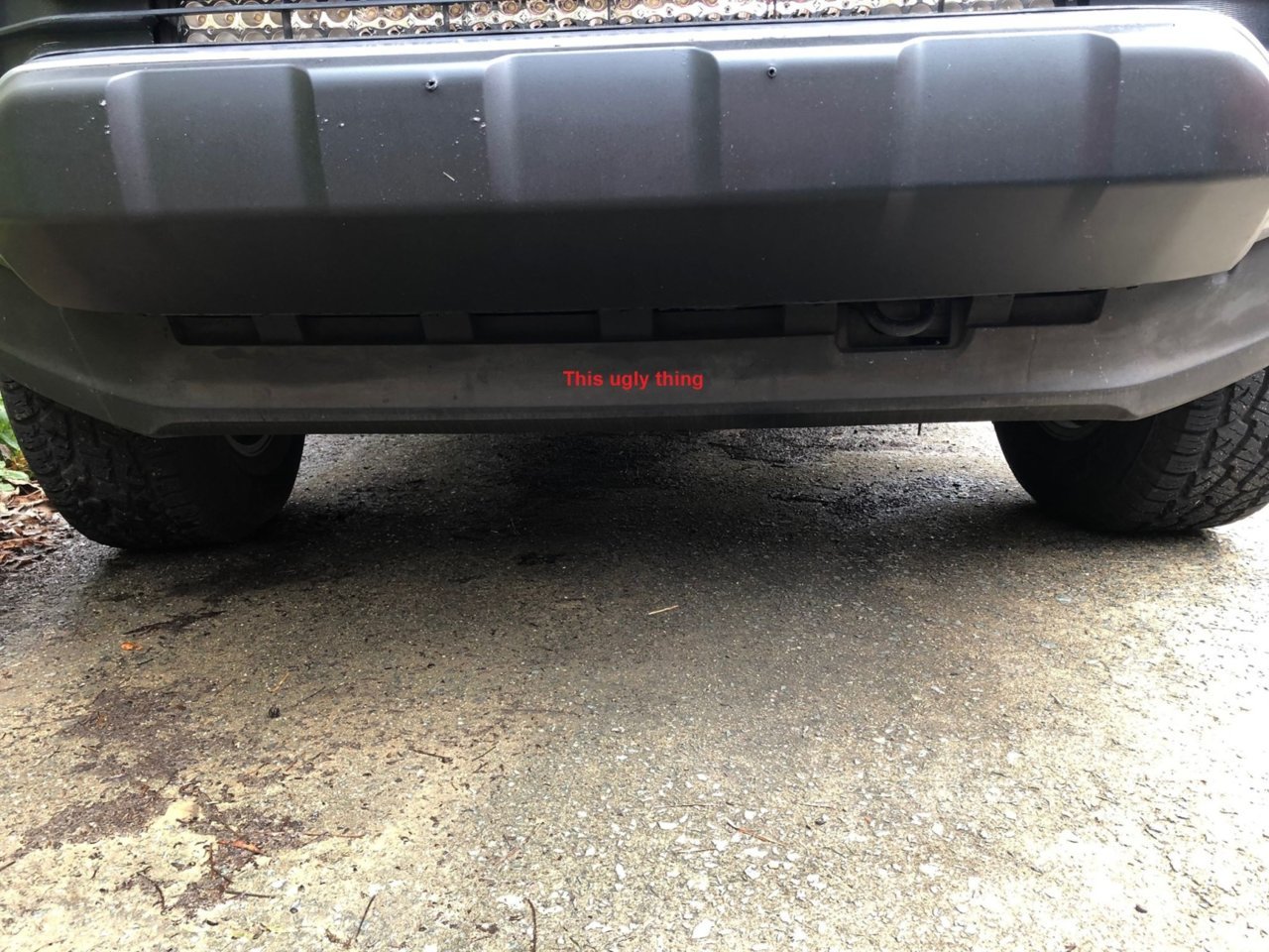

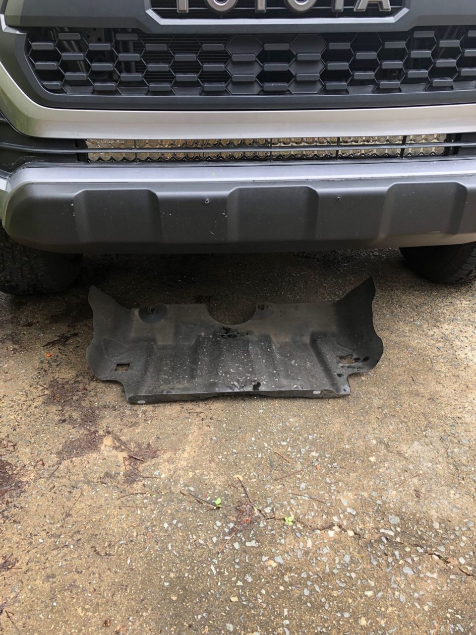

    Step 6: Remove ugly chin spoiler. I believe there were 11x10mm screws. There are some on the backside of the corners. Save all the screws and the clips - they’re going back in to keep the highway wind noise/whistling down.

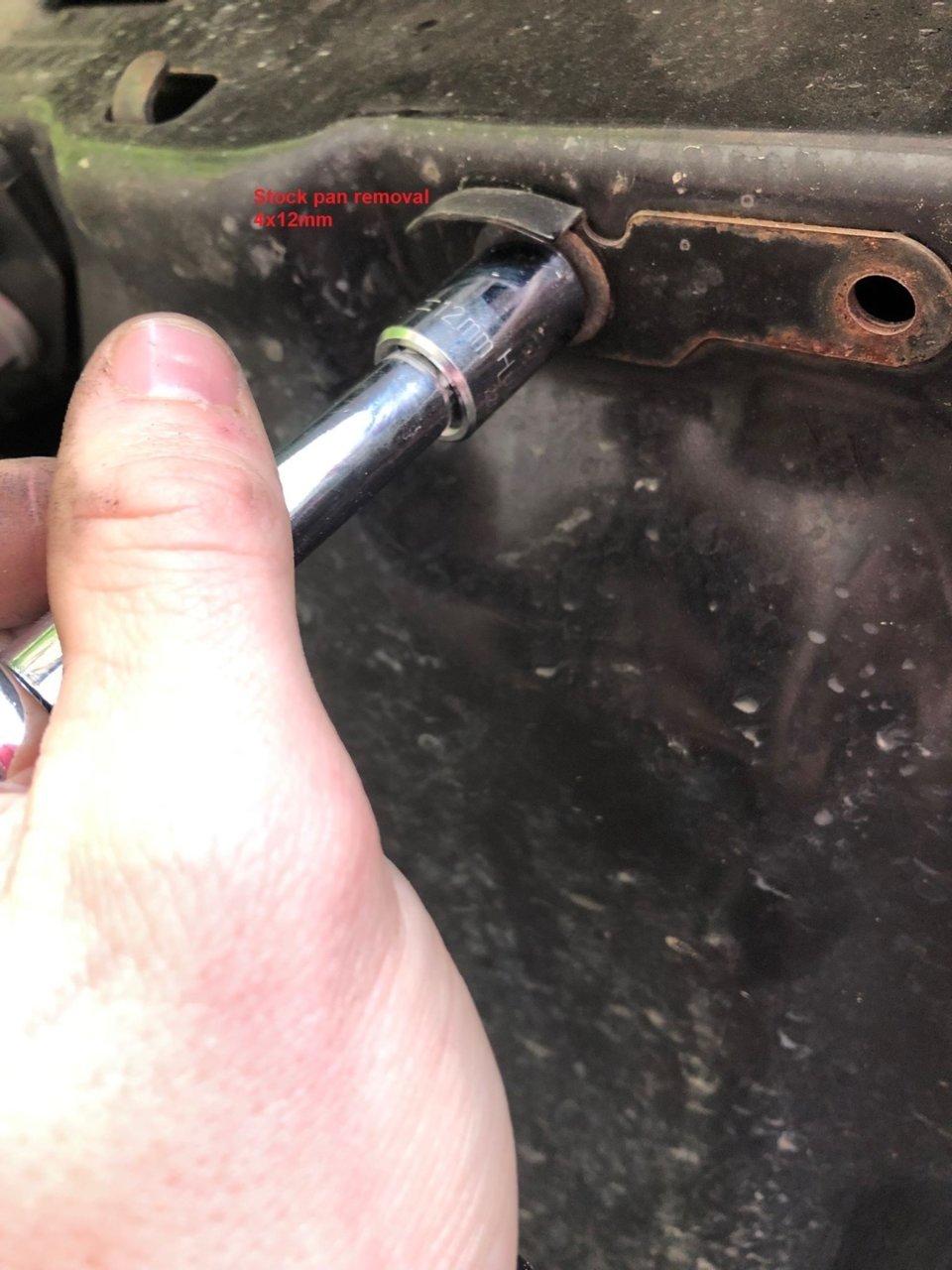

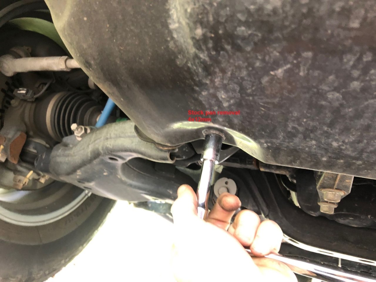

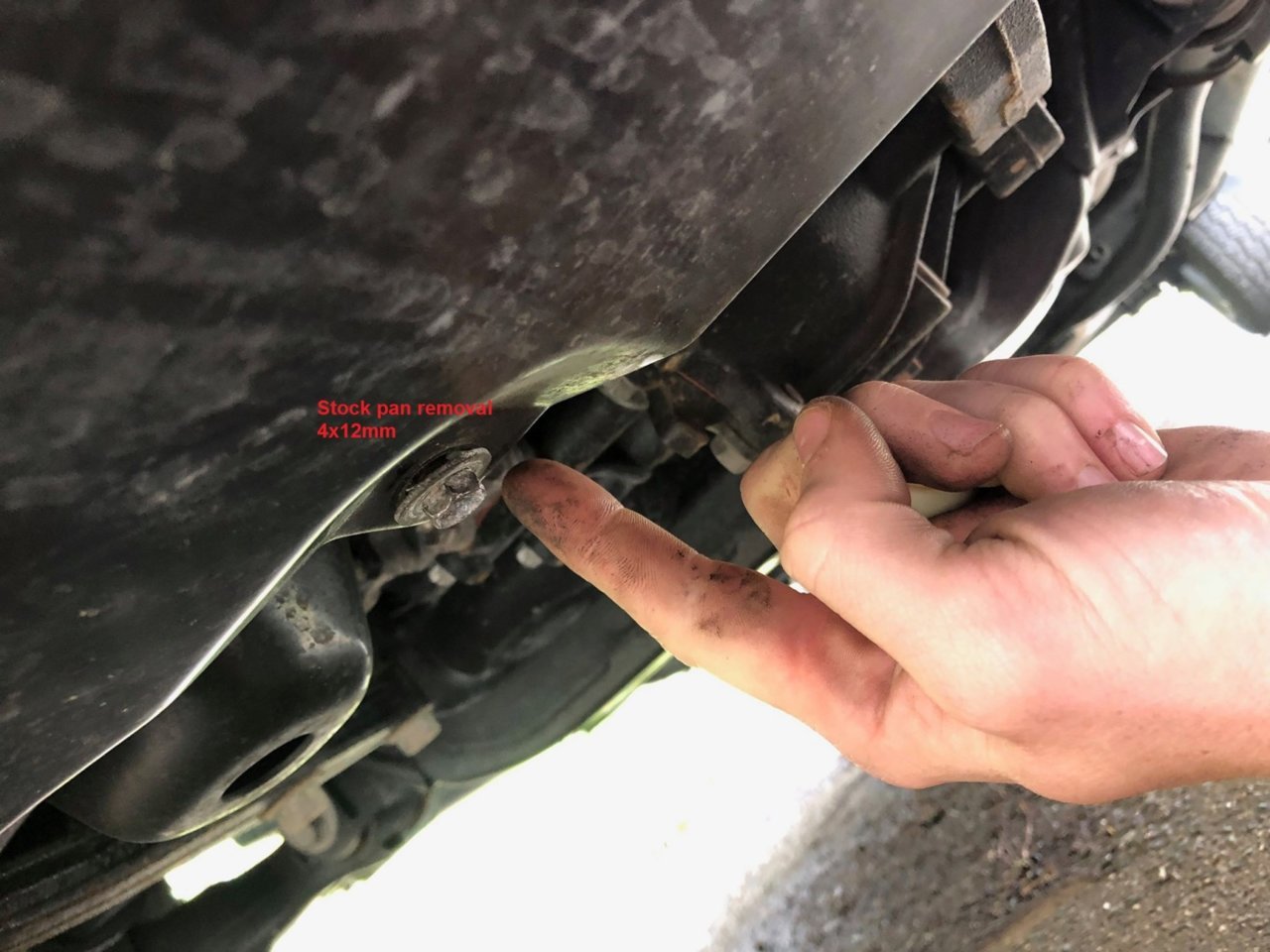

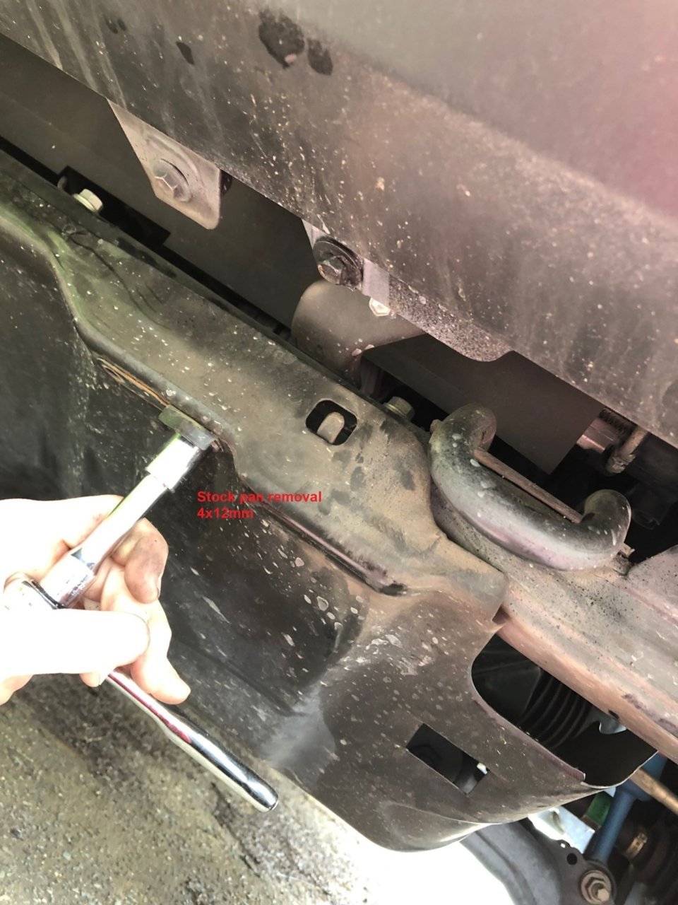

    Step 7: Remove stock pan. There are 4x12mm bolts.

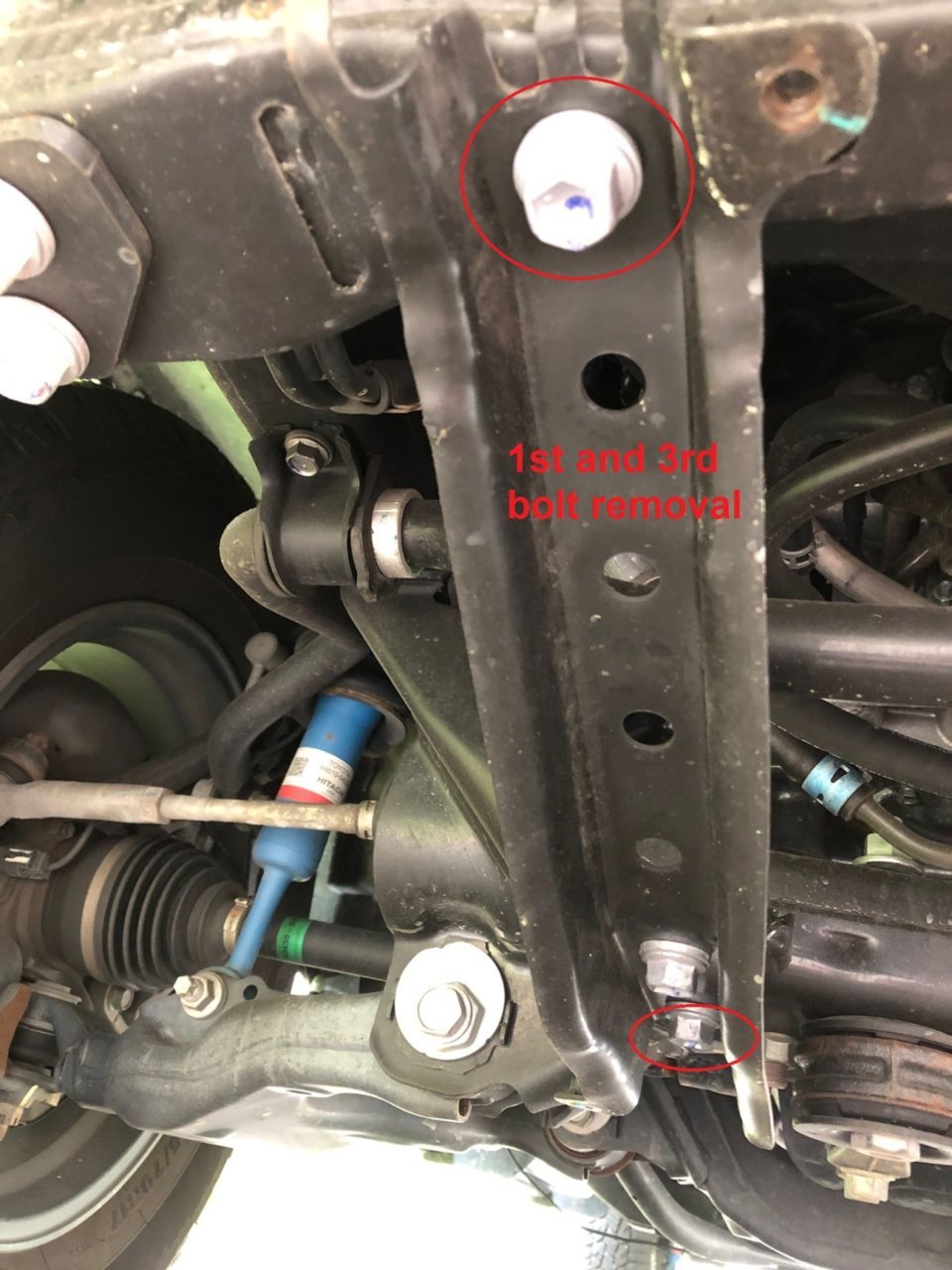

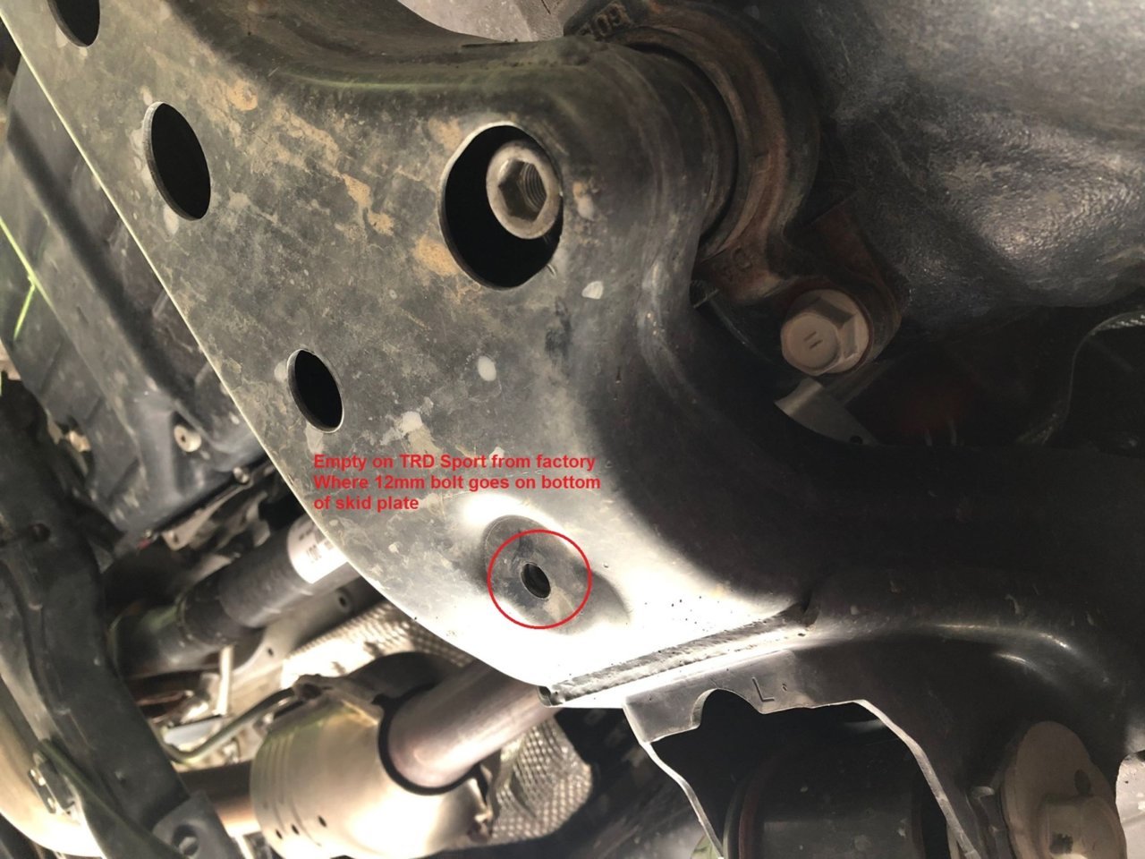

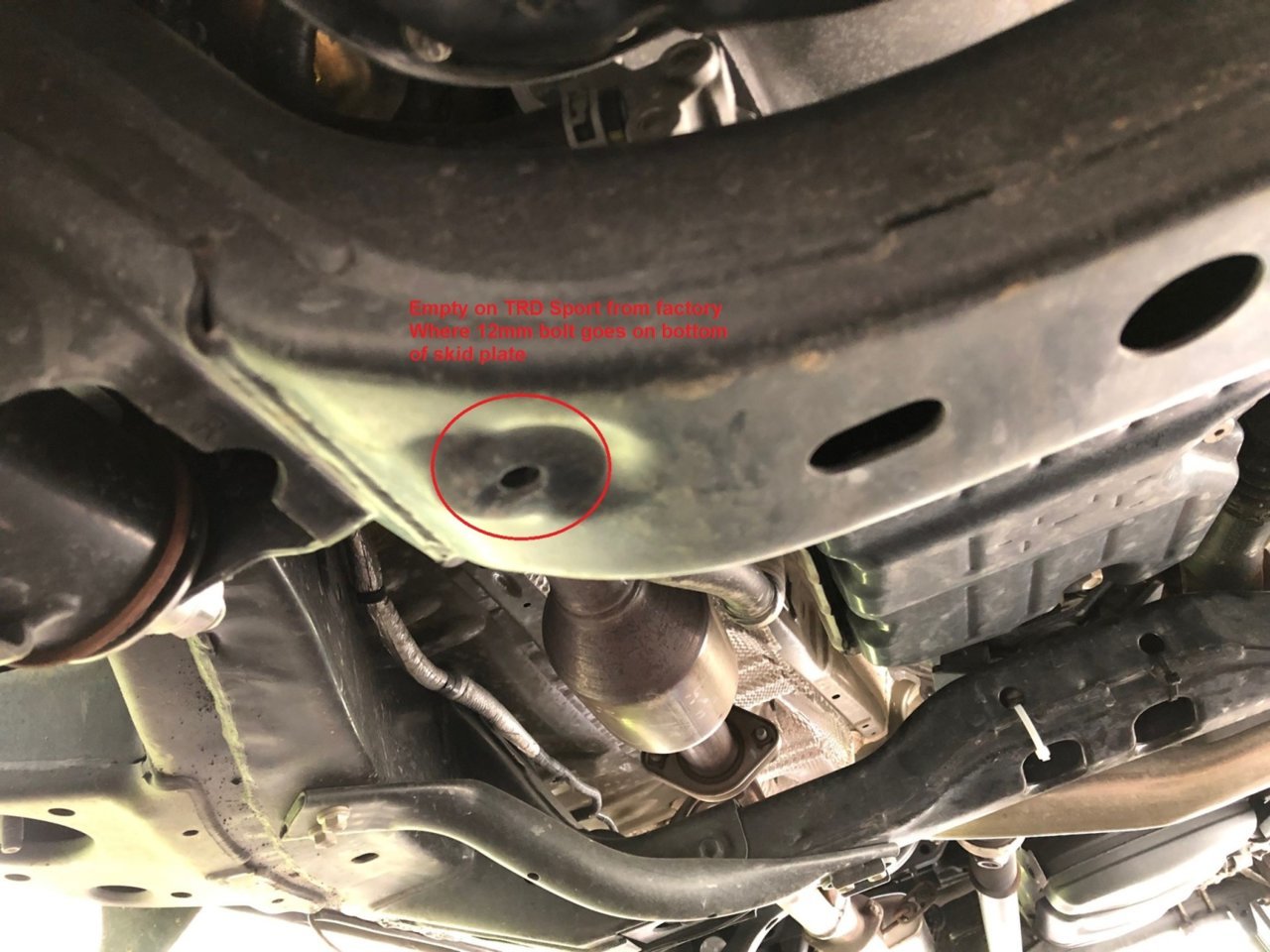

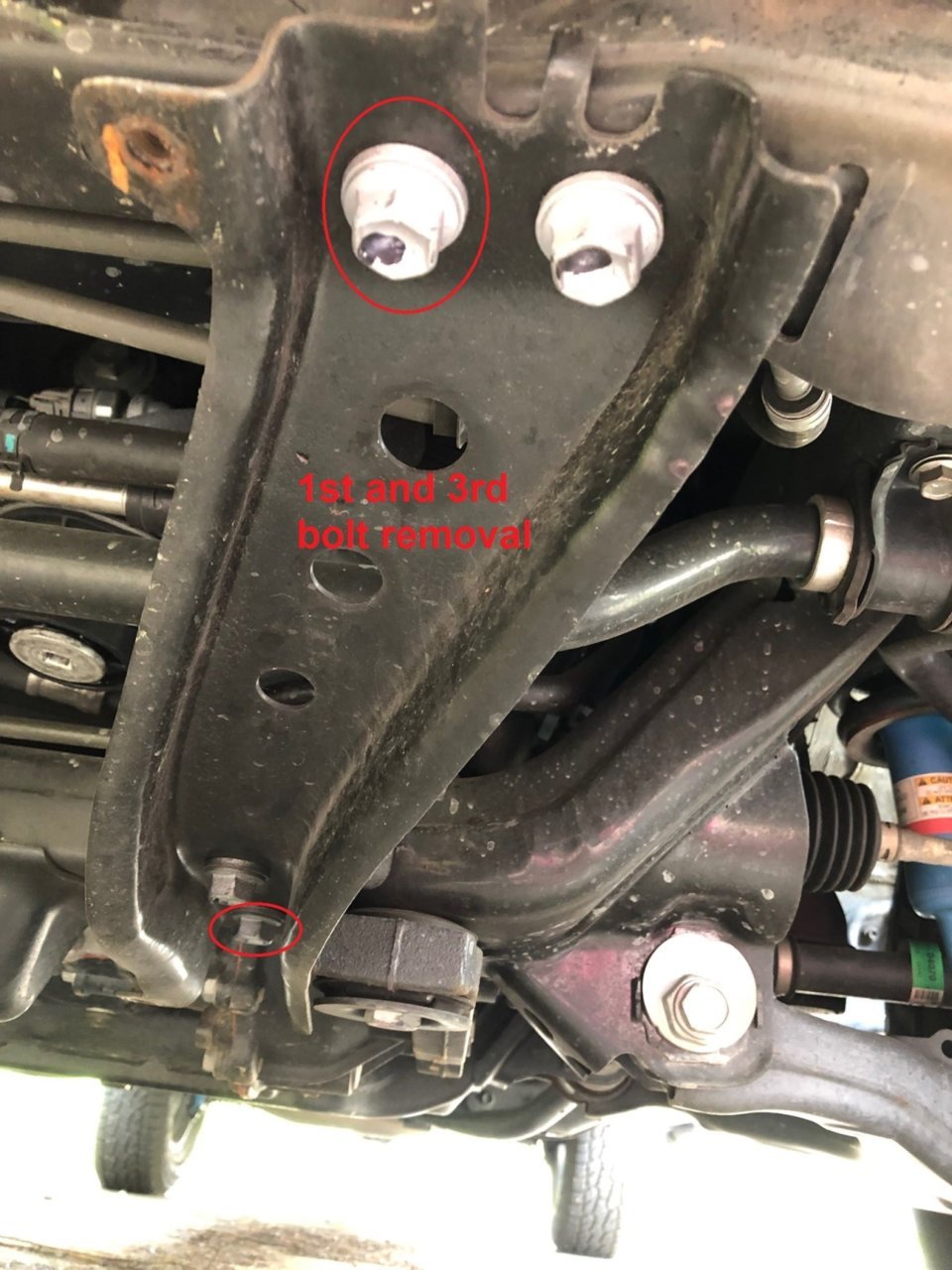

    Step 8: Remove 4x17mm bolts (skid plate hardware will replace). Get a sight on the lower 2x12mm bolt holes (they’re empty from the factory).

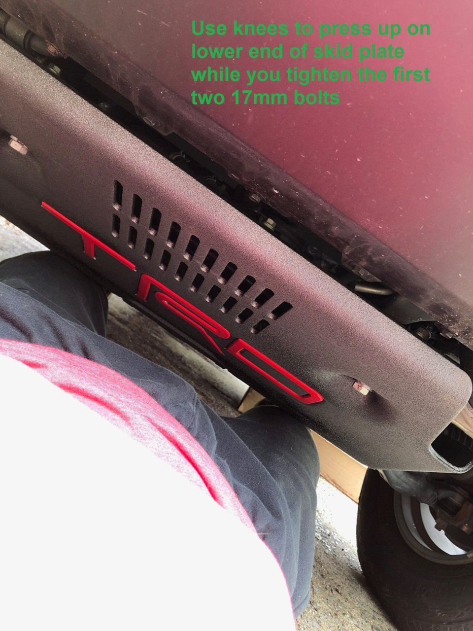

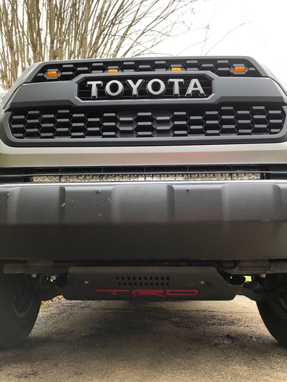

    Step 9: Lay down with the skid plate on top of you (DISCLAIMER: don’t do this if you can’t lift skid plate by yourself… it's 34 lbs). Using your knees to press the lower part of the skid plate up, tighten the first 2x17mm bolts, then the middle 2x17mm bolts, and finally the 2x12mm.
    Step 10: Enjoy.

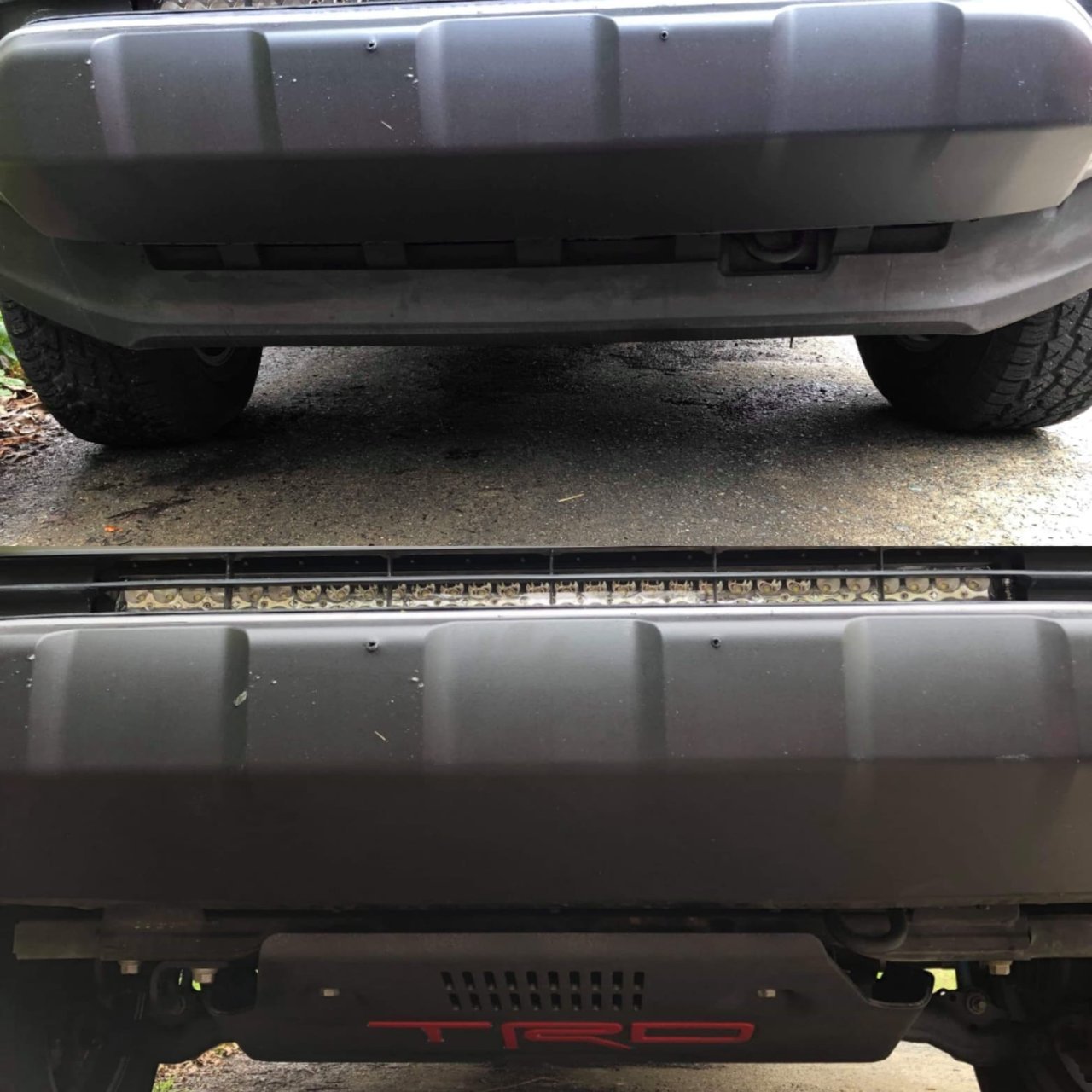

    Stock vs upgrade

    Looks beastly, glad you got rid of the chin strap.
