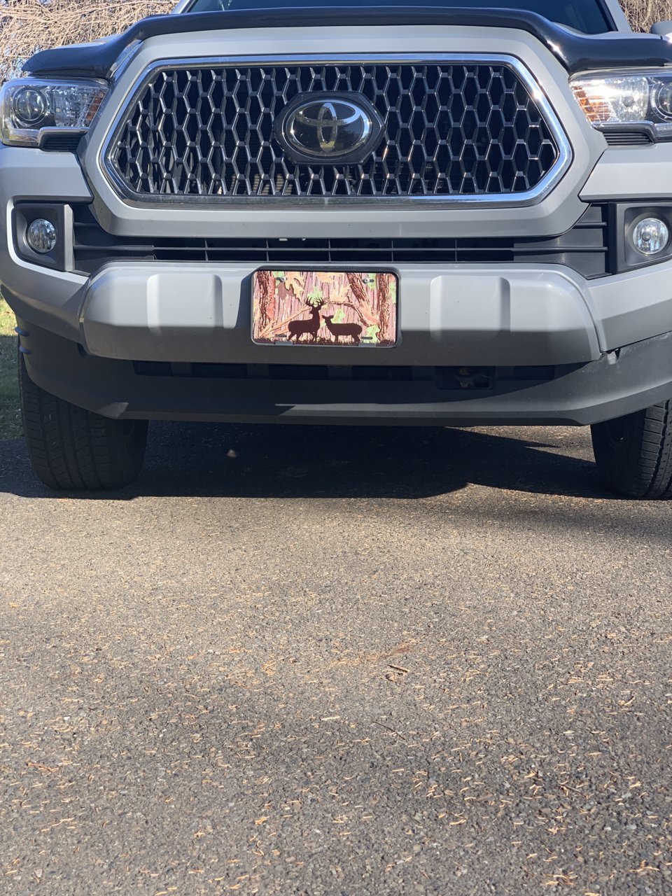

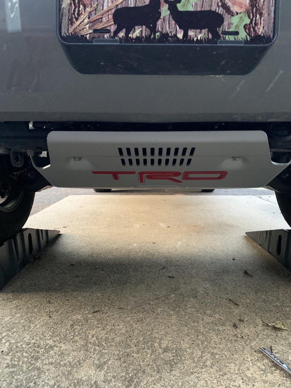

    You will have to modify the air dam to put it on with the TRD skid plate. (There are pics somewhere on the forum of the modification.) I personally do not like the way it looks with both the air dam and TRD skid plate installed but that's a personal preference. I would go with one or the other. Here's before and after on my truck.

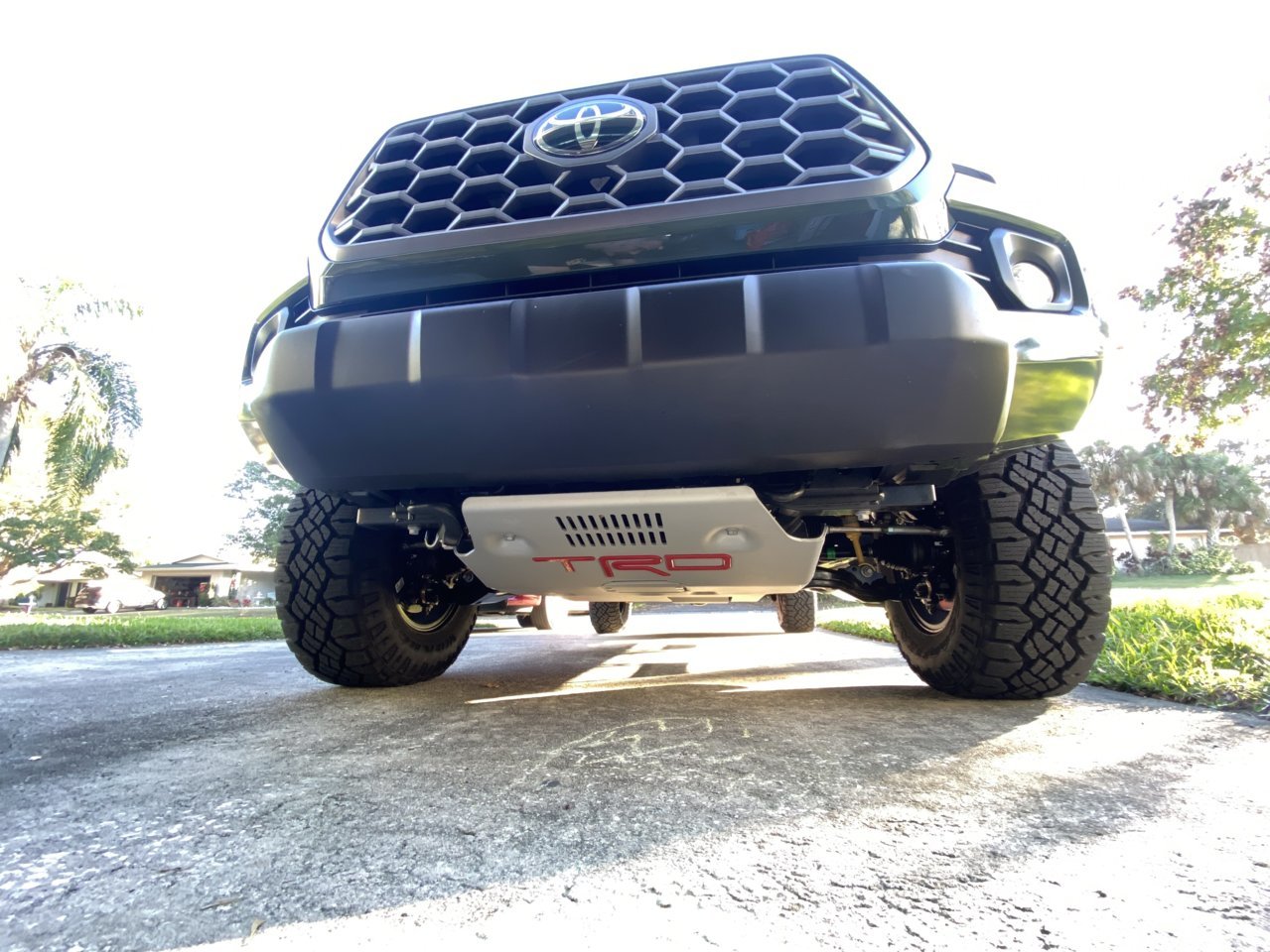

    I recently bought a 2020 TRD Sport and Santa got me a TRD skid plate. It looks good, install was relatively easy including removing the front chin, minus one bolt that wanted to be difficult for the new plate. It looks good, heavy you’ll get a work out laying on your back holding it in position, but most of all I’m looking forward to not having to remove the skid plate just for an oil change!
