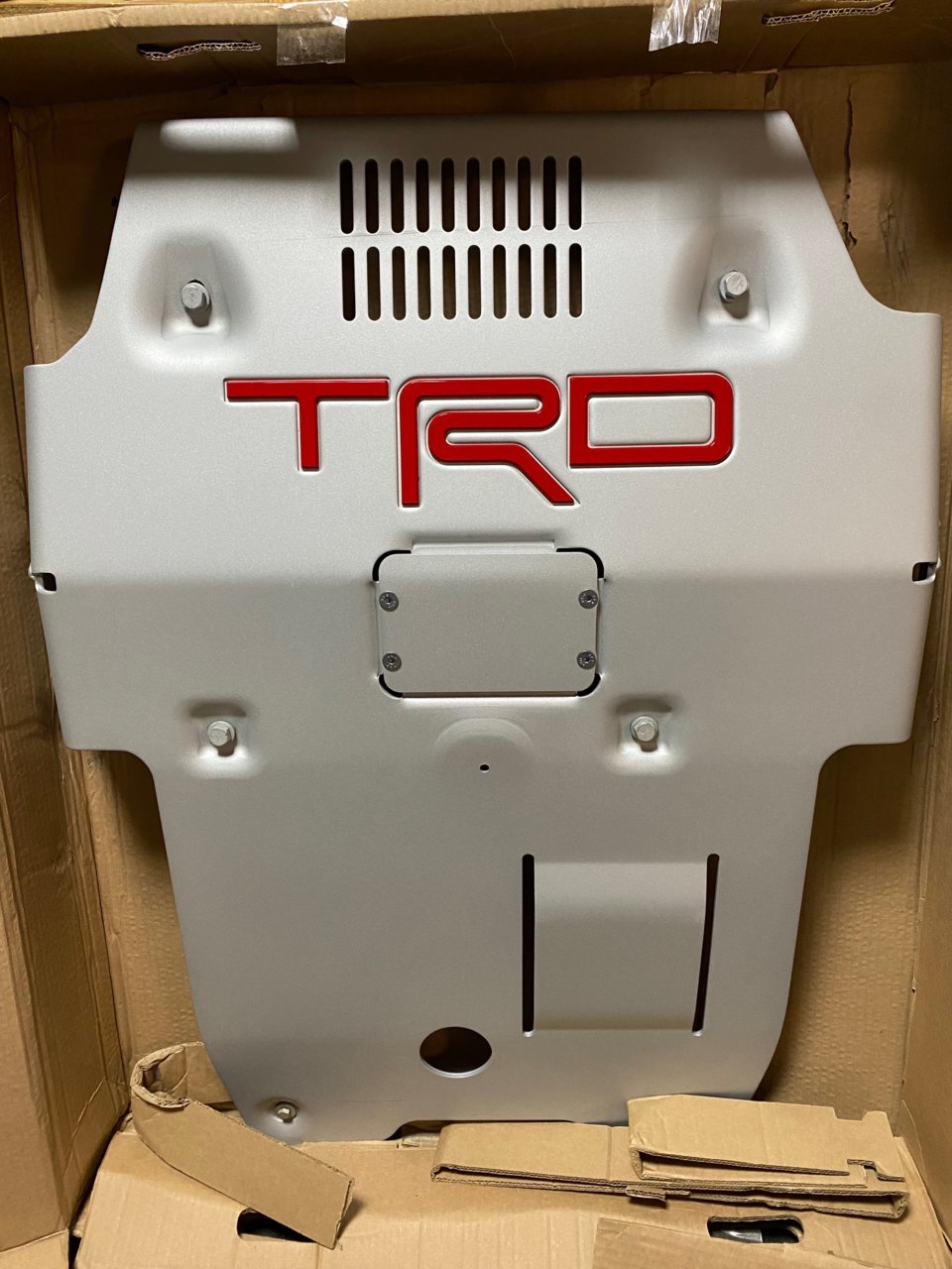

    I just received my new TRD skid after the 20% off sale earlier this month... (price was way too good to pass up) - What a beaut!
    Unless it's hiding under a flap of cardboard - it came with no instructions...I admit I've not really thoroughly looked around the box, so it could be there. I've seen a few videos and know there are some bolts that need to be removed...not including the ones for the old factory skid.
    Any pdf instructions out there?
    More importantly - any tips for a successful install? I've seen here to be aware of torque settings.

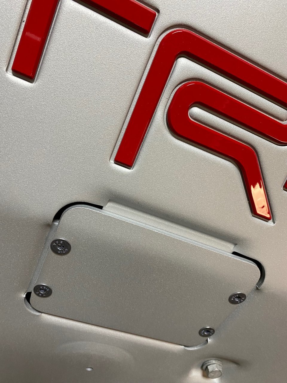

    One quick tip; take a 5mm (I think) allen wrench and loosen the allen screws for your filter trap door. Mine were on there tighter than a virgin's honey pot from the factory. I coated mine with a dab of anti-sieze and reinstalled before I mounted the skid plate to my truck.
