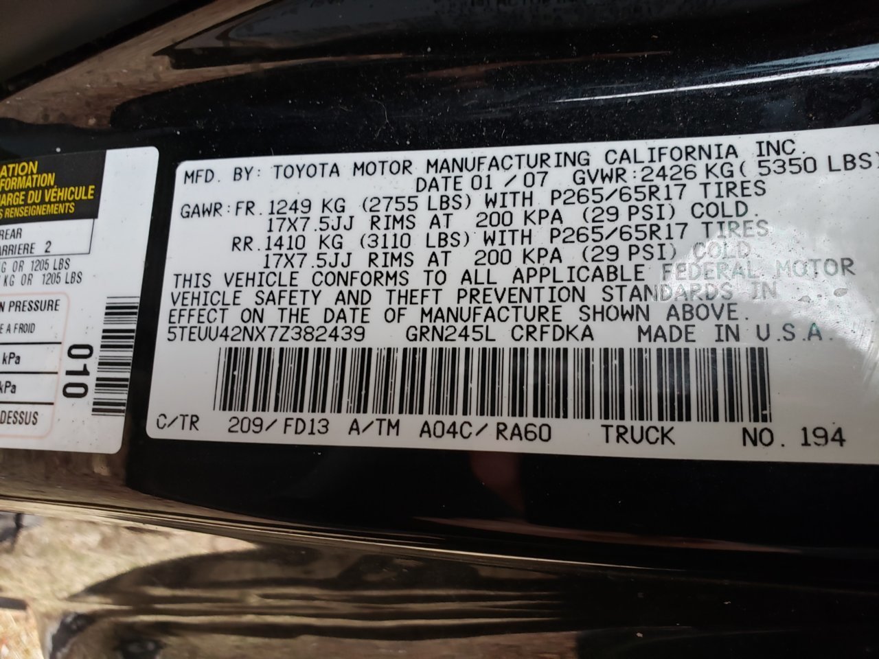

    My GVWR says 5350 lbs. Is that right?
    And I do have the 6 pin connector in the rear

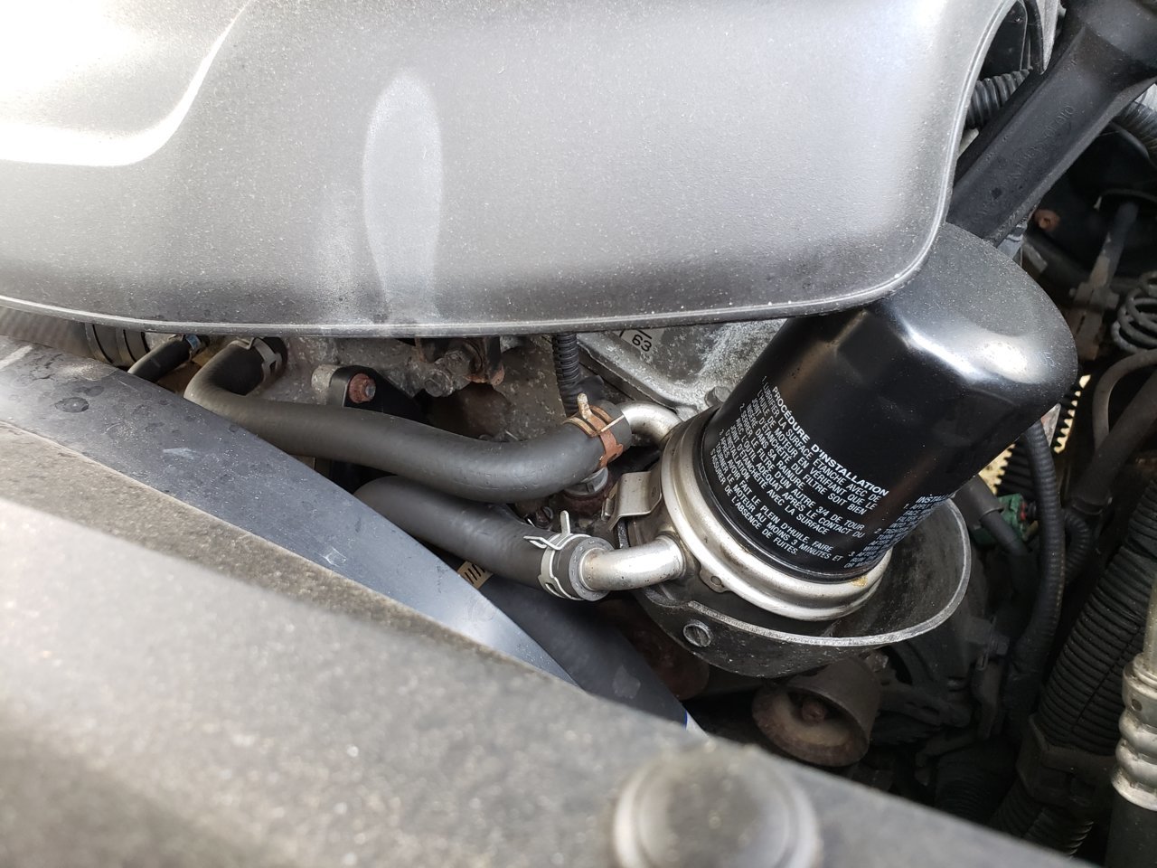

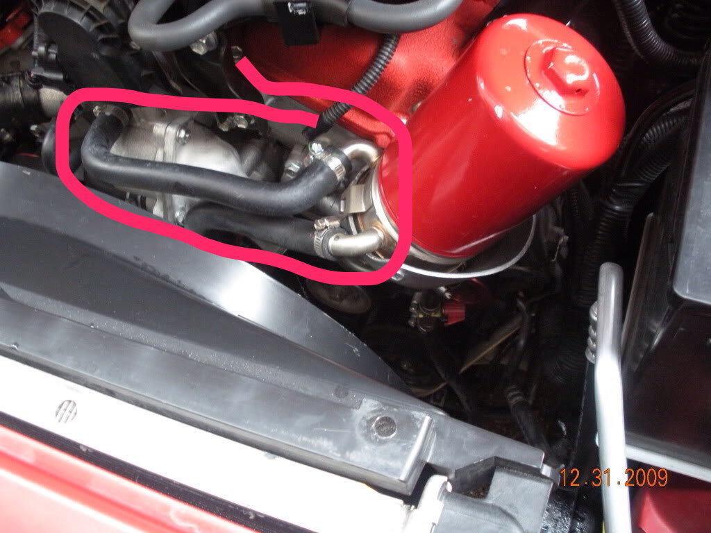

    Pop the hood and look for this. If you have this, you have the tow package. There are many opinions about towing a trailer that heavy with a Taco, but 60% of TW members will tell you that’s too big and too heavy.
    TnShooter likes this.

    Yes I do.
    Oil cooler, right?

    GVWR is gross vehicle weight rating and should be around 5600 for double cab, GCWR is Gross combined weight rating and is the 11360 people talk about

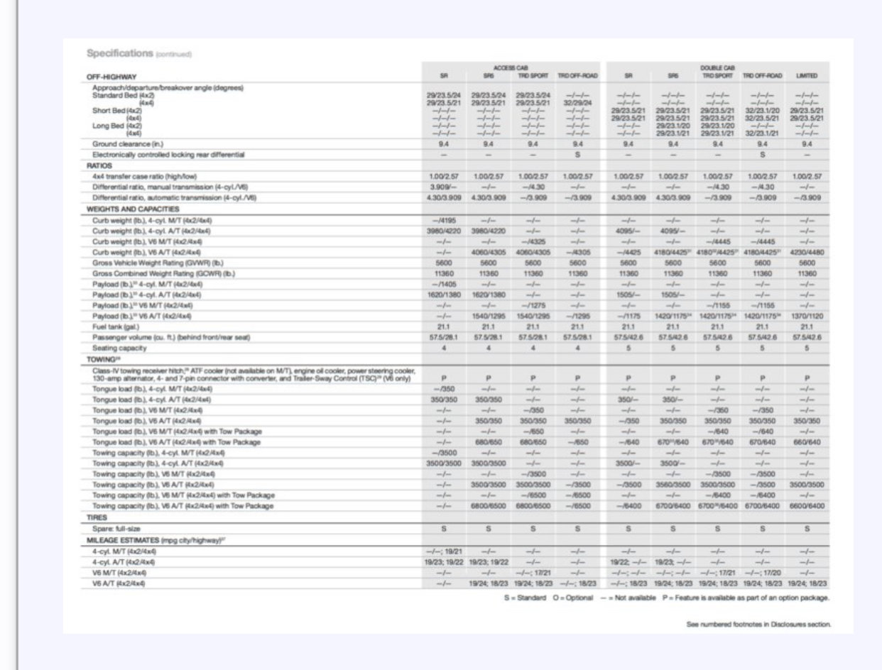

    Here is a list

    Right. Thanks. Was wondering why that wasn't on the sticker. What's GAWR?

    Gross axle weight rating, you will have one for front and one for rear and they won’t be the same. That shouldn’t make much of a difference in tow between Mt and AT on paper, in real life your doing the work and not the truck so take it easy and your fine. I have towed minor stuff with the Tacoma and bigger stuff with a auto 350. Take your time and don’t rush/ feel rushed by others and you won’t make mistakes and will be fine

    Towing capacity is the same for AT and MT on a 2007: 3500lbs without tow package, 6500lbs with tow package. GVWR is also the same for AT and MT on a 2007: 5100lbs for reg. cab, 5350lbs for acc. cab, and 5450lbs for dbl. cab.
    Tow package includes the factory Class-III hitch, 7-pin trailer wiring (with trailer brake wiring excluding the controller), larger battery (if not equipped with the Cold-Area spec), 130A alternator (vs. 100/90A for AT/MT), engine oil cooler, transmission oil cooler (AT only).
    On trucks without the factory tow package, there was an accessory hitch available from Toyota which included a 4-pin connector.
