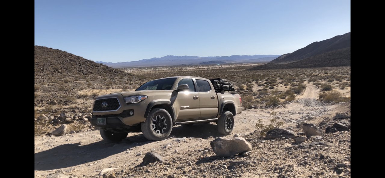

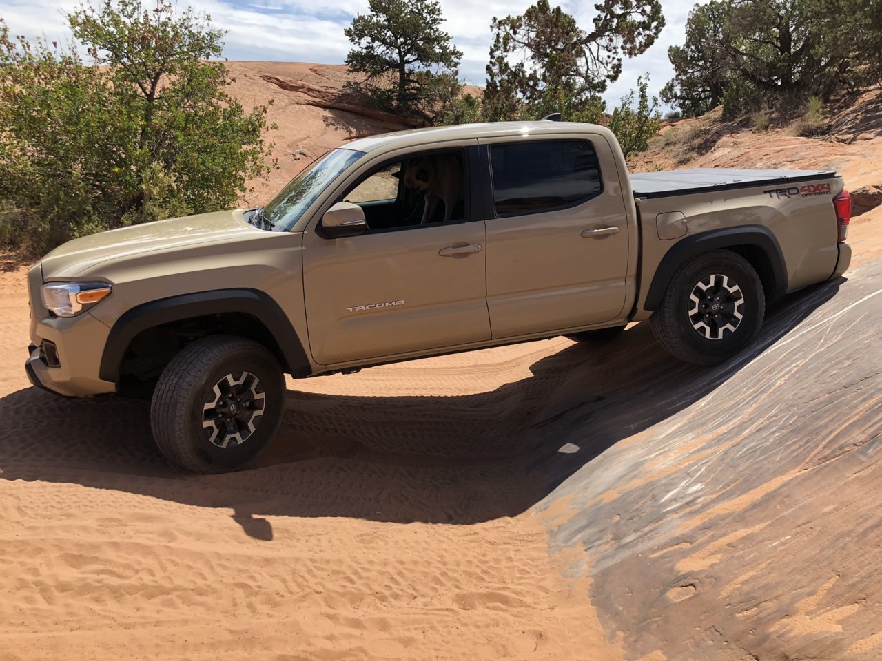

    I have beat the ever-loving fuck out of my (then) stock off-road, all across the US, and never once felt i was going to get stuck w/ the a-trac. Factory tires don’t seem to do well with mud, but do great on rocks. It’s been a very over-landy trip. I’ve since gotten a lift but they did a shit job and i regret it. Rock sliders are worth their weight.
    I’d leave it stock and see how it does before you spend all that cash on mods.
    The sport has a lesser traction control system than the off-road, and the m/t’s gearing sucks off-road -but if you’re going to throw 5.29 lockers in it, irrelevant.
    and the taco can fit on some real narrow trails if you’re not afraid to give it some battle scars (same with clambering over rocks w/ the undercarriage)
