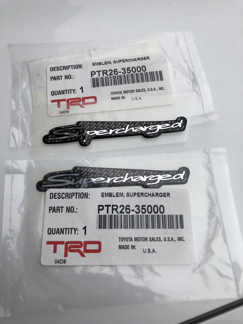

    Anyone interested in OEM Toyota "supercharged" emblems?
    $22 shipped for both
  6. Mar 26, 2018 at 8:18 PM

    I like those. Still have them?
