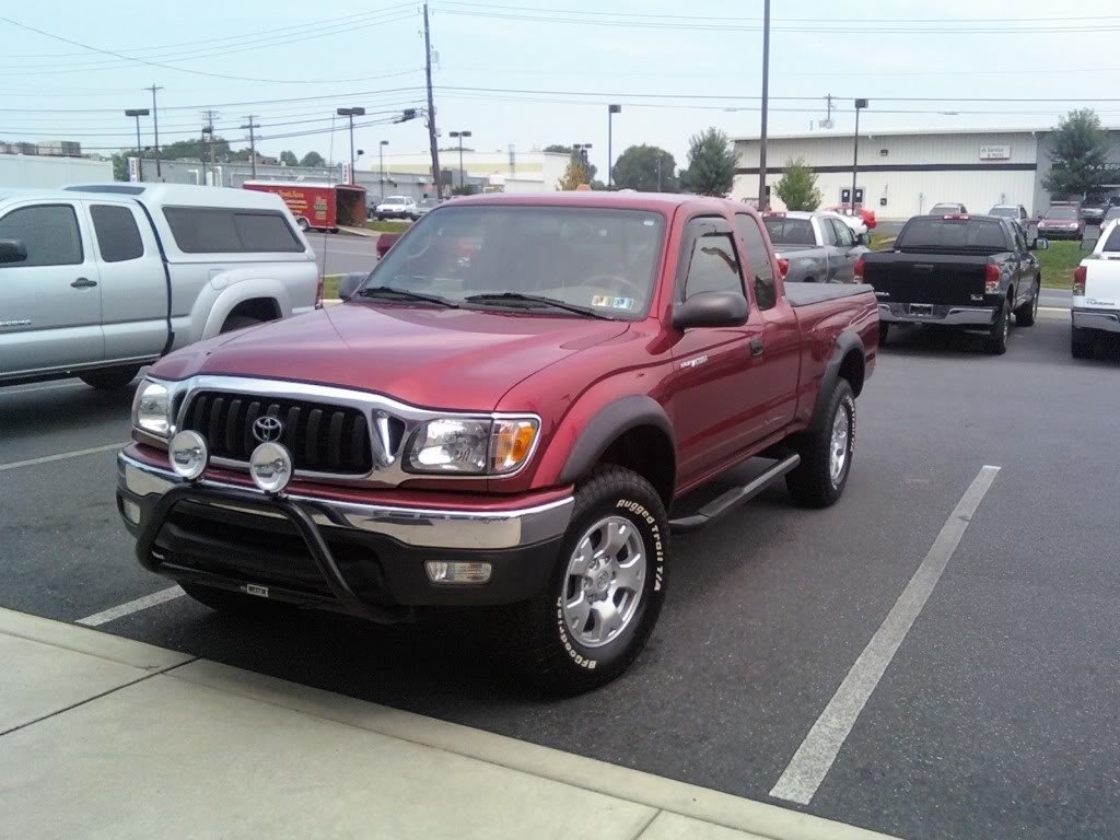

    Yes
    Heres what my 04 looked like when I traded it in and swapped wheels.

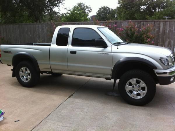

    Rockford Fosgate p2 10'', Q-Logic Enclosure, JVC KD-PDR30 Ipod Connection, Rockford p200.2 Amp, Clear Corners, KING Coilovers, Rancho Rear shocks FJ TRD Trail Teams Wheels with 285/75/16 Duratracs
    Without TRD Center caps and 265/70/16
    With 265/70/16 No Spacers
    With 285/75/16 With Spacers
