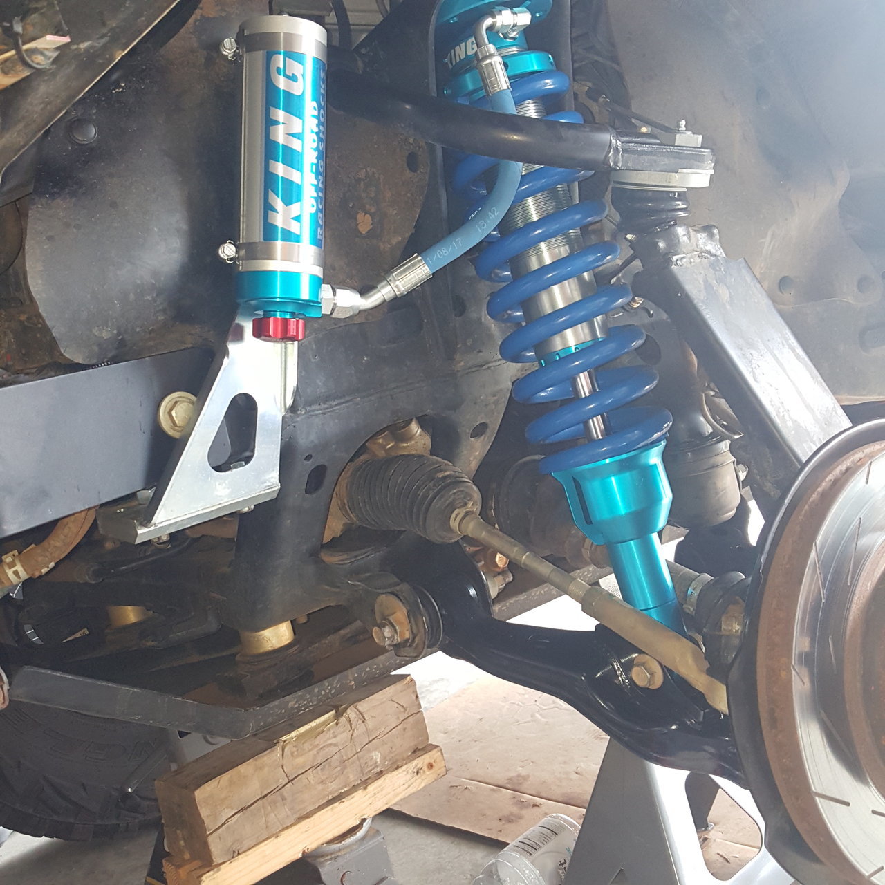

    Did you weld on your own spindle gussets?

    Yeah, if you can call them welded. :rofl:
    Had a little bit of help, but it's ugly. I don't think I'll attempt my cab mount relocate anytime soon until I can actually learn and get practice.
    I bent my passenger spindle last fall, so I'm not playing around anymore.
    :rofl::rofl::rofl::rofl:
    I don't think so. I just replaced 4 bad balljoints and the LCA bushings... my old stuff was beat to hell, and the driver front cam bolt and tube were a bitch to coax out of there. I used half a tube of anti-seize during reassembly. I'd have used more if I had it!

    How much if a pain was it? Did you preheat the spindles and slowly bring them back to temp, etc?

    Heated in the oven at 300 for an hour, welded it on and let it cool before cleanup and paint. Not too bad.

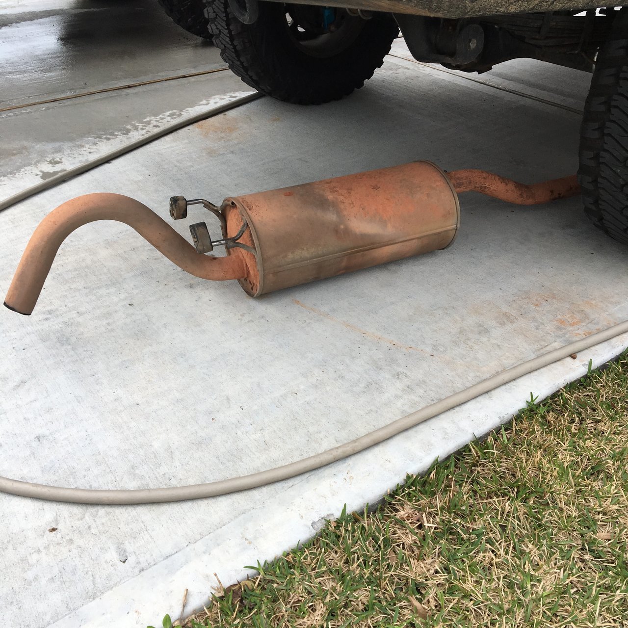

  15. Feb 26, 2018 at 7:51 AM

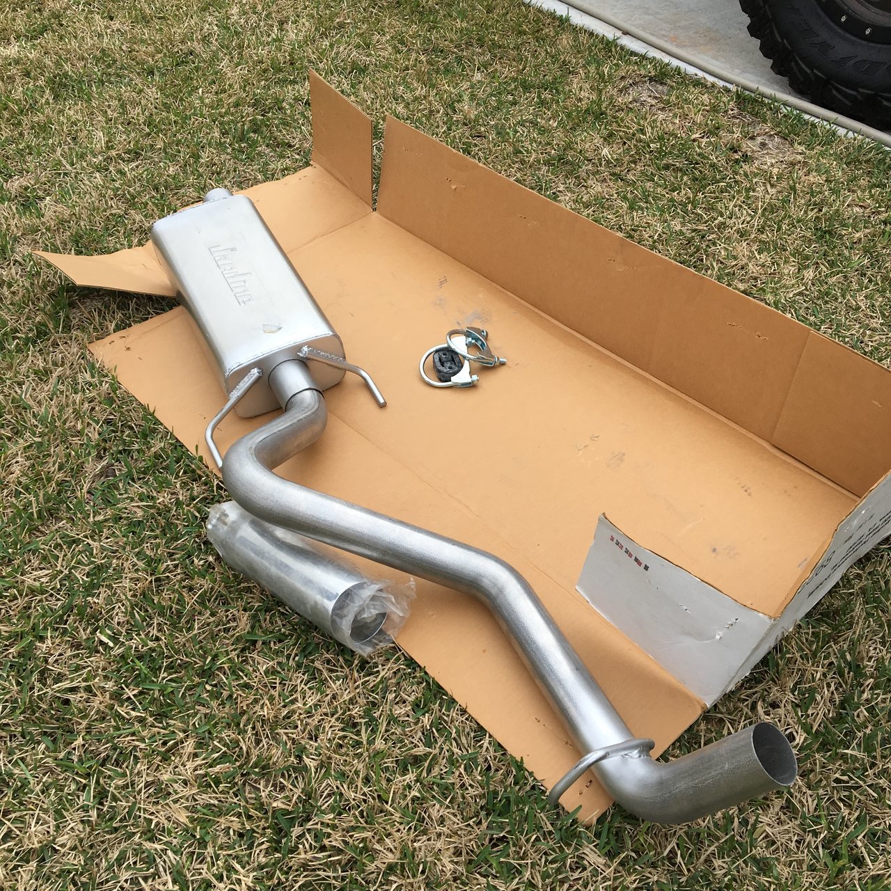

    That's a good deal... looks loud lol
    The muffler on mine is way larger than that and it's loud af in the cab. I don't have the tailpipe on mine though since I've got a high clearance bumper and the tailpipe is designed to exit out the side like the stock exhaust would have. I need to put a turn down or go over the axle and dump from there to see if it cuts down on some of the cab noise.

    yea, mine is just cut right after the axle... but I would rather it dump before the axle...
    Not a bad price for it, not sure how long he has had it, but I think he is coming to Gilmer this weekend... so may just have to take it off his hands.
    As well as attempt to install it at Barnwell... because why not right?
