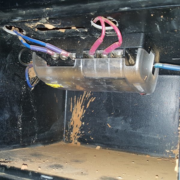

    Bussmann RTMR relay fuse panel and breaker with custom wiring
    Modified stock interior power relay to allow constant hot 12v outlets
    Added 12v and usb outlets in the bed wired to the RTMR

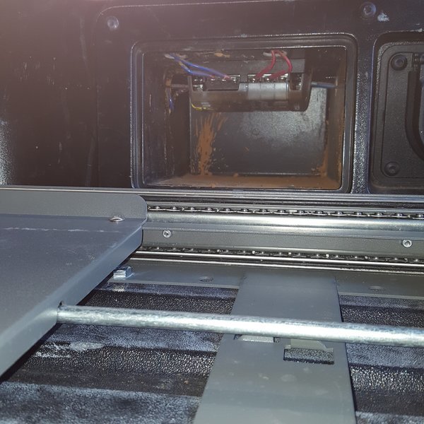

    6 circuit Blue Sea fuse block mounted in the bed cubby

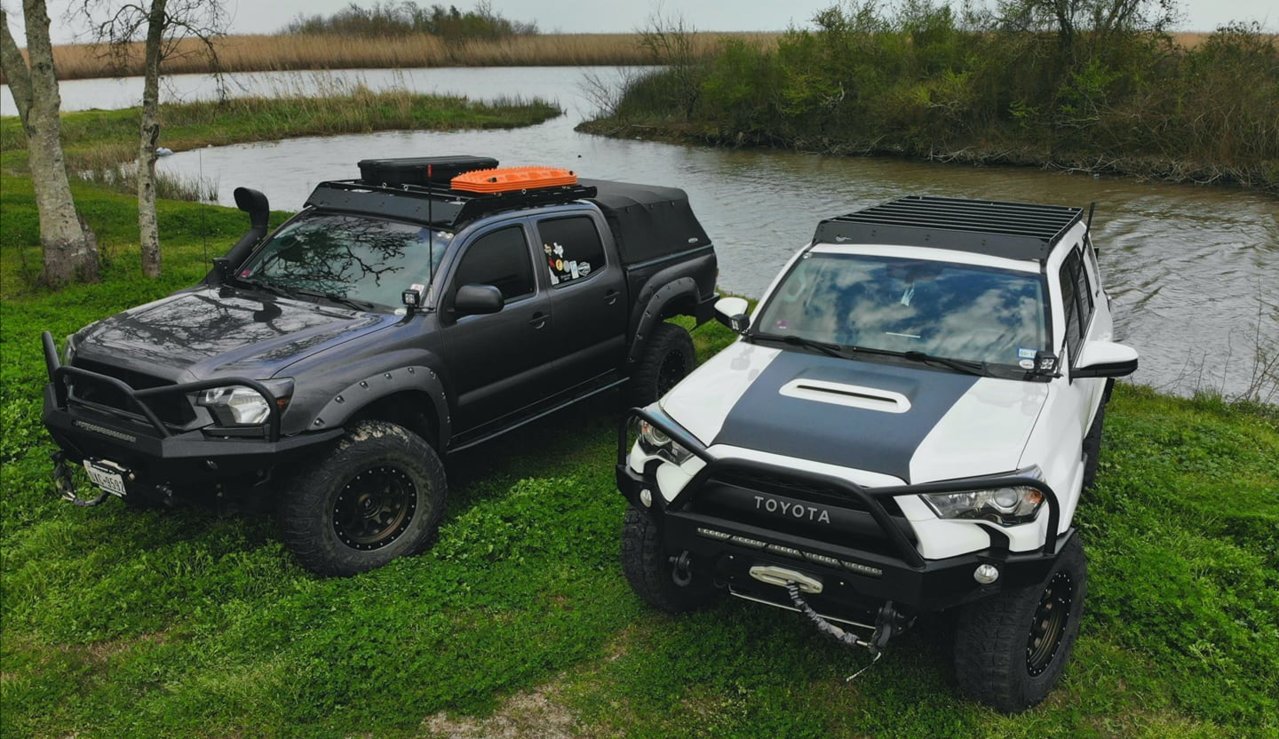

    @MellyMel and her 2016 T4R TRD Pro Build
    I met my better half while out wheeling. I've been working with her to build up her 4Runner so she can rip it on the trails too.

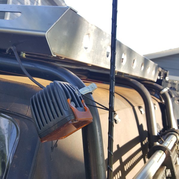

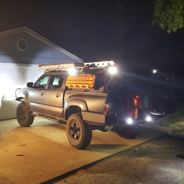

    I got more @Iggy pods to play with, so I stuck some on my bed rack. I used a relayed switch through my Bussmann RTMR fuse/relay panel under the hood to send power to a 6 circuit Blue Sea fuse block in the bed with four switches on it to isolate each light. I mounted the Blue Sea fuse block in the passenger side bed cubby on the underside of the top portion to keep the space available for ratchet straps or bungies.
    20170515_190153.jpg 20170515_190249.jpg 20170515_190317.jpg 20170515_190349.jpg 20170428_214059.jpg

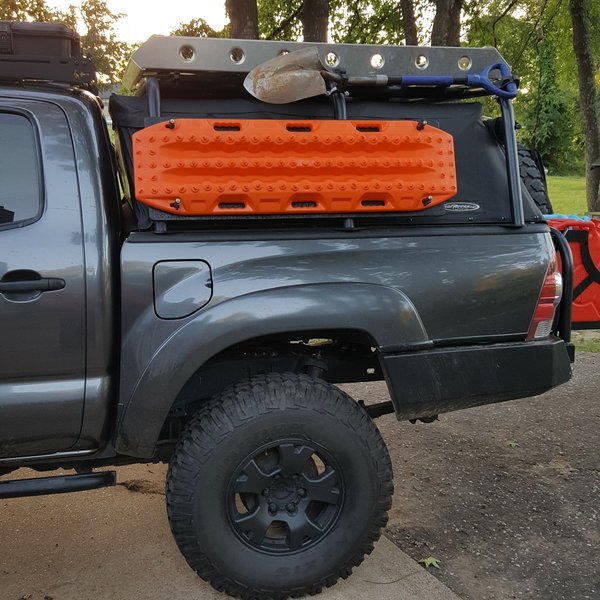

    Maxtrax mount:

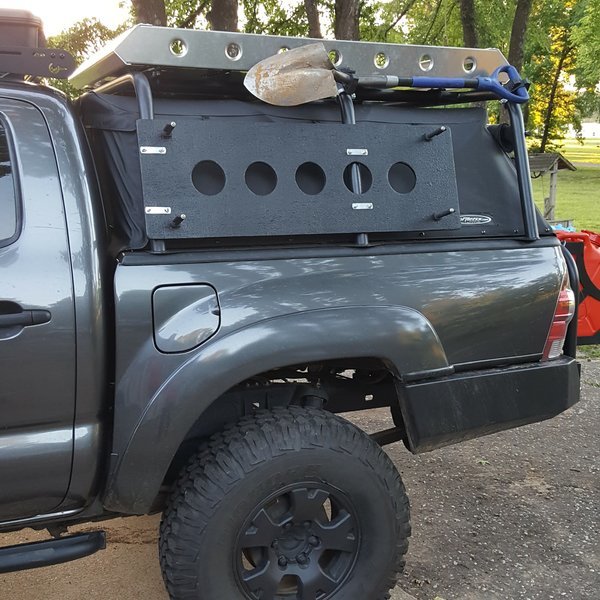

    I wanted a way to mount my maxtrax to my bed rack without taking up valuable roof space. I wound up using a piece of plywood drilled out to mount it to the tubes of the rack using u-bolts. I cut a bit of weight out of it with the hole saw bit I had left over from my snorkel install. The holes in the middle of the board helped make install easier by allowing access to behind the panel. Once I was finished cutting and drilling I finished the board with roll on bed liner that was left over from finishing the tub of my camp trailer.

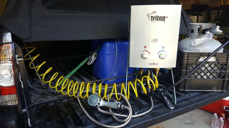

    Hot Water on demand:
    I got an on-board water kit from @ProForce and adapted a tankless propane water heater for hot water. CAMP SHOWERS!

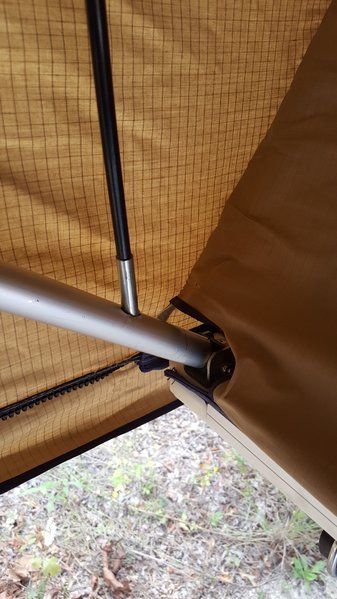

    RTT Overhang Mod:
    Climbing in and out of the RTT is kind of a pain when ducking through the overhang of my Tepui Gran Sabana. I had some leftover tent poles laying around and decided to put them to good use, by drilling a few holes in the overhang support bar angled just right to hold the tent poles. The poles lift the center of the overhang material enough to give more head room when climbing in and out with the added benefit of preventing rain water from pooling up.
