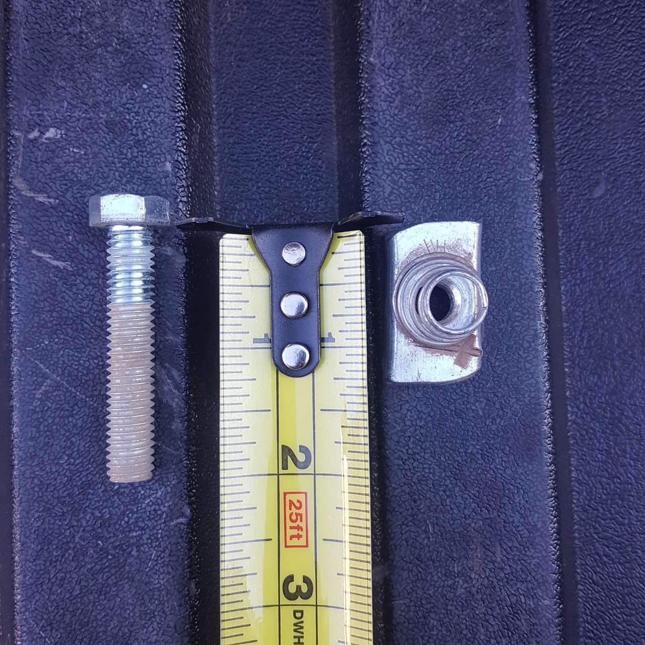

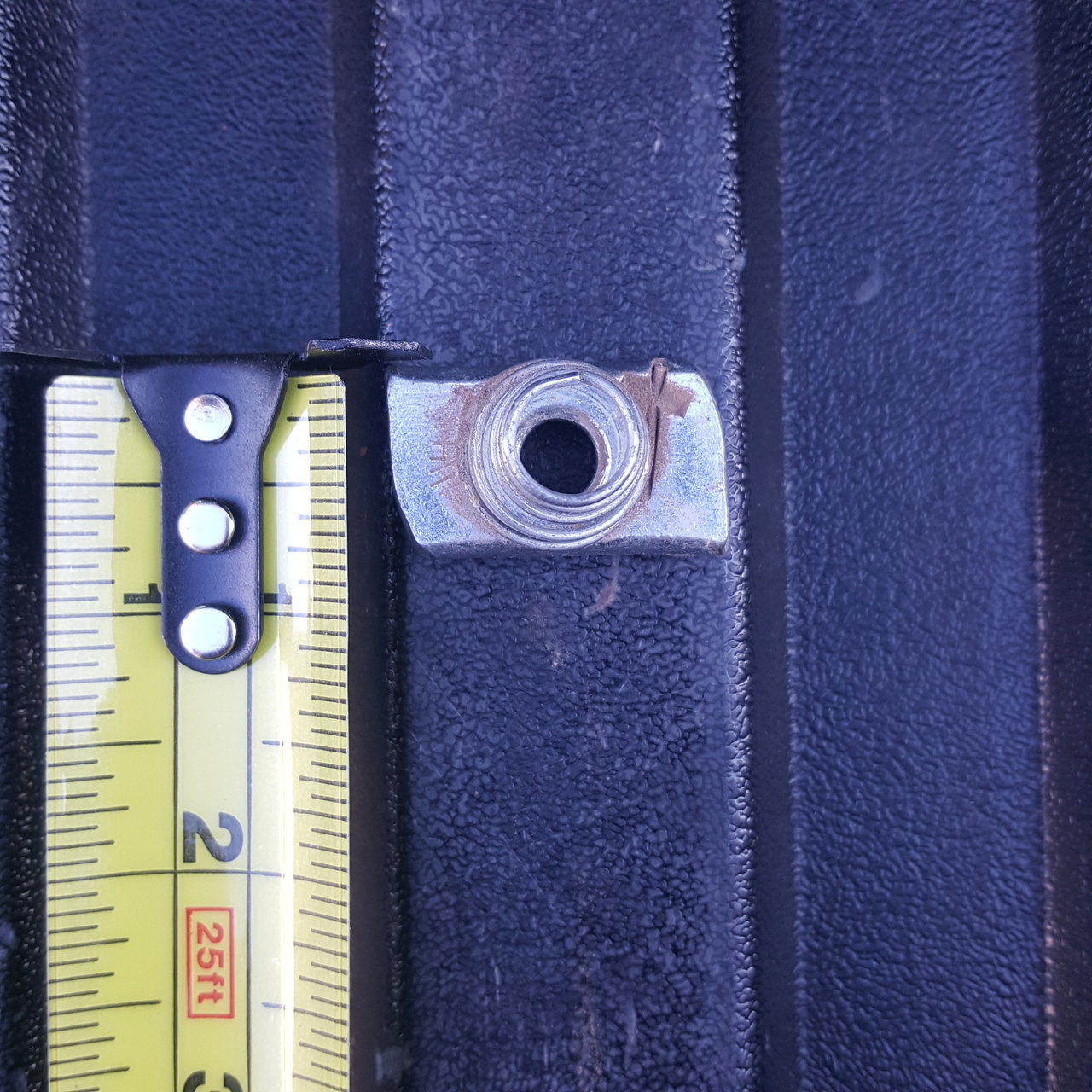

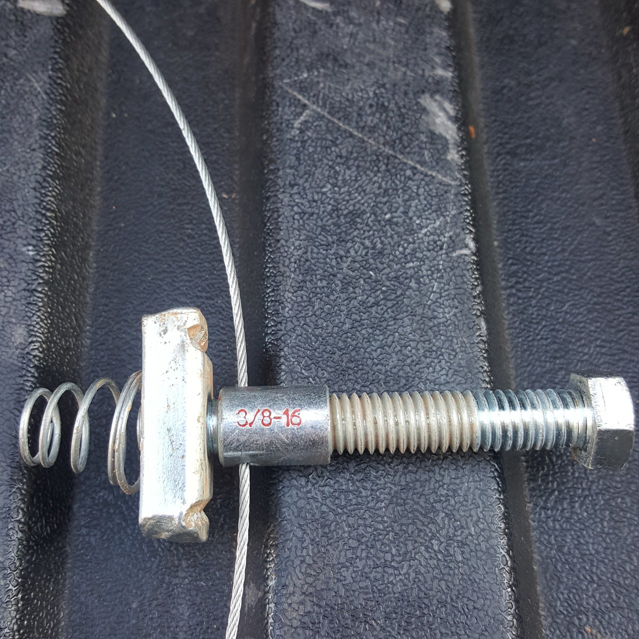

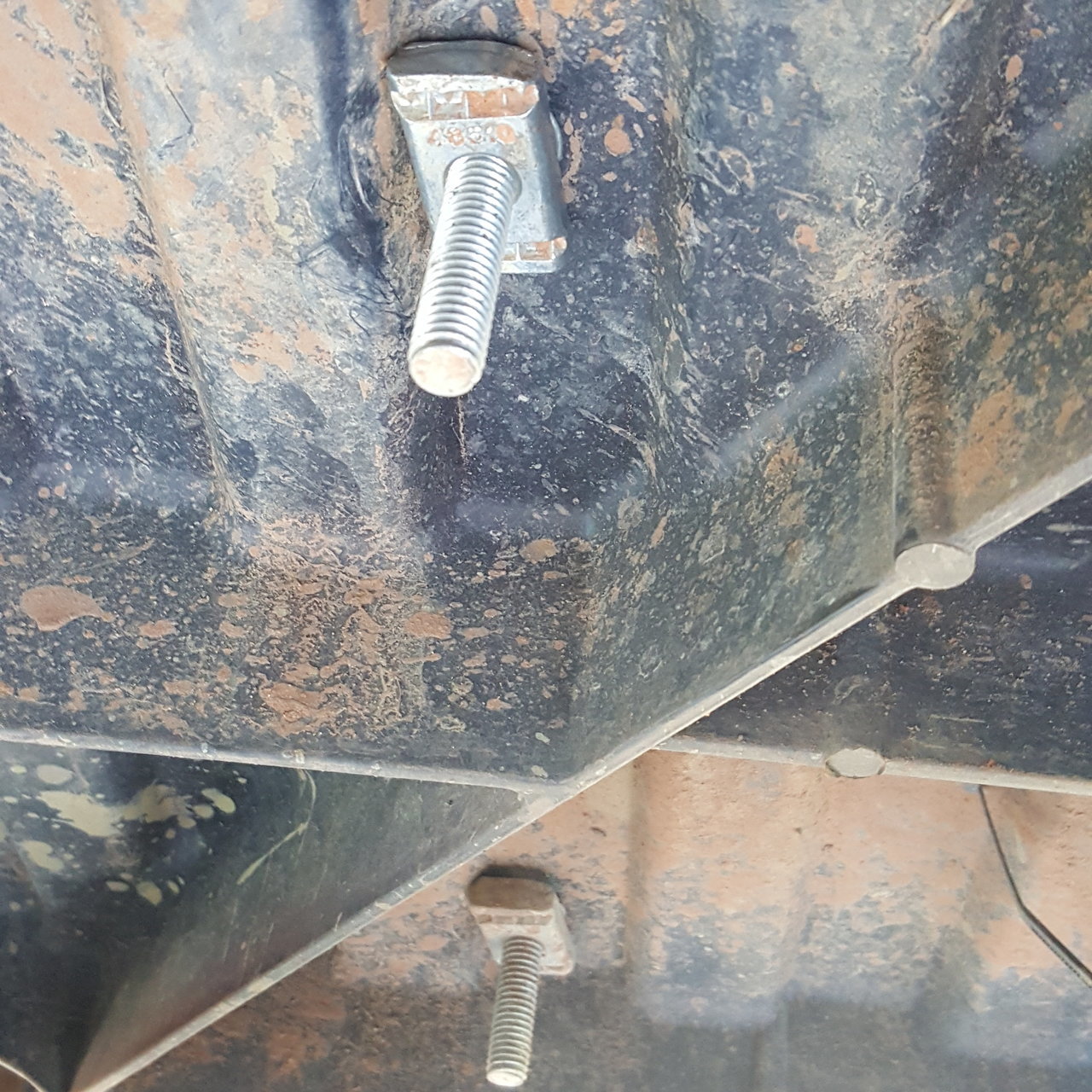

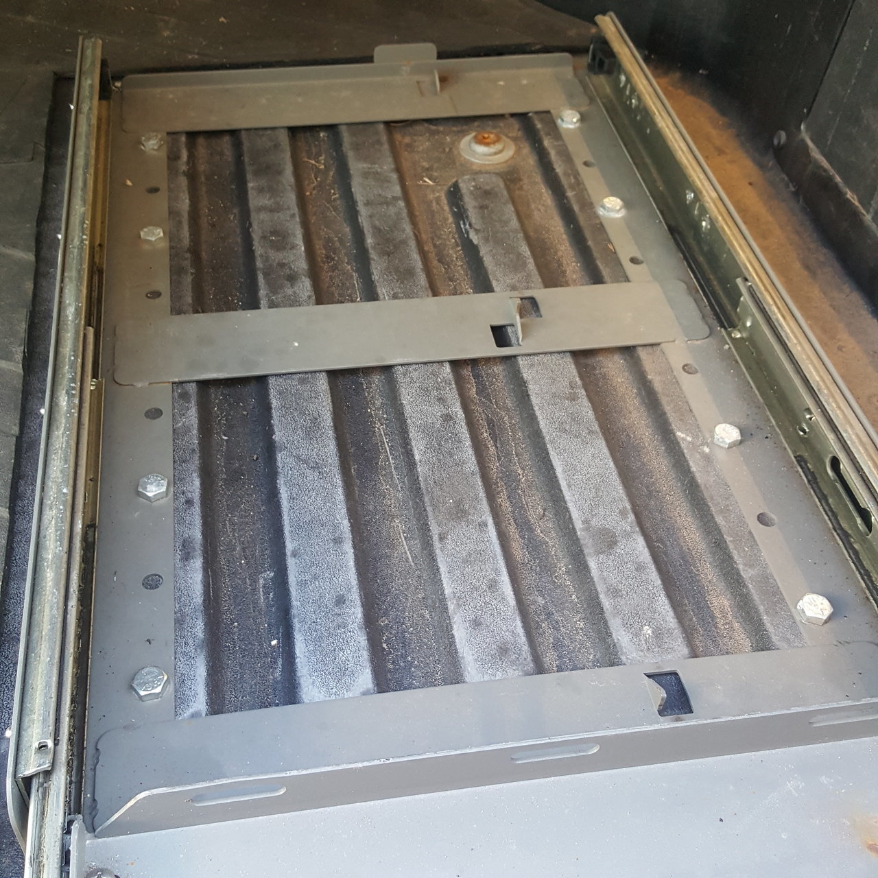

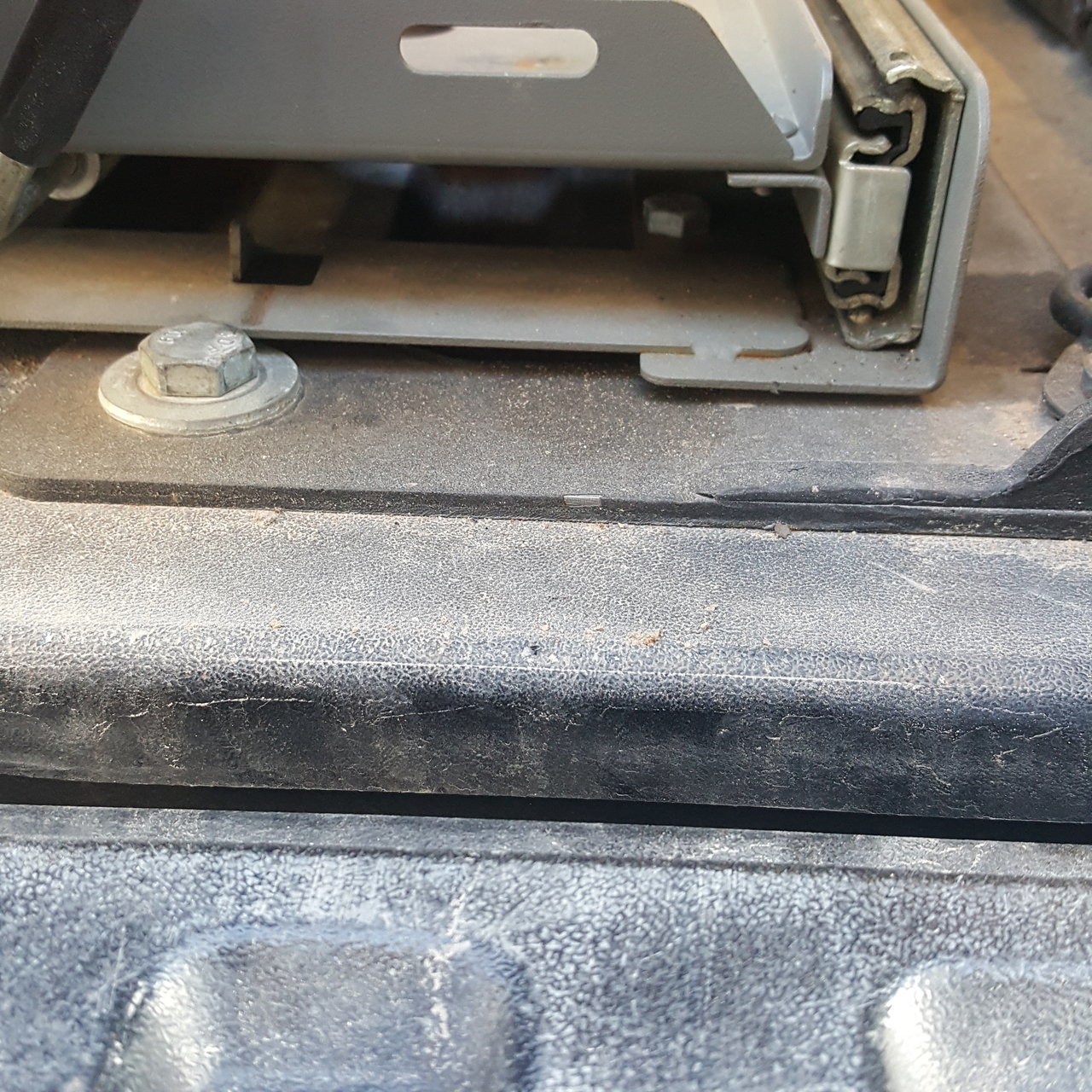

    I have been asked about my fridge slide setup in the bed and figured I'd go ahead and give some details on it in case it could help anyone else out there in internetland.
    I wanted a way to bolt up the slide without having to have another person assist in bolting the thing down - someone in the bed and someone underneath the truck - so I went on over to fastenal and picked up some channel nuts to fit in between the bed ridges under the bed.
    Sure you could get nutserts or some type of rivnut in the bed floor... but since it's a composite bed and things tend to bounce around back there during wheeling, I figured having some solid metal on both sides of the bed/slide would be the best way to secure it without future failures.
    I situated the fridge slide where I wanted it and drilled through the upper ridges in the bed for the eight mounting points as shown below where the shiny bolt heads are sitting.
    I dropped the bolts through the slide and bed, and went under the truck with the channel nuts. I threaded the channel nuts onto the bolts by hand until the spring comressed some between the bed. Since the channel nut is longer than the width of the ridge channel, when it spins it can only spin so far before it is locked in place as shown below (fully tightened down, the spring is compressed).
    I installed my slide right up next to the bed stiffener I had previously installed. I wanted the slide to extend as far out of the bed as possible. I had to grind away a small bit of material from the bed stiffener so the slide would clear, but it was no biggie. as you can see... I put the slide frame as far forward to the edge of the bed as I could, just touching the bed stiffener bolt head.
    The hardware I bought worked perfectly for me... I bought bolts that were a bit long so I could thread on the channel nuts easily by hand and get the springs compressed. Here are dimensions for all of those goodies...
    Hope that was clear as mud. Let me know if you run into any issues with your slide installs or if you have come up with a different approach.
