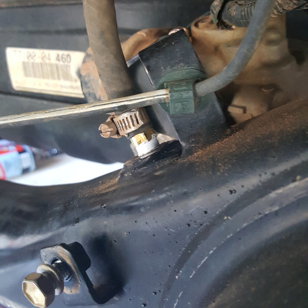

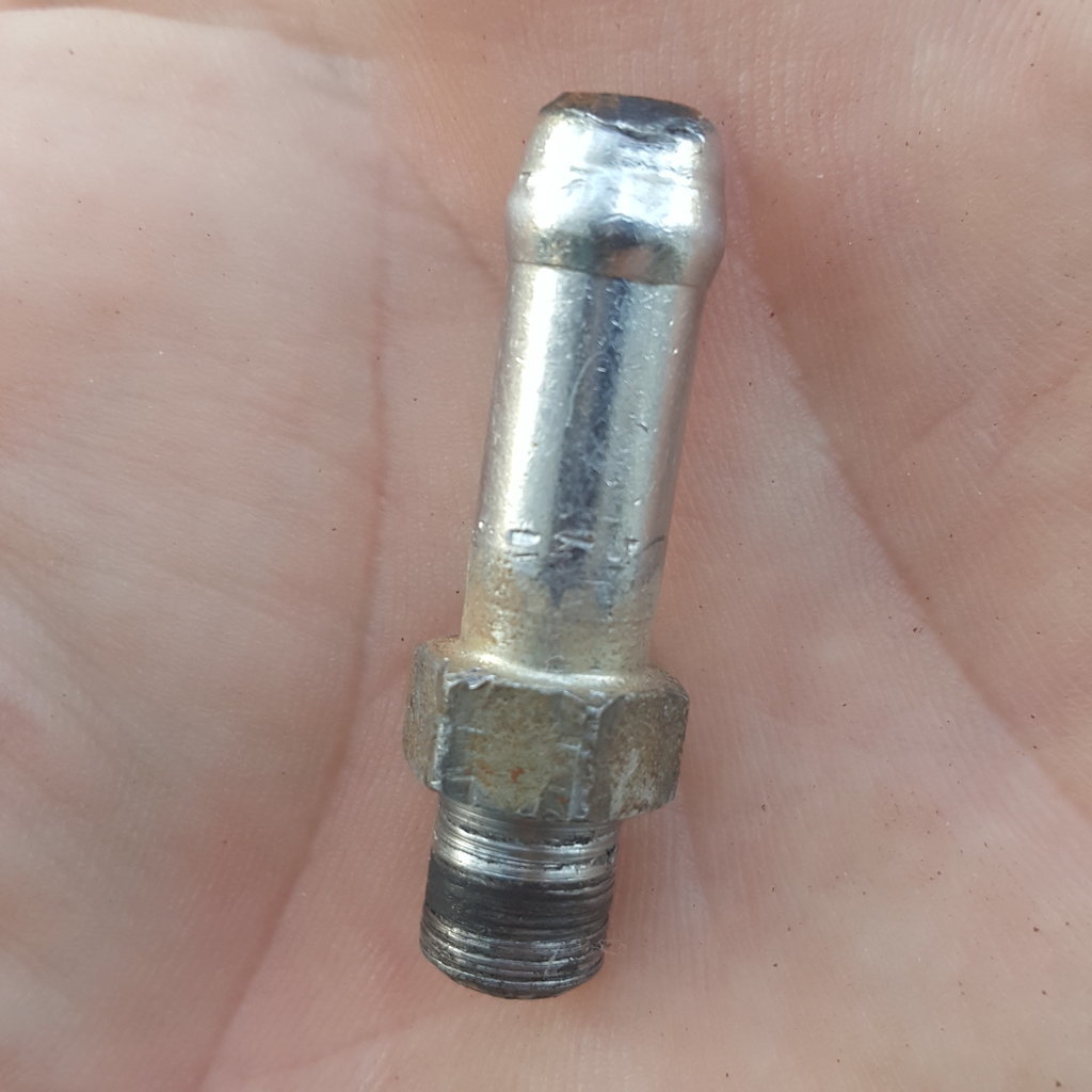

    This sumbitch was my rear diff breather union. Where'd them threads go? I noticed last weekend that it was rattling around in the axle housing during disassembly of the third.
    I used a 1/8-27 pipe thread tap to re-thread the hole in the housing and replaced this soft aluminum metric crap with a barbed brass pipe fitting. Better than new!

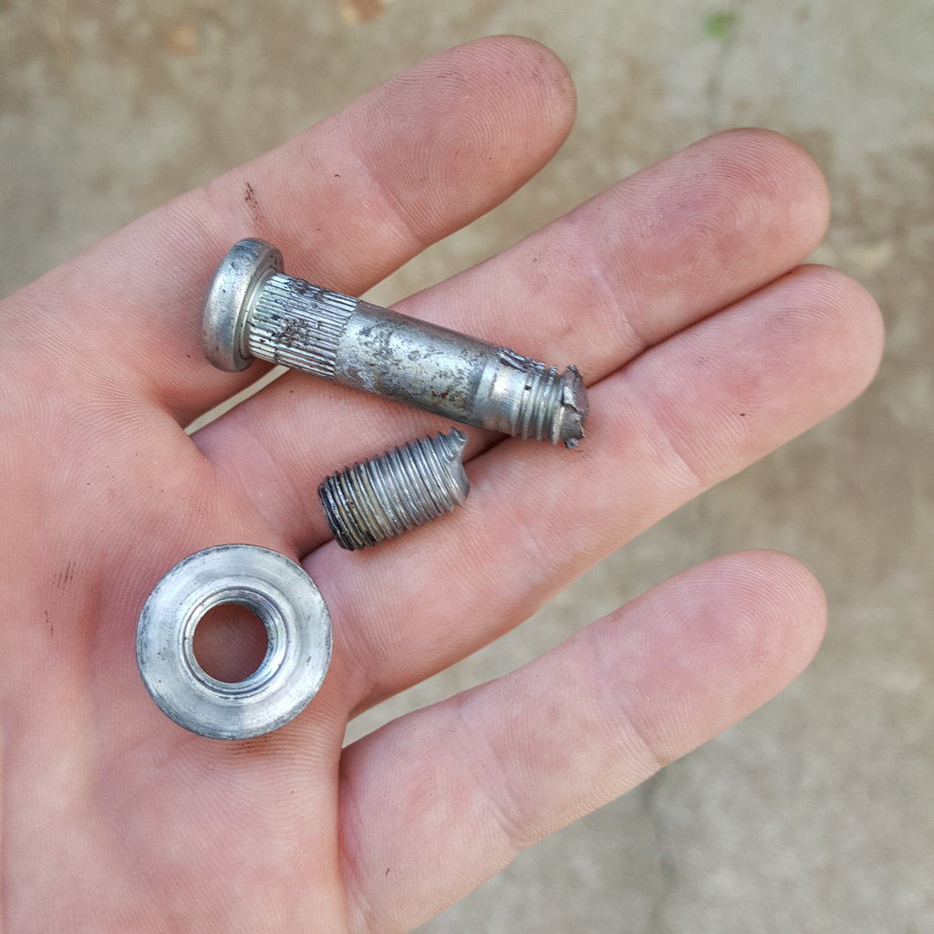

    Don't use shitty torque wrenches. This added way too much time to my day in the garage earlier. Couldn't find a stud that fit the drum backing plate locally, so I replaced it with a nut and bolt. When I change the brakes I'll replace it with a stud.
    I also found an AWESOME leak in my t-case. When it rains it pours. :mad:
