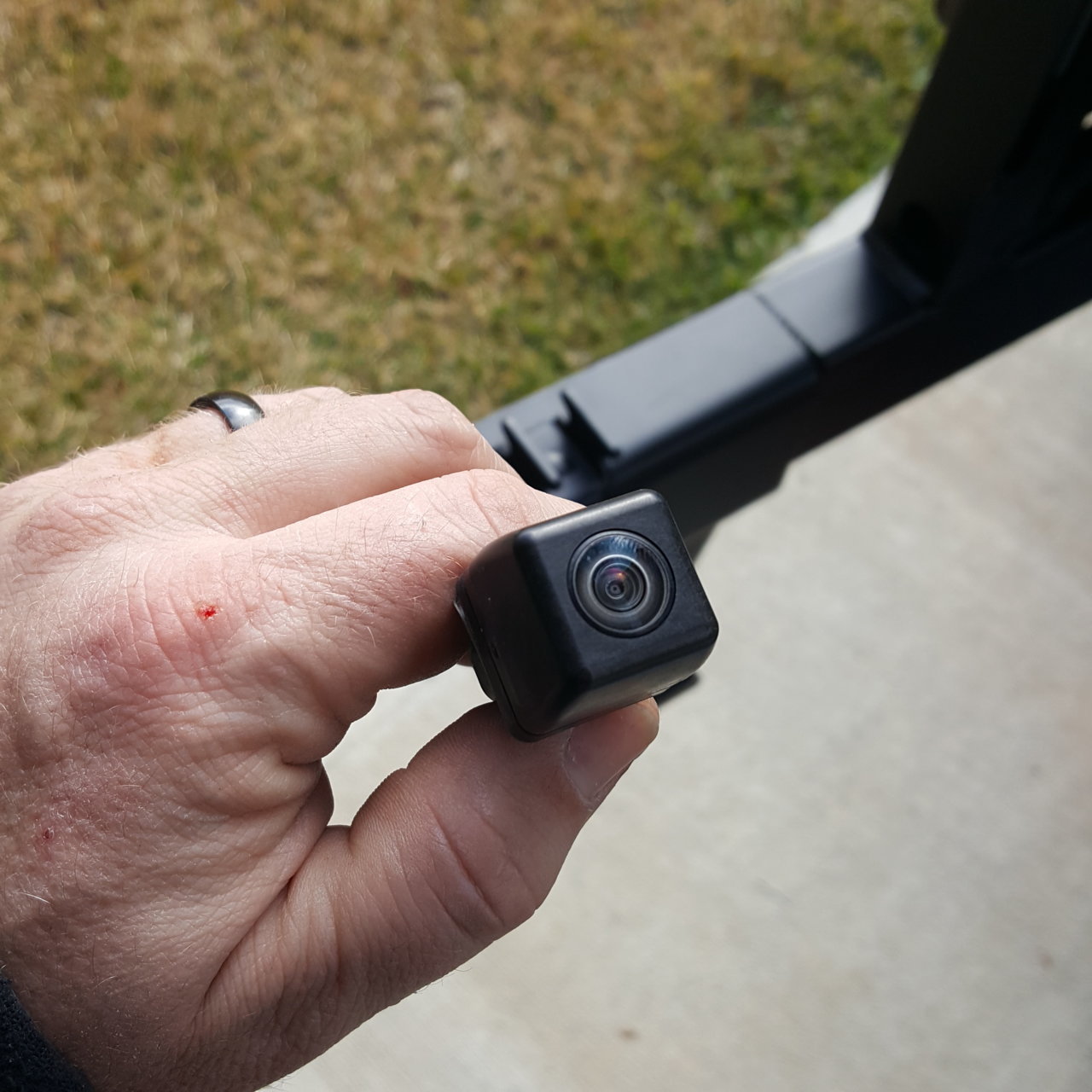

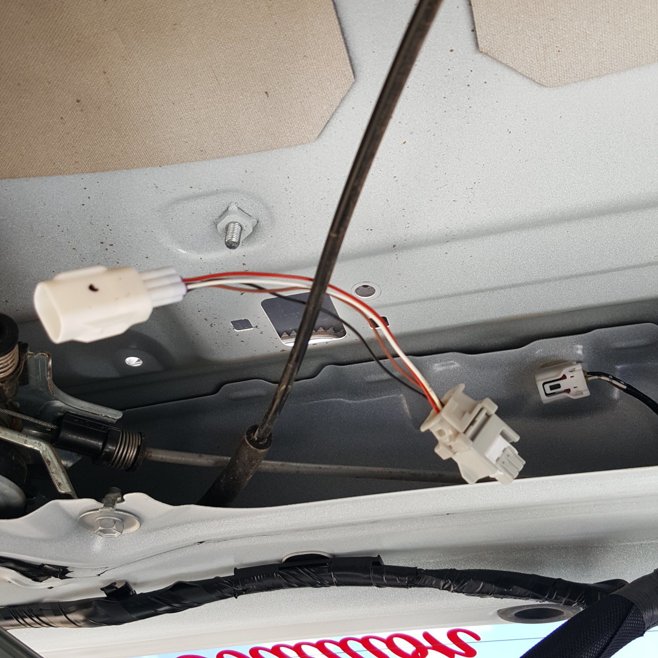

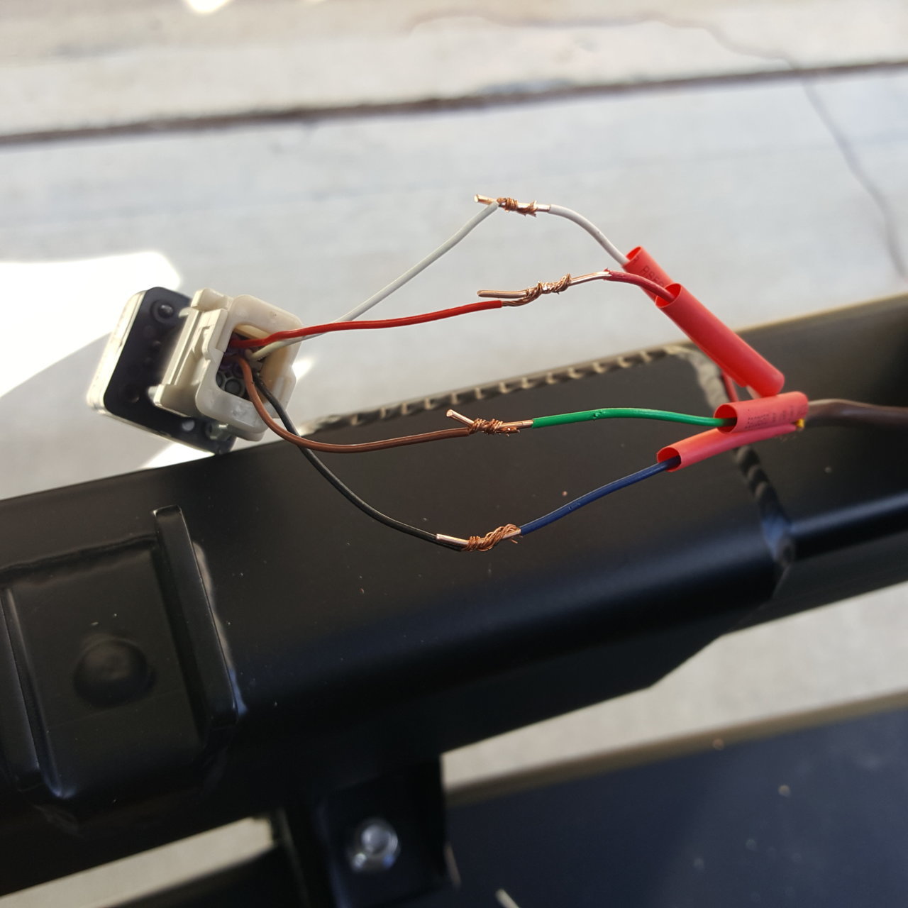

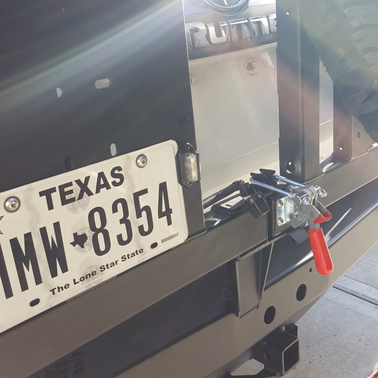

    That was not as fun as getting the bumper on, but the job is done.
    Took everything apart and tried to figure out a way to reroute the existing wiring harness from the hatch to the bumper. A quick peak inside revealed that was going to be a bigger pain in the ass than I wanted to deal with, so my solution was to extend the existing wiring harness to the camera from the hatch. Basically I did what the RSO kit does but without their mounting bracket. I used the leftover bracket from my pelfrey relo kit that I luckily kept in my parts pile for the past few years. Of course that bracket didn't fit the camera, so I had to get tricky with that too.
    The wiring harness that needs to run from the stock location in the hatch to the bumper swing out:

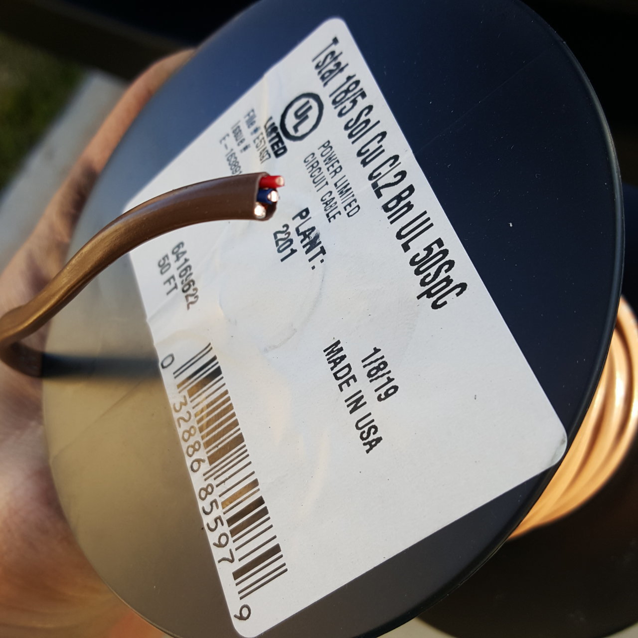

    I didn't have enough wire so I picked up this 5x18 at Lowe's to make the install easier. Fishing these wires through the hatch area is a bitch. The harness that needs extending is only 4 wires, so there's an extra one here for shits and giggles:

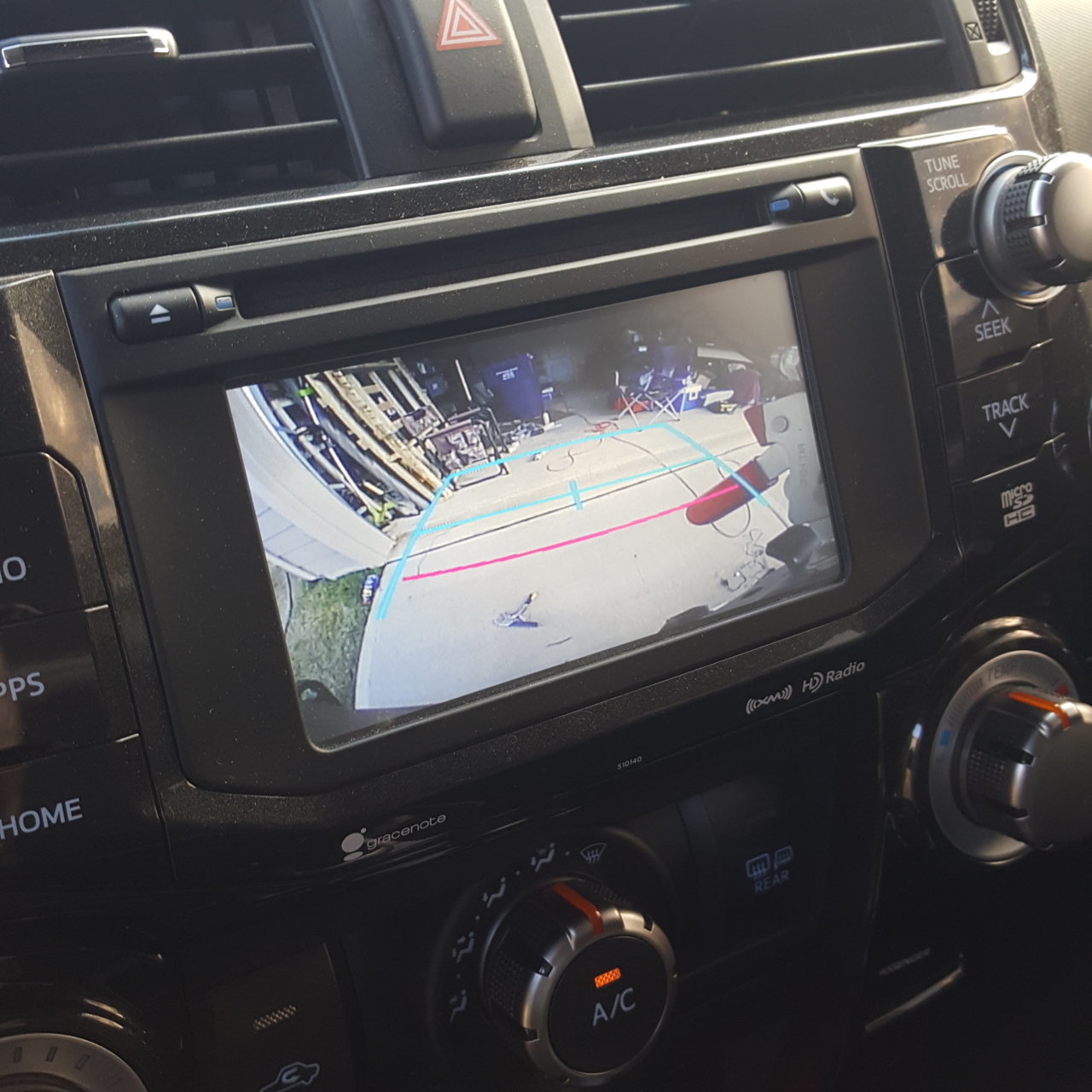

    Tested the new harness before soldering... success!

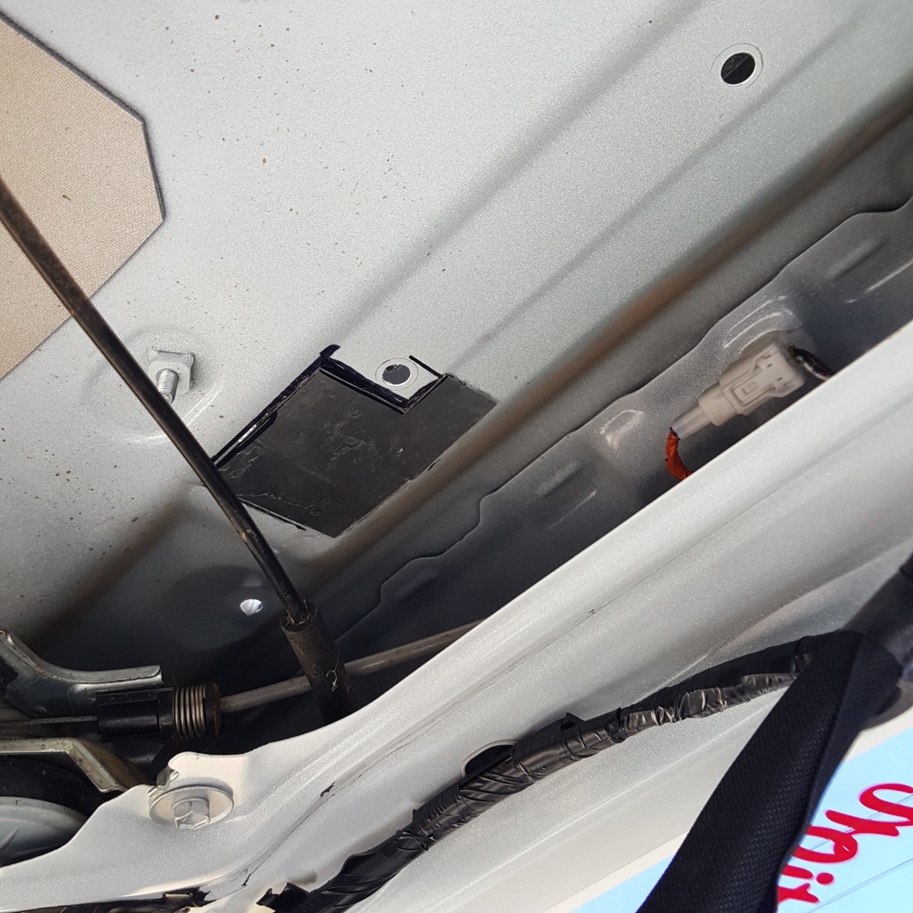

    Then I had to fill in the hole in the hatch left from the stock camera housing. I used some thin aluminum and cheap adhesive in case this thing needs to come back apart:

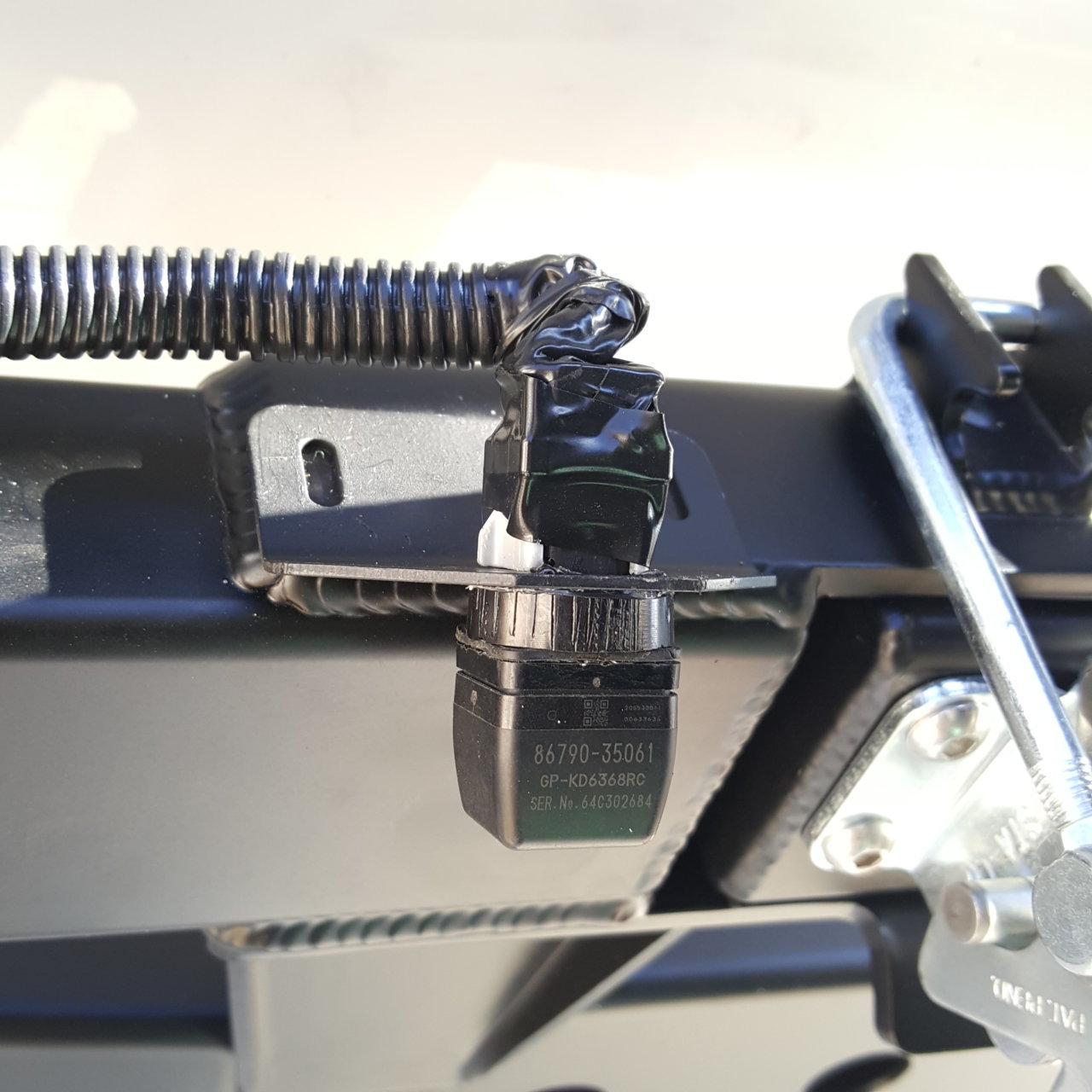

    Like I said earlier, the camera doesn't fit the bracket I had... so my solution was to use the clamping force of the camera body and the wire harness plug to sandwich the assembly in place in the bracket. I accomplished this by drilling out a round plastic spacer I had lying around and ground it down to the right thickness to allow the plug to lock into the camera and hold itself steadily on the bracket:
    If I didn't stop drinking beer, now is when I'd have two opened at once.
    ETA: the relo bracket is held on to the swing out with adhesive tape just like the one on my truck.
