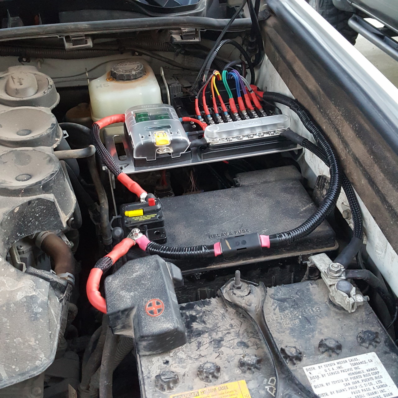

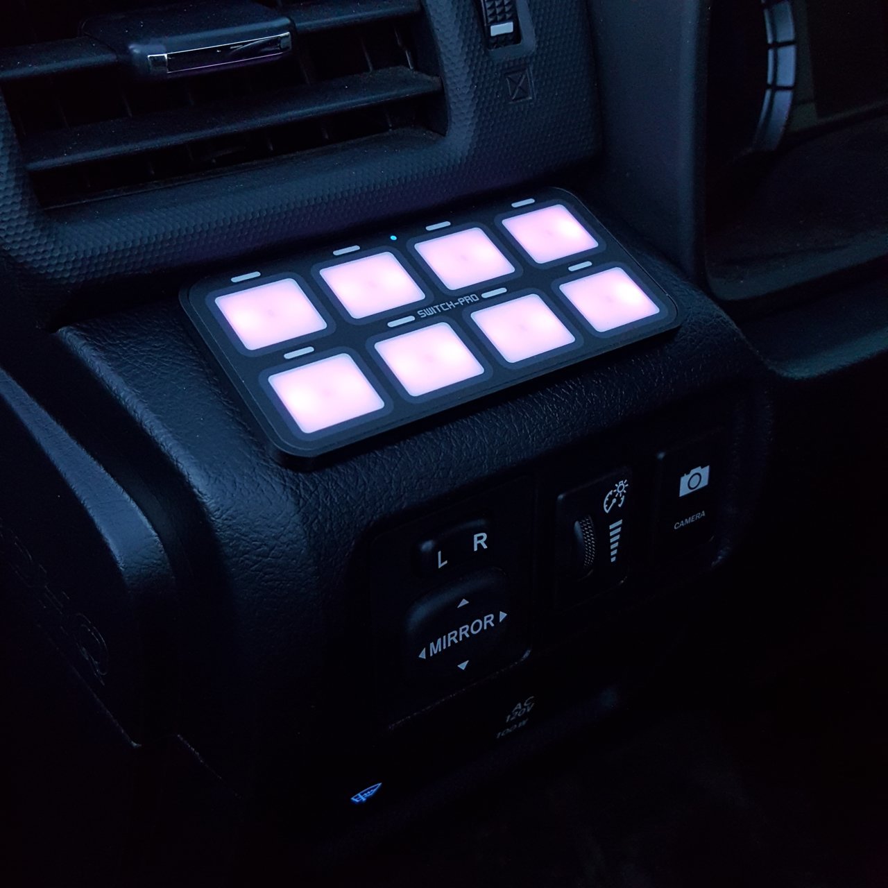

    Redid the electrical on the 4R. As much as I enjoyed my RTMR build on my truck... this Switchpro is suuuuuper easy and clean.

    Looks good! I love the ease and simplicity of the switchpros. Why did you decide to ground on the battery and not the same ground spot to the chassis as the battery?

    The chassis ground is a flat surface so running multiple large crimp lug terminals gets messy. I had plenty of 4 gauge so I used it.

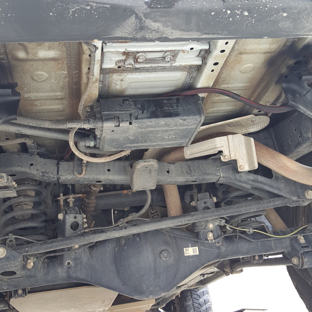

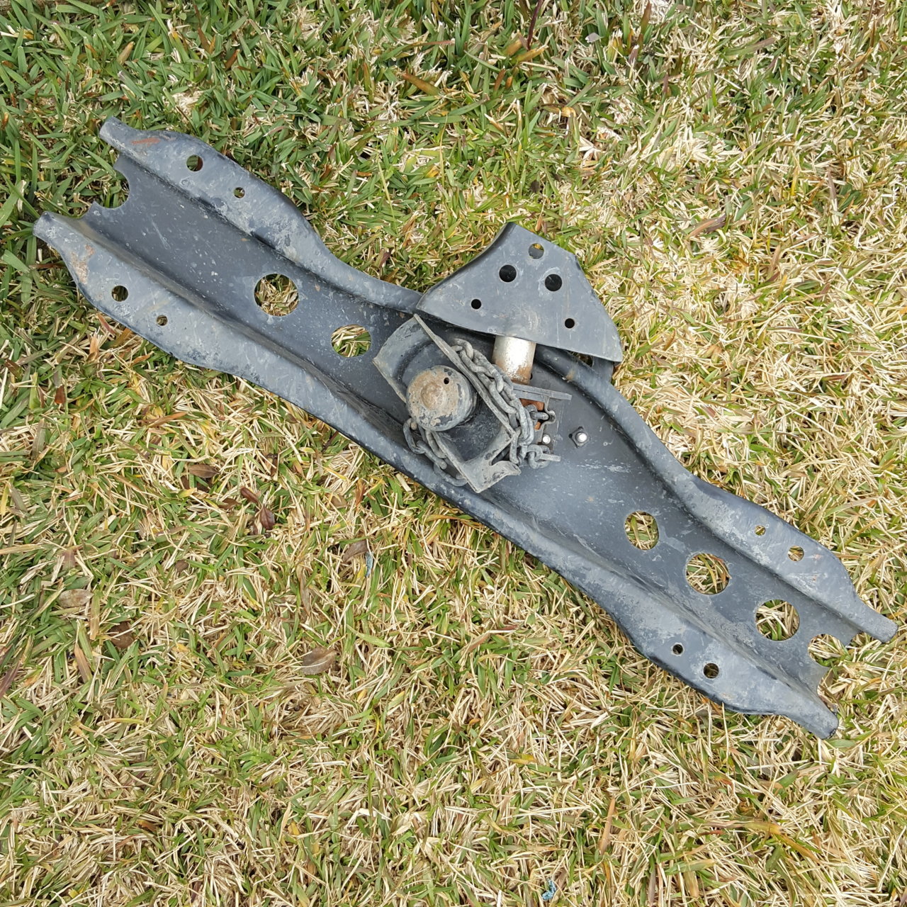

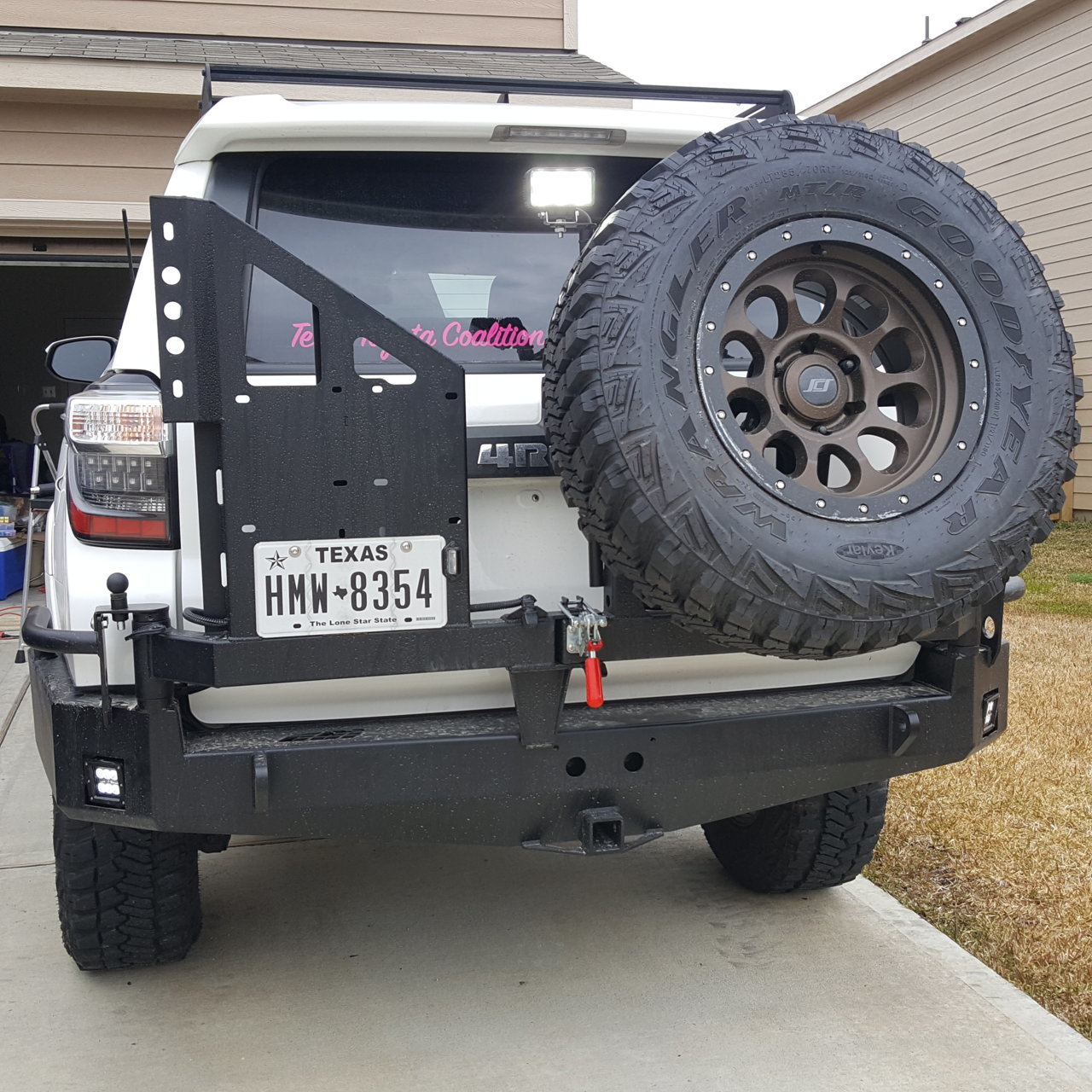

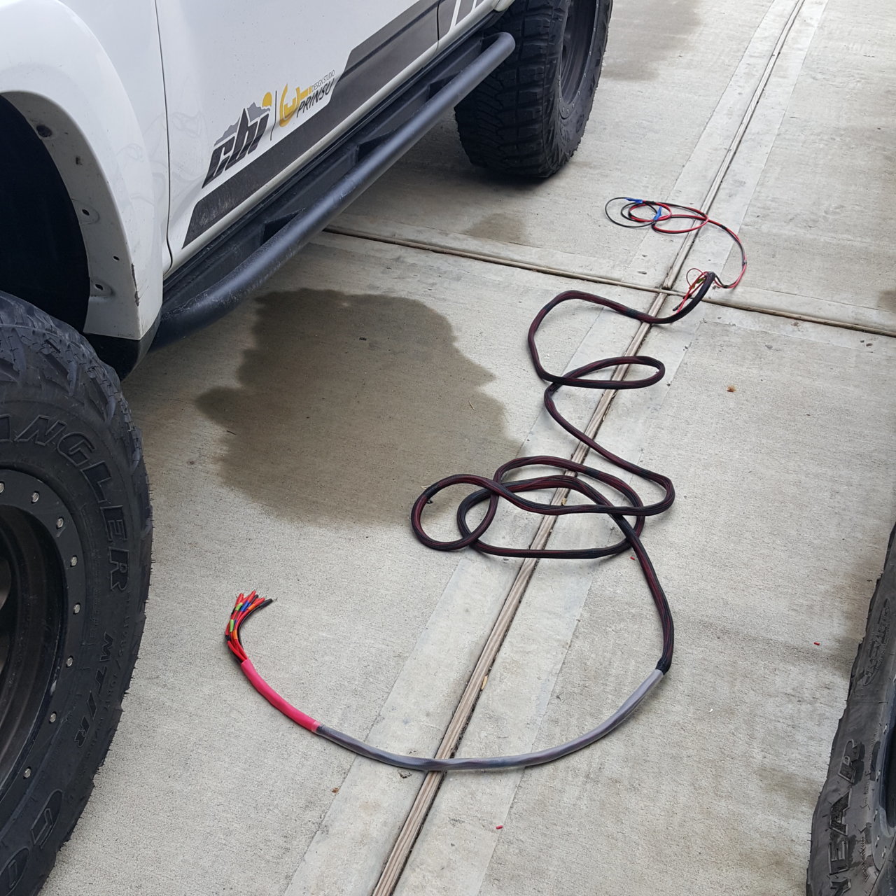

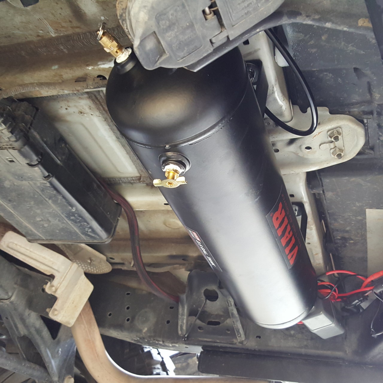

    Did more stuff today. Made a wiring harness for everything being powered in the rear of the 4R; reverse light pods in the bumper, flood light on the swing out, OBA, and OBW.
    Ran the wires and did some chopping underneath to make room for an air tank and a water tank. The 4Rs have boxed frame crossovers on either side of the stock spare tire crossover, so I got rid of that now useless chunk of metal. So much more room for activities.
    Rear lights installed. For now the wiring for the compressor and water pump will stay stashed above the frame until I have time to get to those projects.

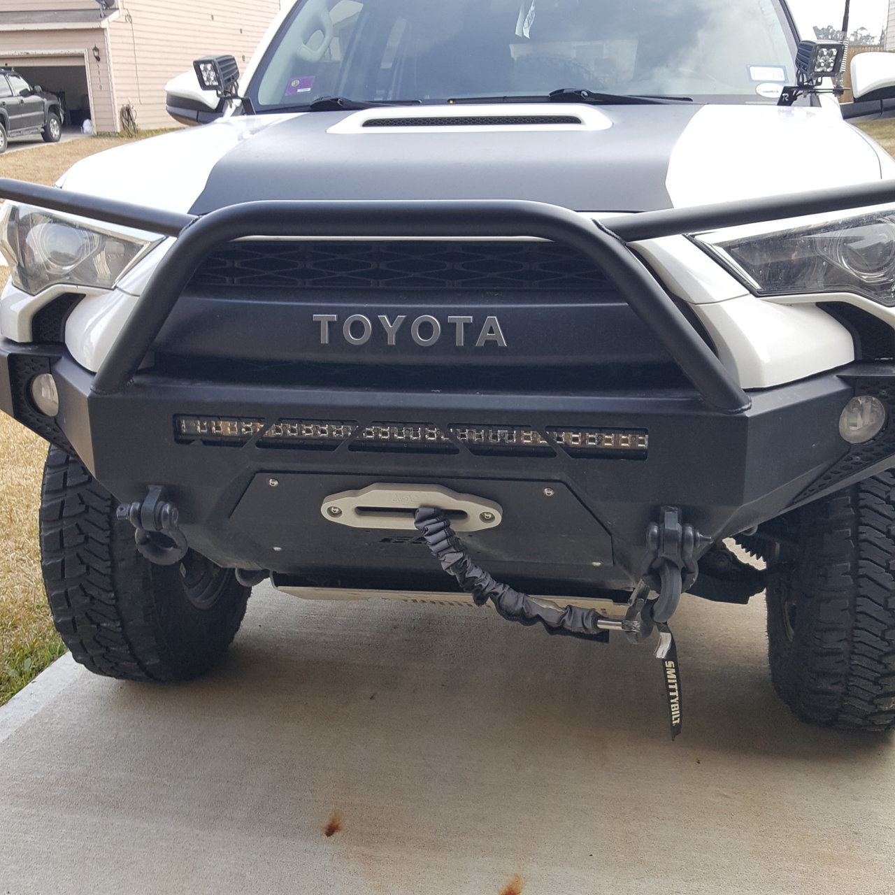

    Then I put the front light bar in. What a pain in the ass with the winch in there... but it's done and works well. #lightsbeforelockers

    What goes on the left side swingout and the holes above the hitch?
  13. Feb 2, 2019 at 6:08 PM
    #6213
    trekker
    trekker [OP] I like tacos
    Sep 8, 2016
    #196767
    5,034
    Brandon
    Pocatello, ID
    '14 DCSB TRD OR MGM
    floor mats and a beer switch
    Swing out will hold a hi-lift and rotopax, holes above the hitch are for mounting the bumper to the frame. I may try to find some rubber or plastic plugs to fill them. The license plate can go over them too, but it's out of harm's way on the swing out.

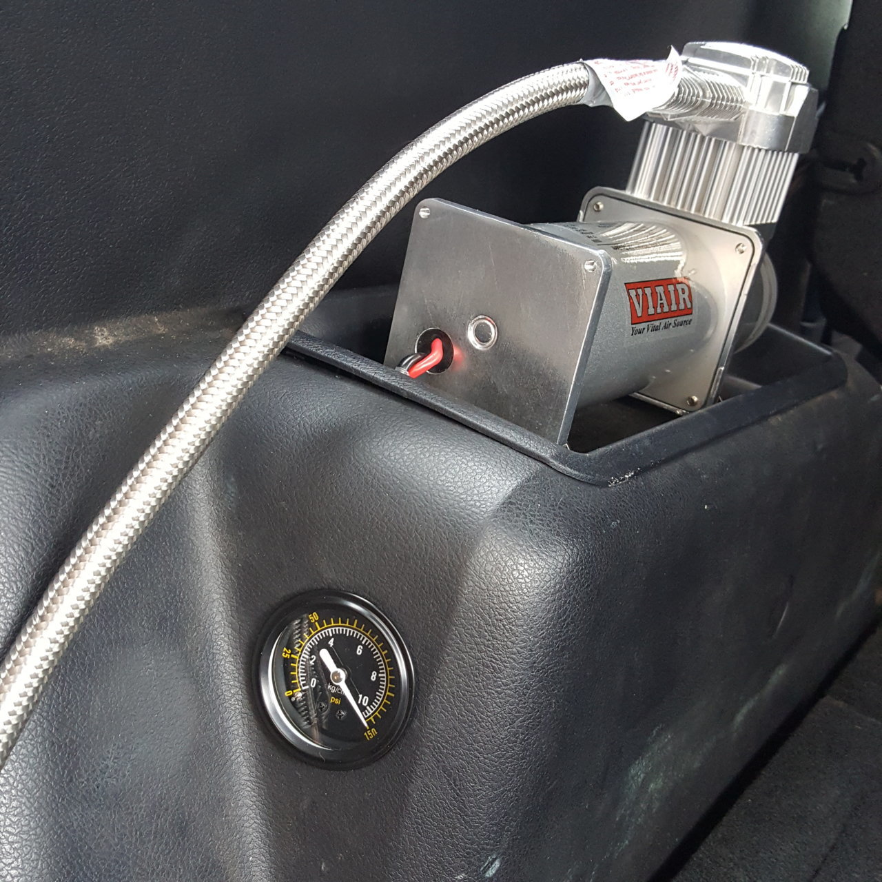

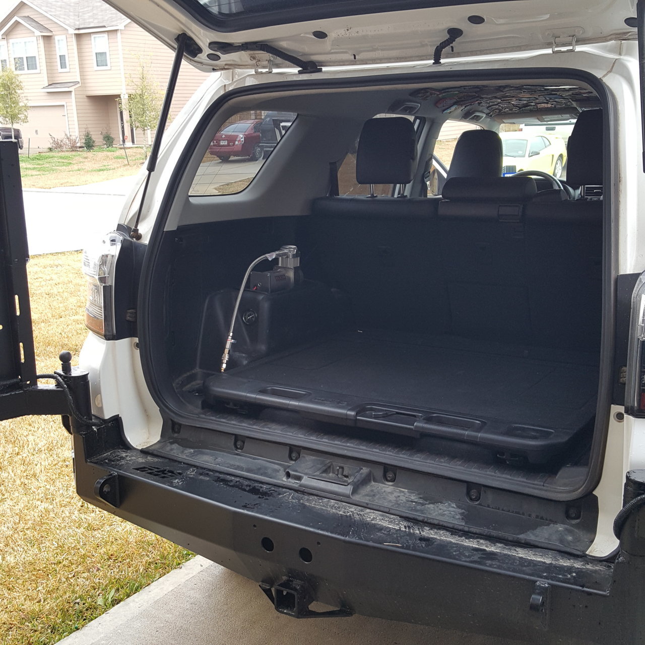

    OBA is mostly done. The tank and compressor are operational, just need to plumb an air line somewhere to some quick connects on the bumpers. For now air can be used at the quick connect near the compressor on the line going to the tank.

    The relay box/pressure switch that is attached to the tank has a trigger wire that I ran to the Switchpro. The power for the relay box is ran to the blue sea fuse block on the powertray, and the compressor power runs to the relay box on the tank. I really like this setup... way better than my ARB twin, but I don't have an air tank plumbed yet on the truck. This kit was 350 or so I think compared to my twin that cost 450 on a group buy for just the compressor. Granted the twin is faster, the Viair is no slouch.
