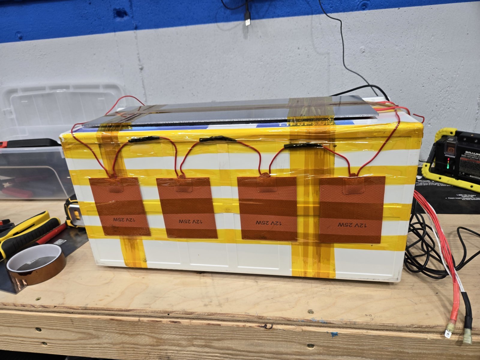

    Got some more things done on the truck and camper the last few weeks. Camper battery has more heating capacity and insulation, and all of the electronics are hooked back up. Fridge is back in place and she's ready for camp. My diesel heater fired right up, too!

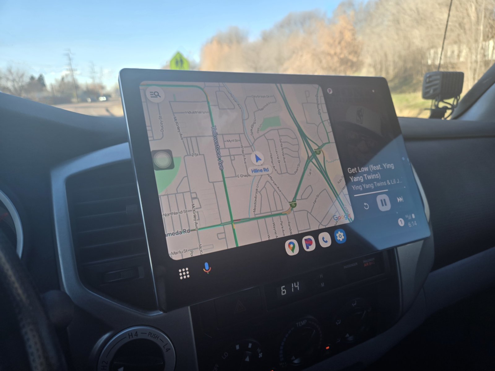

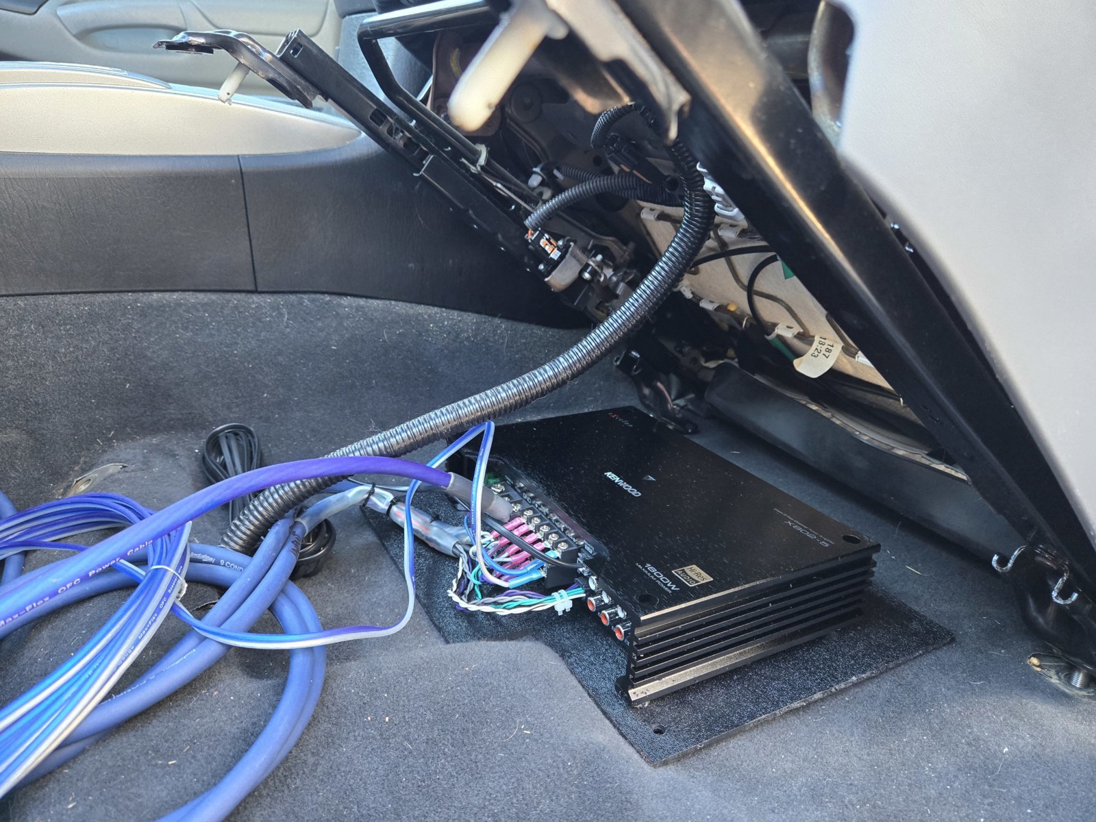

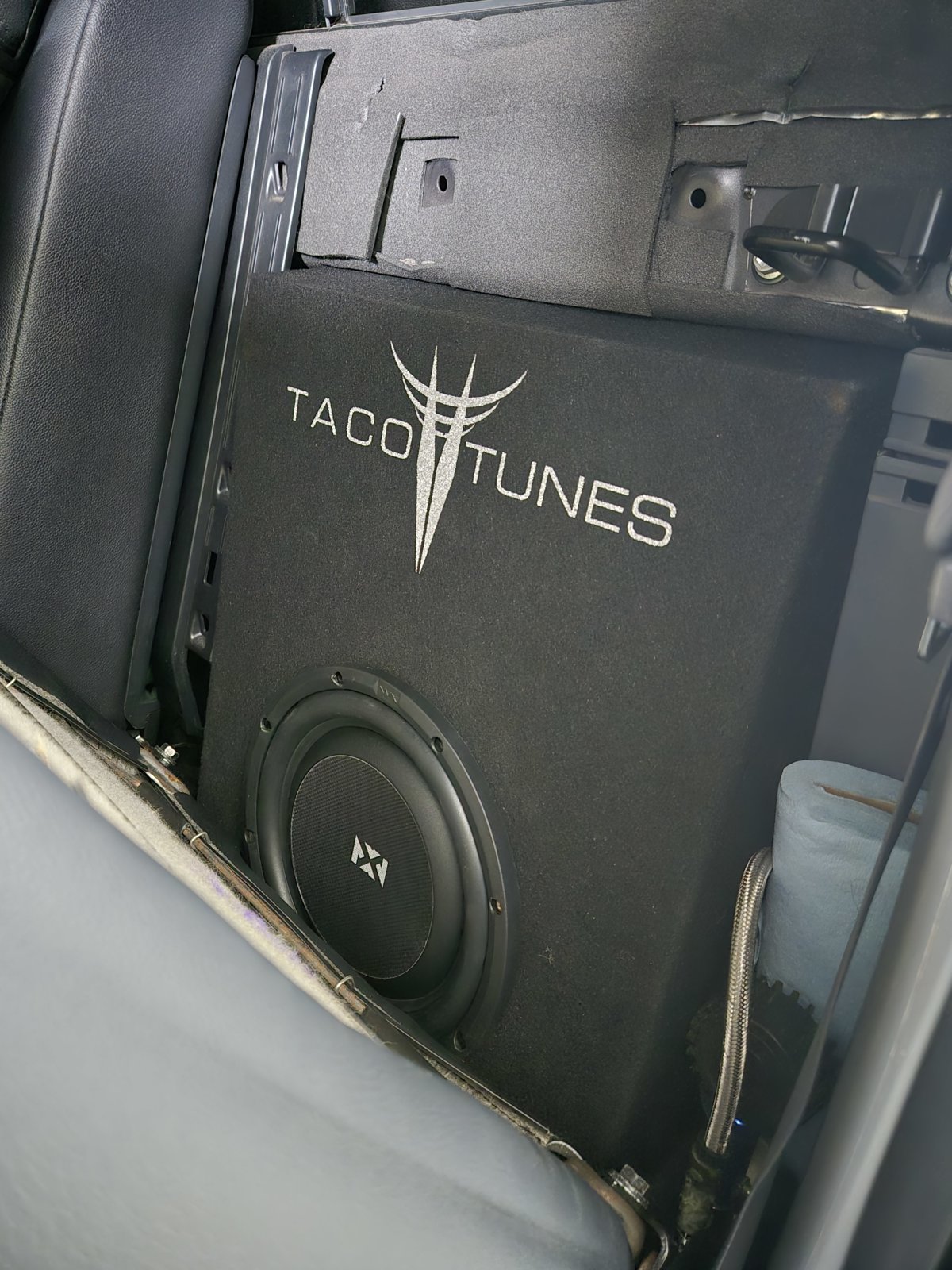

    I also dialed in my alignment a bit better and then did a "definitely not a mid-life crisis" mod inside the truck. I figured I added a ton of sound deadening some years back, might as well make good use of it.
    Not pictured are the speaker upgrades. NVX components in the front doors, 2-ways in the back doors. After tuning the amp it's a significant upgrade. Kinda mad at myself for waiting so long to ditch the stock audio system. Another slight mod I made that took me way too long to get to was the Honda Odyssey windshield sprayer nozzle swap. Such a better spray pattern to clean off the windshield! Highly recommend both of these upgrades if you're not satisfied with what Toyota gave us.

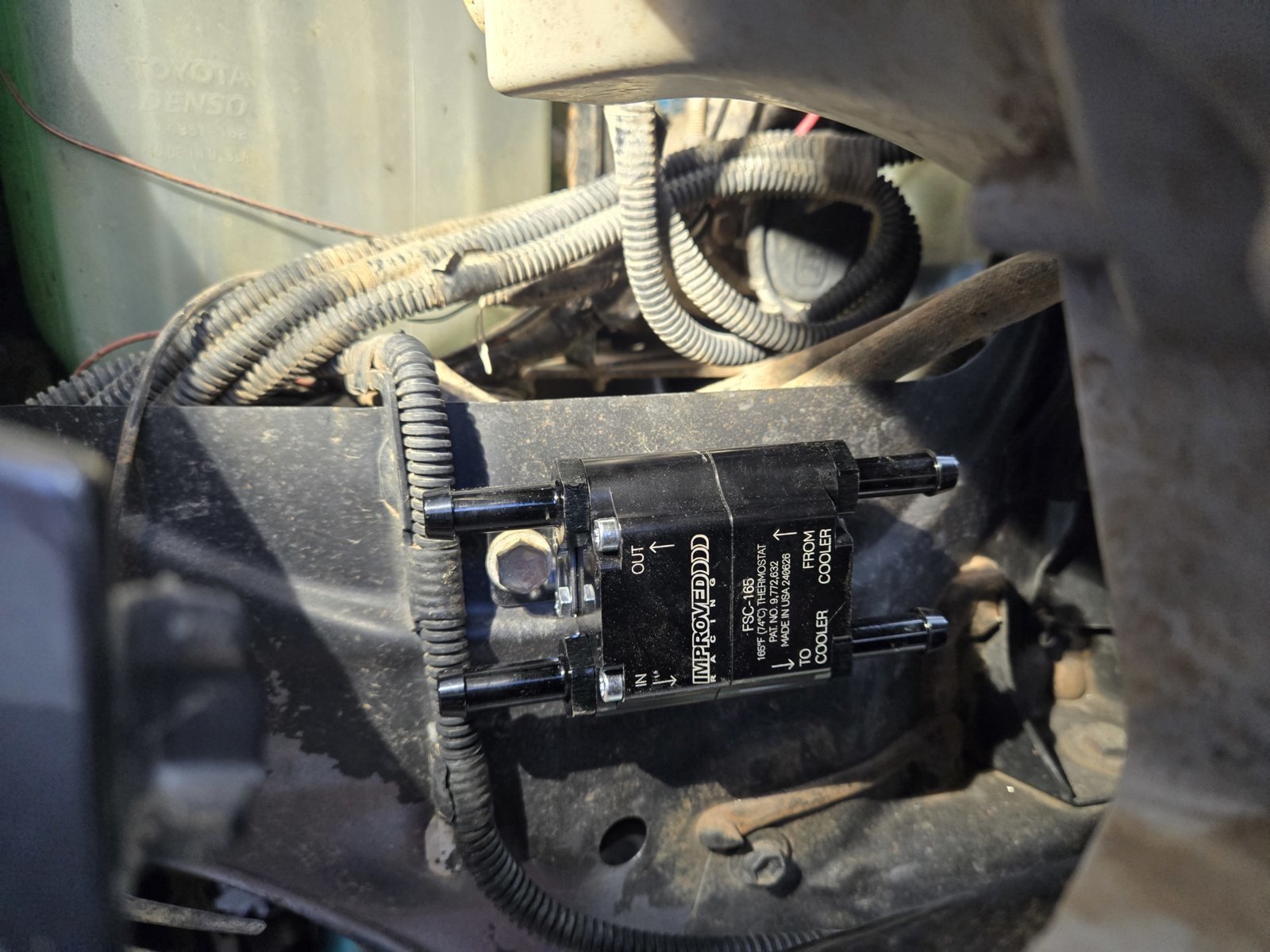

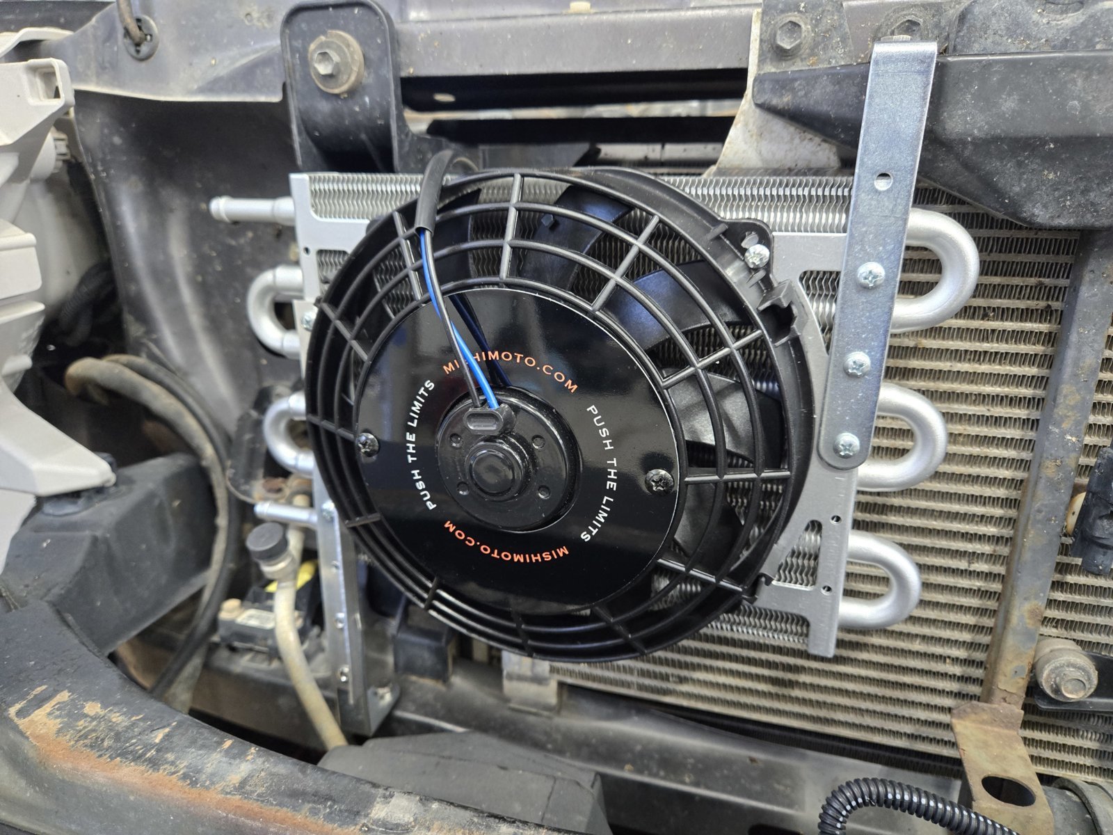

    Looooong overdue additional trans cooler is ready to put in work in the mountains. Since we've got actual winter up here, I also added a bypass behind the passenger headlight.
    I was worried it would be a pain in the ass to find a spot to mount these guys, but it wasn't bad at all. A few rivnuts and some scrap aluminum did the trick.
    ETA, I also wired in a 180°F thermal switch for the fan. Didn't get a picture of that, but if anyone out there is curious I can share more details of the setup.
