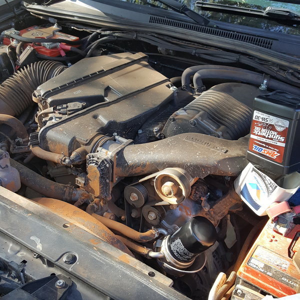

    Gave the go box some fresh libations today. That Jambo dirt is still EVERYWHERE! I did wash up under the hood once I got it all buttoned back up.

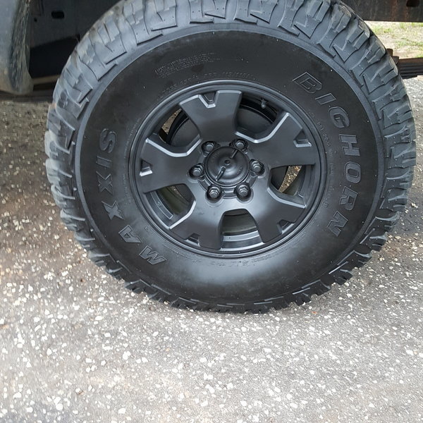

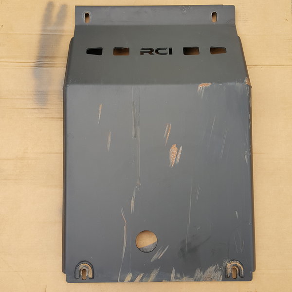

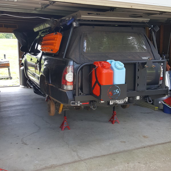

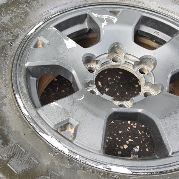

    More maintenance today, and some rock rash cover-ups.
    Put new gear beer in the diffs and t-case, rotated my tires, cleaned the wheels and threw on a fresh coat of derp on them because wheelin', and then painted my skids' battle scars... ya know, because wheelin'.
    I also took the opportunity to take a wire brush to my rear drums and finish them in VHT engine enamel. Looks much better!
    I'd been experiencing a clunking in the front end when turning right. I thought I may be replacing a ball joint but it turns out my UCA bolt was loose on the drivers side. :eek:
    ... I've still good Jambo dirt to clean off. It's never ending!!!

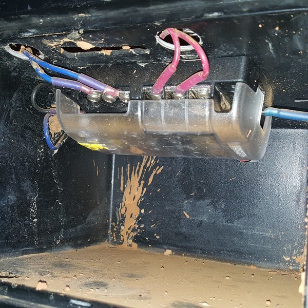

    Thanks man! I like it so far, no problems yet. I think I'll seal up the holes just in case, but the fuses and circuit connections are pretty well covered.
