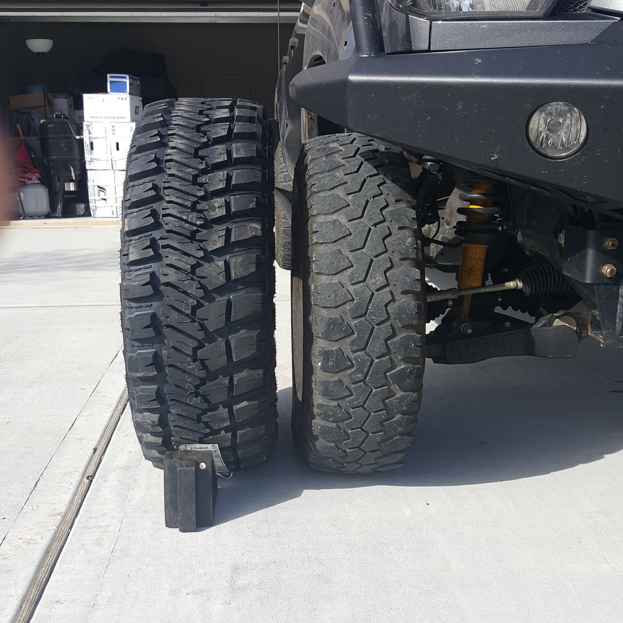

    going from bald ass 255/85r16s (Maxxis Bighorn 762 MTs)
    to 35/12.5r17 MT/Rs
