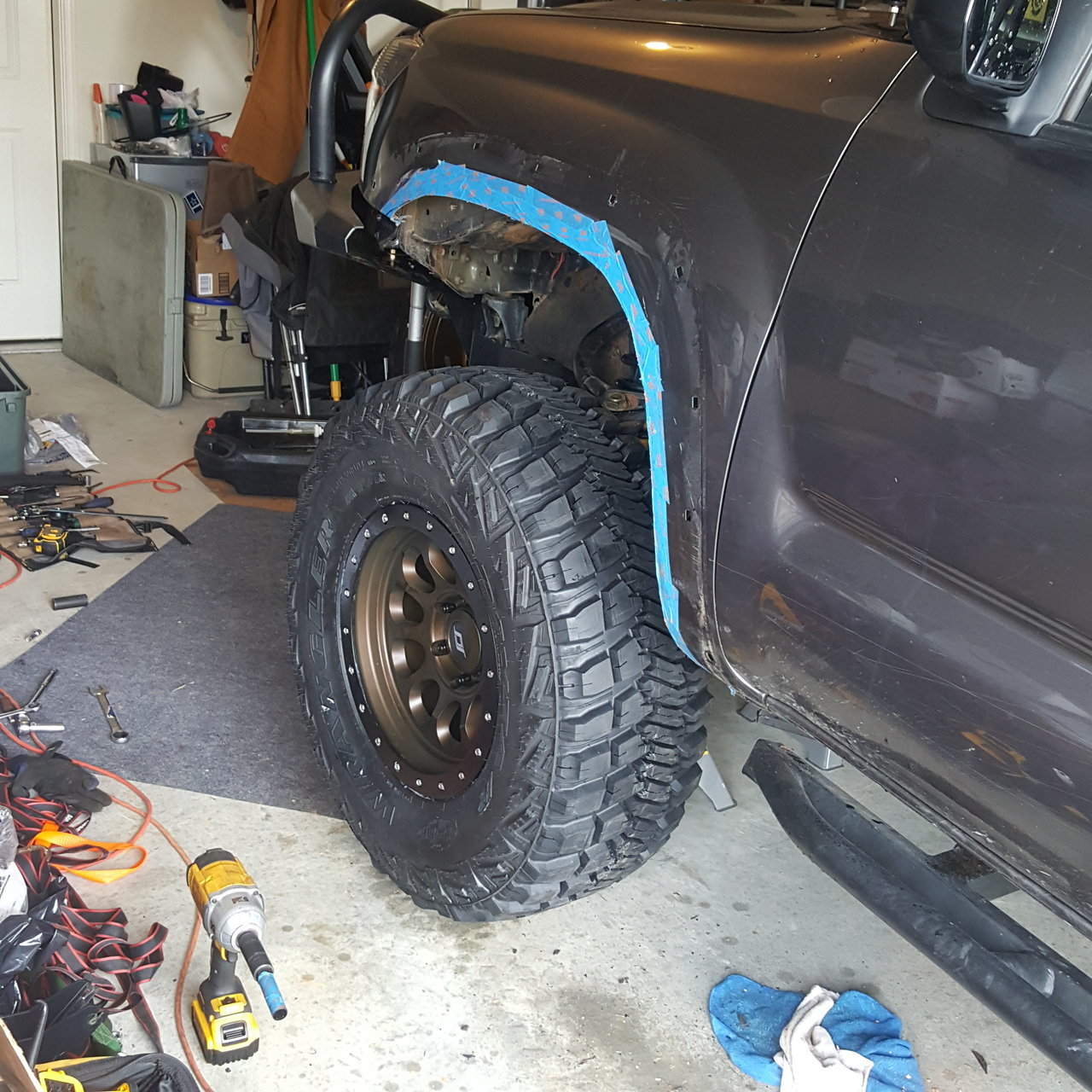

    We've got plans tonight, so I will chop the rear bumper and fenders tomorrow... and I'll go into detail on what I did to fit these up front. Whew! That was fun :)
    :sawzall:
    The more I see these wheels on my truck, the more I LOVE the matte bronze finish.
    I'm glad I already ordered flares... these sumbiches need 'em

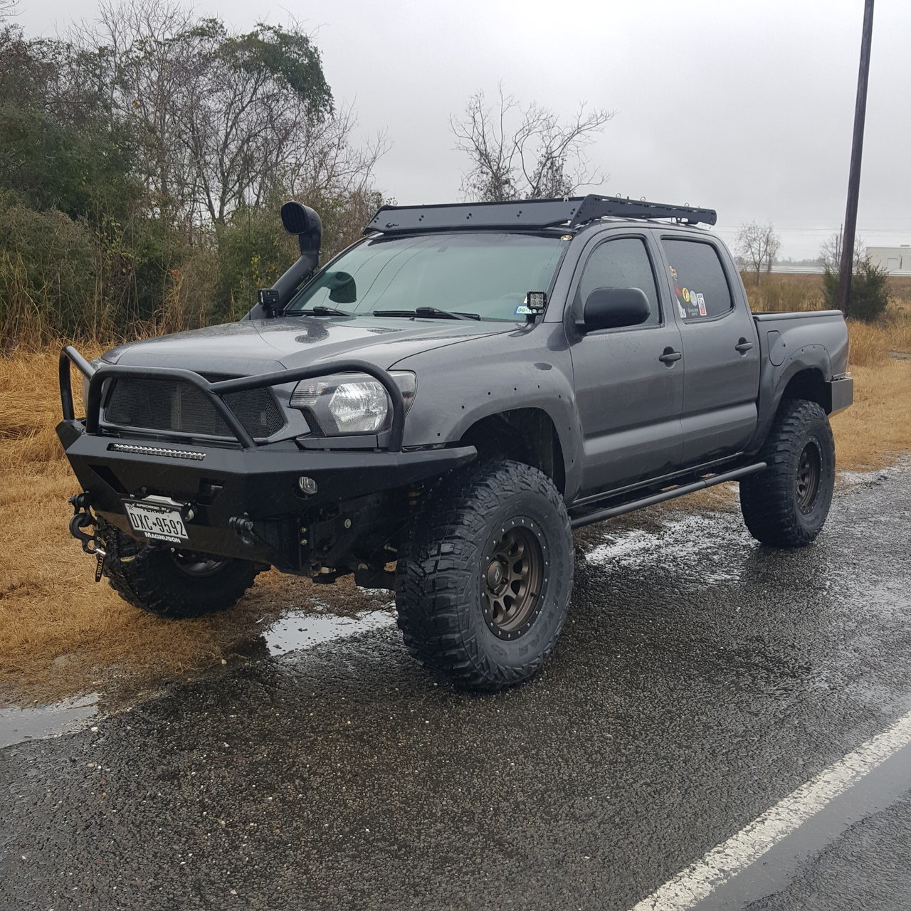

    I found a pic of a truck same gen, color and wheel setup I now have that i ran as my desktop background for 2-3 months before committing to go with bronze wheels. I have no regrets but since getting mine I think the dark bronze on the scs wheels might be even better!

    How much did you cut the fenders so far?

    Ha! I don't think I'll be selling the pack rack anytime soon. I tore off a couple of the mounting clip tabs on two of the flares :-/ I'll give them to you if you wanna make them work still.
    Thanks Steven! I've only cut 1.5" out of the front so far. I have a 1" body lift and I've seen cut numbers anywhere from 2-3"... I figure I'd shoot for 2.5" of fender clearance over stock.
    I removed the front coils and allowed the A arms to fully droop and stuff onto the bumps as far as I could get them to with my jack and then turned the wheel to check clearance. I had to beat the hell out of the firewall to fit the 12.5" wide sumbitches in there as well as do a little bit of grinding on the frame and cab mount chop, but they fit pretty well. I'll wind up with a tiny bit of frame rub on the drivers side while fully stuffed at full lock and just begin to touch the passenger upper arm when fully dropped at full lock. All in all I'm very happy with what I've got so far for clearance without running a huge offset wheel or spacers. These tires poke out really damn far, but I came from skinnies, so it's a drastic change.
    Still need to cut up the rear tough :rofl:
