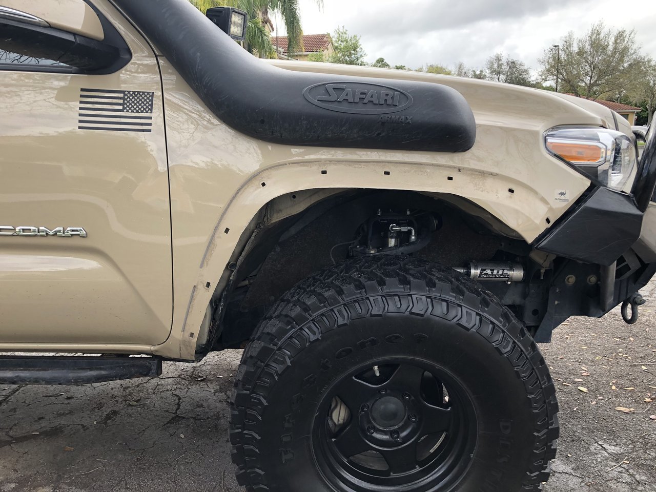

    Test fit 37’s today. Trimming the fenders to accommodate. Gotta finish up tomorrow and shave the bumper a bit.

    37’s for real? Here I am stressing over 35’s, and you’ve already moved on. LOL!

    LMAO, yup. Been the plan all along. I will keep the 37's on when I do the SAS hopefully this coming winter until they are worn out and then go to 40's

    35’s are going on mine soon as these 33’s are worn out, I don’t think it’s that big of a deal like most make it seem. Hell I have 285/75/16s on stock suspension, and they fit just fine.
    Can’t wait to see how the 37s look.

    These 3rd gens have a ton of room in the wheel well. Fitting 35's on my 2nd gen was a bitch!
