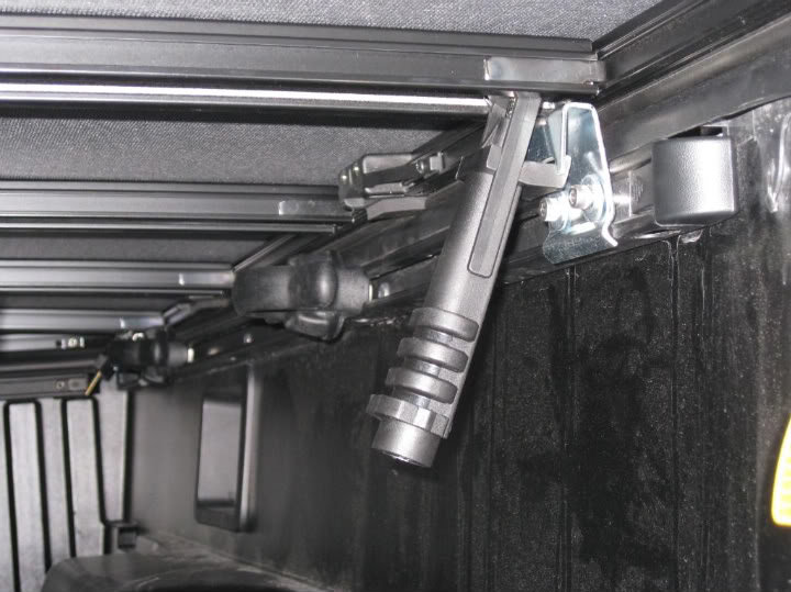

    I know this is not where i start at.. but i started taking pics thinking it would be quick and easy and wanted to do a how to.. i guess now its gonna How not to!
    Brackets dont line up in the front.[​IMG]
    And the tightining nobs dont have anywhere to connect bc the top part that is connected to the actual tonneau cover doesnt slid in or out

    A few bolts are different.
    I dont see where the problem is. The metal brackets in the rails move to line things up. the clamps that you tighten the T nut up on to move in and out to compensate also. The threaded bolts are not strait up and down on my extang. but then again i dont use the metal brackets in the rails, I just tighten the top with the clamps in the rails.
    Elaborate a little on the exact trouble areas if the above didnhelp at all.

    The problem I am having is that the tightning brackets at the front are at an angle kinda like "/" instead of up and down like "l" so the clip and the bottom wont reach the metal part to grab ahold
    If you look at it here you can see that its not parallel with the metal bracket its at an angle.. and the part that connects to the tonneau cover doenst slide out its stationary..
    gopnna try to tighten the clip to jsut the bed rail instead of the the brackett

    thats how my solid fold clamps on. but the hardware may still be a little "/" instead of " l " strait up and down

    Angle doesnt seem right on this

    Mine are on an angle just like yours. No problems with mine though. I'll try and take pics. Just gotta figure out how to upload em.

    Yeah it doesn't look good. Take everything off and start over. My clamps are all on a bit of an angle, but the cover is straight on and seals well. Put the cover on the bed, unfolded, and line it up right. Fold it up to the cab and install the first set of brackets in line with the tighteners. Put the front ones on first, not too tight and unfold. Make sure it is still in line, then fold it up one fold, and line up the rear brackets with the clamps. Put it on again and clamp it up, making sure it is still lined up. Go back and tighten everything up front again, all the way so that it has a good tight seal. Then clamp the back clamps on again. You can use a socket to tighten the rear clamps up a bit. Will post pics asap.

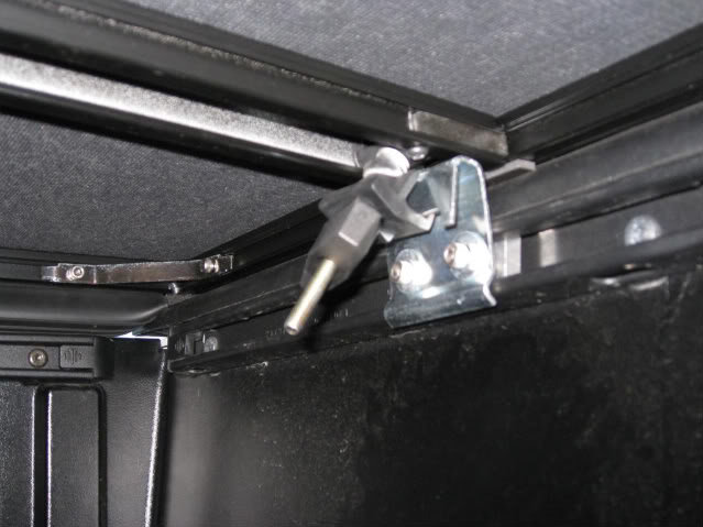

    cover006_952677121799ed4c7bc921fd1faaec5ef9e4cef2.jpgcover003_a12498e36ea726eb8fea1c47a897f90d8a4aacce.jpg
    The little buldges are where the cover folds. Not exactly pretty but I like the function

    Just a thought, since it would seem to me by the pictures that if it where completely vertical you wouldn't have clearence to turn the "t-handle". I sell aftermarket products and see ridiculous things like this all the time. If the cover is tight and square I wouldn't worry about. Sometimes I wonder who engineers this stuff. Possibly wrong on this but you may find out it is the way they intended.
