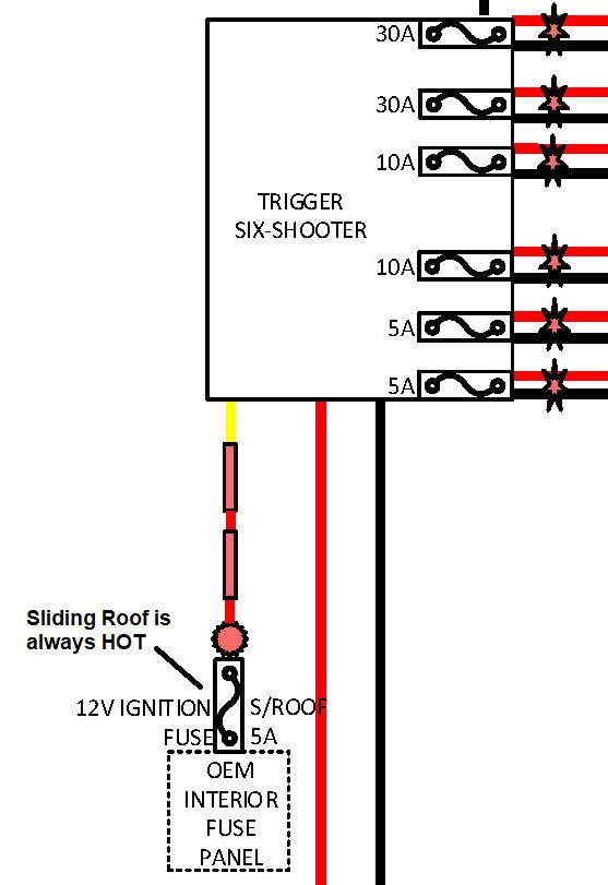

    • Three input wires
      • Battery positive with 100 amp in-line fuse
      • Ground
      • Switched positive that can be connected to an ignition source or switch

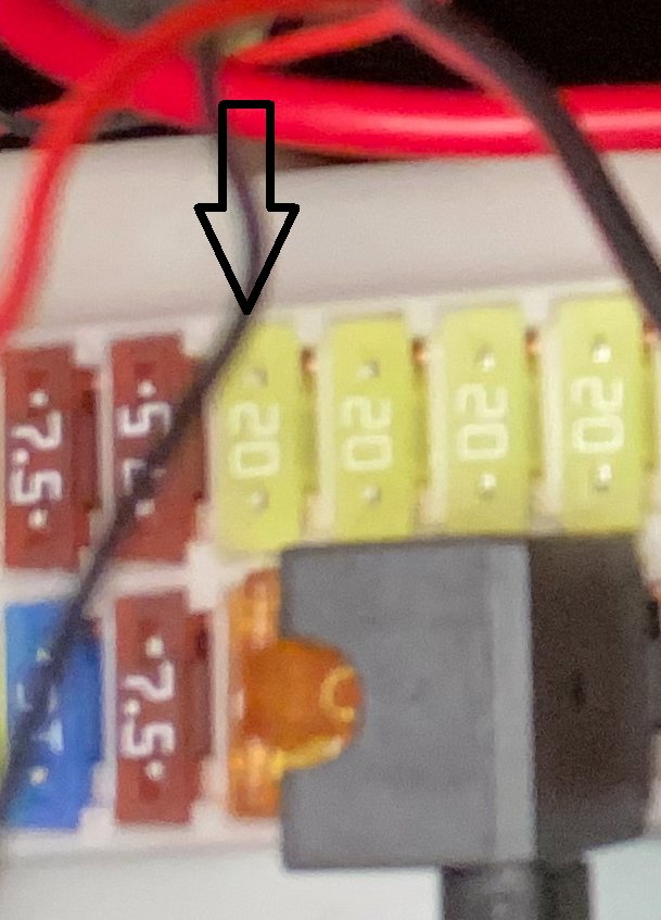

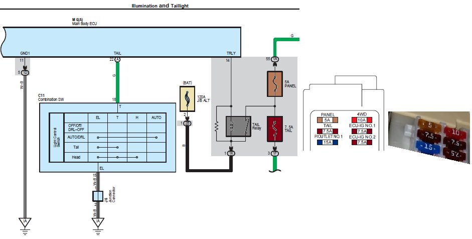

    Use a quick splice connector to connect the white harness wire to the green cargo lamp wire with a quick splice connector and wrap in electrical tape. This will make it so that the switch backlight comes on with the rest of your interior lights when you turn the headlights on.

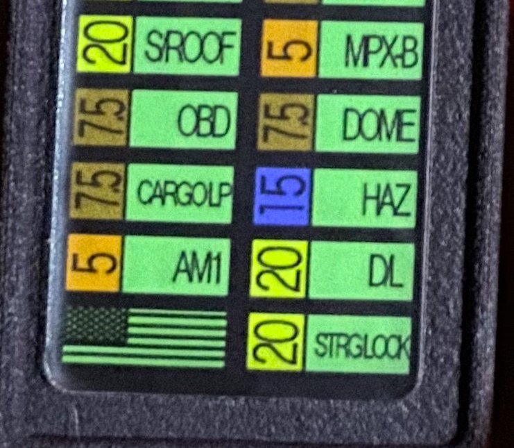

    Remove the fuse panel cover, I definitely recommend the MESO option which allows add-a-circuits to be used while having the cover installed
    Use a butt connector to connect the red harness wire to and add-a-circuit with a 5A fuse and install in the WIPER location

    Controller Switched Positive Options
    • It's recommended to wire the yellow switched positive wire to a switched ignition or to a wired on/off switch when installing the Trigger
      • Switched ignition sources (can only be used when the truck is on)
        • Engine bay fuse panel
          • INJ fuse with an add-a-circuit
        • Cab fuse panel
          • S/ROOF fuse with an add-a-circuit
            • I chose to use the S/ROOF fuse in the cab fuse panel
