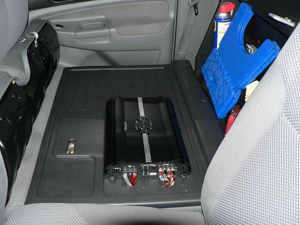

    Here's a picture of my TRD rear seat's pattern (maybe someone can add a pick of their SR5 seat):
